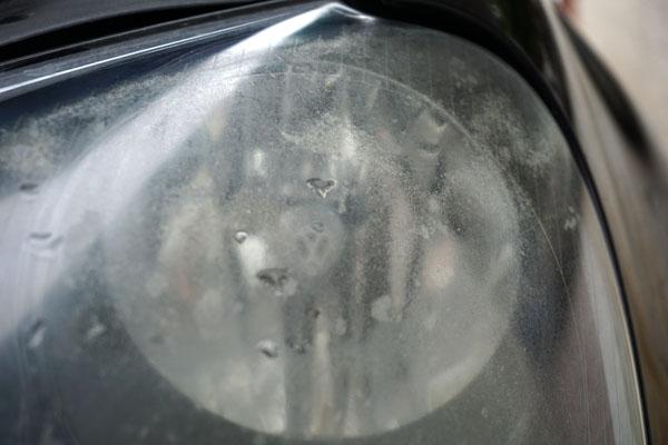

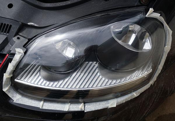

« Reply #13 on: July 11, 2014, 01:12:52 pm »
It all depends on how bad they are....Did mine the other day after reading Bodger00's guide
http://www.mk5golfgti.co.uk/forum/index.php/topic,26433.msg341751.html#msg341751
I started at 800 and went upto 2500 then a few rubs with meguiars plastX....
Before
After 2500grit
After about 4/5 applications of plastx
As you can see I was too lazy to remove the headlights, It would have been much easier to sand if I had!
I did it all by hand and spent about 1.5 hours per lamp. Its not perfect but I think its a lot better than it was!
