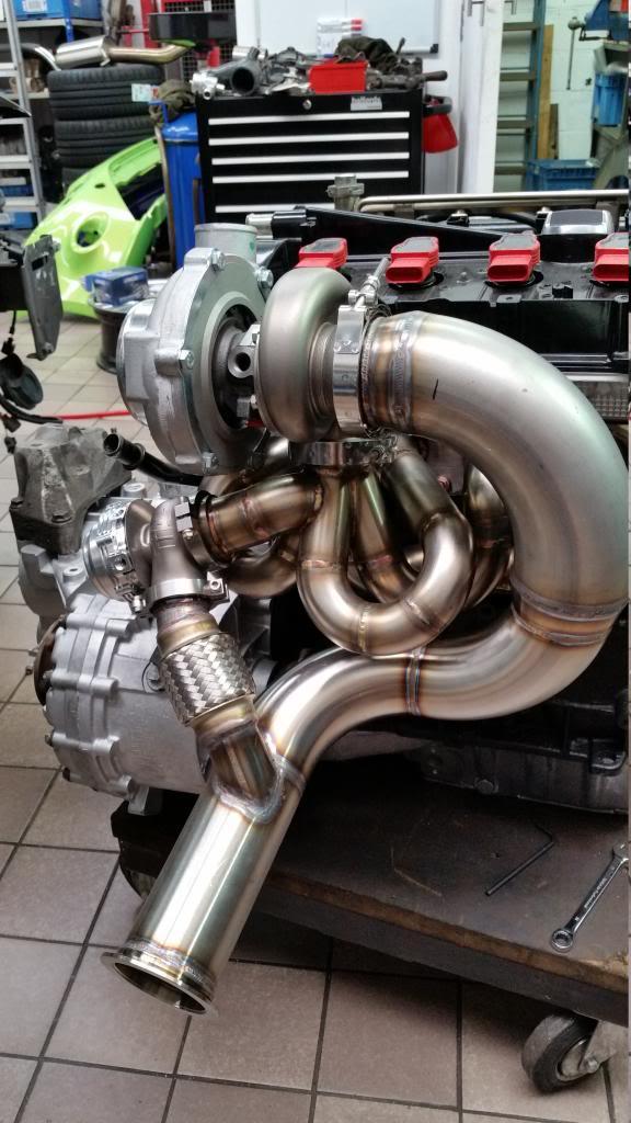

I still get involved in a few higher bhp builds.  Currently doing two 2.0 stroker builds with ported large port heads.  Both looking to run over 500bhp.  I do off the shelf 1.8T big turbo kits.
One of the builds:
Follow AKS tuning on Facebook

225bhp models were all small port.  Only the ADR, AEB and AGU were large port.  None of them really have a strong bottom end.  Rods love to bend all over the place.
One of the builds:
Ahh my bad. Thanks for sorting the facts :happy2:

One of the builds:
P*rn... If you weren't an admin I'd report it.
