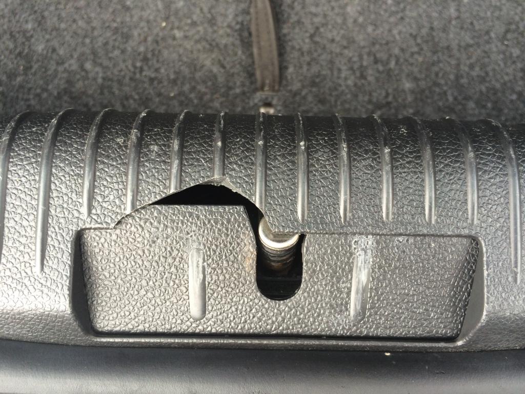

When I purchased my car I opened the boot to find a piece of plastic had been cracked off.
I figured I could fix it myself down the line but I think I've made too much work for myself.
Anybody have any suggestions on repair?
Or does anyone have a part number for the entire plastic trim so as I could replace it. I think a trip to the scrap yard is in order!

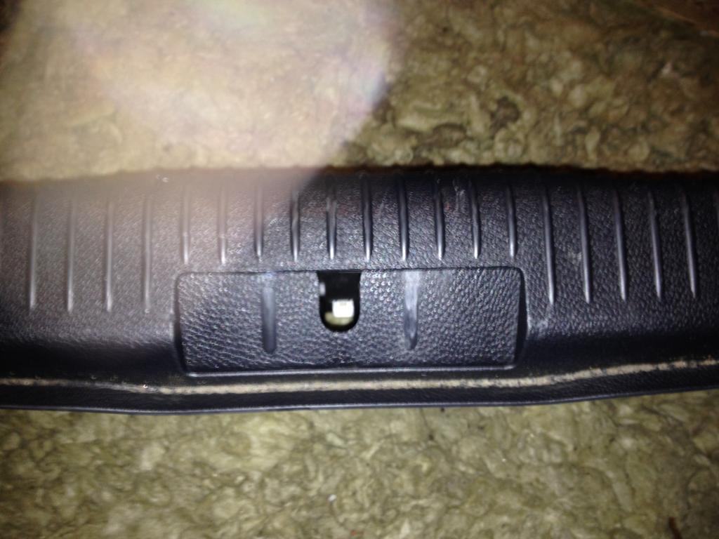

Mine was the same as that took ages to find a replacement got one about a month ago from here http://www.ebay.co.uk/sch/spares4yourcar/m.html?_nkw=&_armrs=1&_ipg=&_from= On eBay he's not selling any now but had 3-4 a few weeks back so may be worth a message
when I changed mine the broken piece was inside so I glued it back on if your near where I live you can have it if you donate a couple of quid to the forum but wont post sorry
i'll get the part number later when I go in attic Part number : 1K6 863 459 doesn't seem to be a colour letter on it maybe they are all grey ?
I live NP12 0QU near blackwood south wales  :happy2:
Rob
pics if anyone want to take me up on the offer

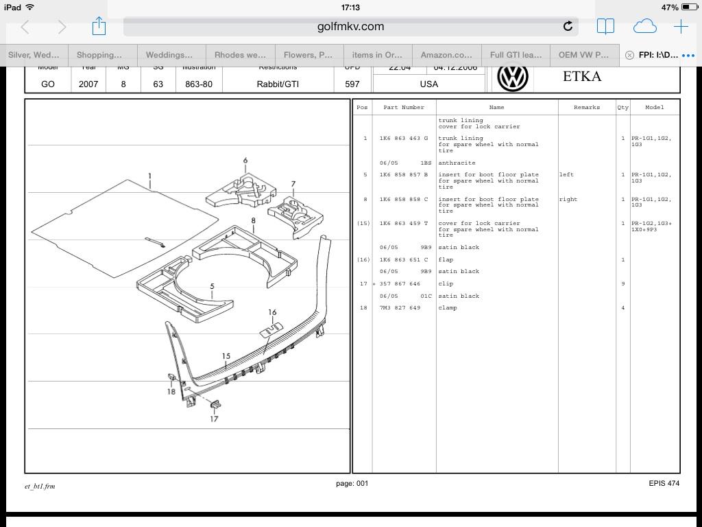

Hope this helps. Mines done exactly the same as yours

£32 all inc from my local vw dealer, changed mine last week  :happy2:
That's good value! Does it come off handy enough?
Offline vwrascal
  • Posts: 1230
Re: Boot Plastic Snapped - Help!
« Reply #13 on: July 14, 2014, 07:54:34 pm »
No screws, just pulls off. Give it a good tug  :laugh:
