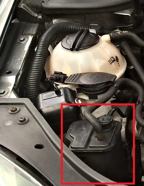

I never installed one but I thought I had one... I've circled what I thought is the catch can on the photo

No that is your charcoal canster which is fitted as stock its for emissions

^ pikey is right!
That canister doesn't need emptying.

Ah much appreciated. I misread something along the lines there!
Just to confuse matters  :laugh:  what's the black box to the top left of the canister next to the washer fluid?

The flux capacitor.
