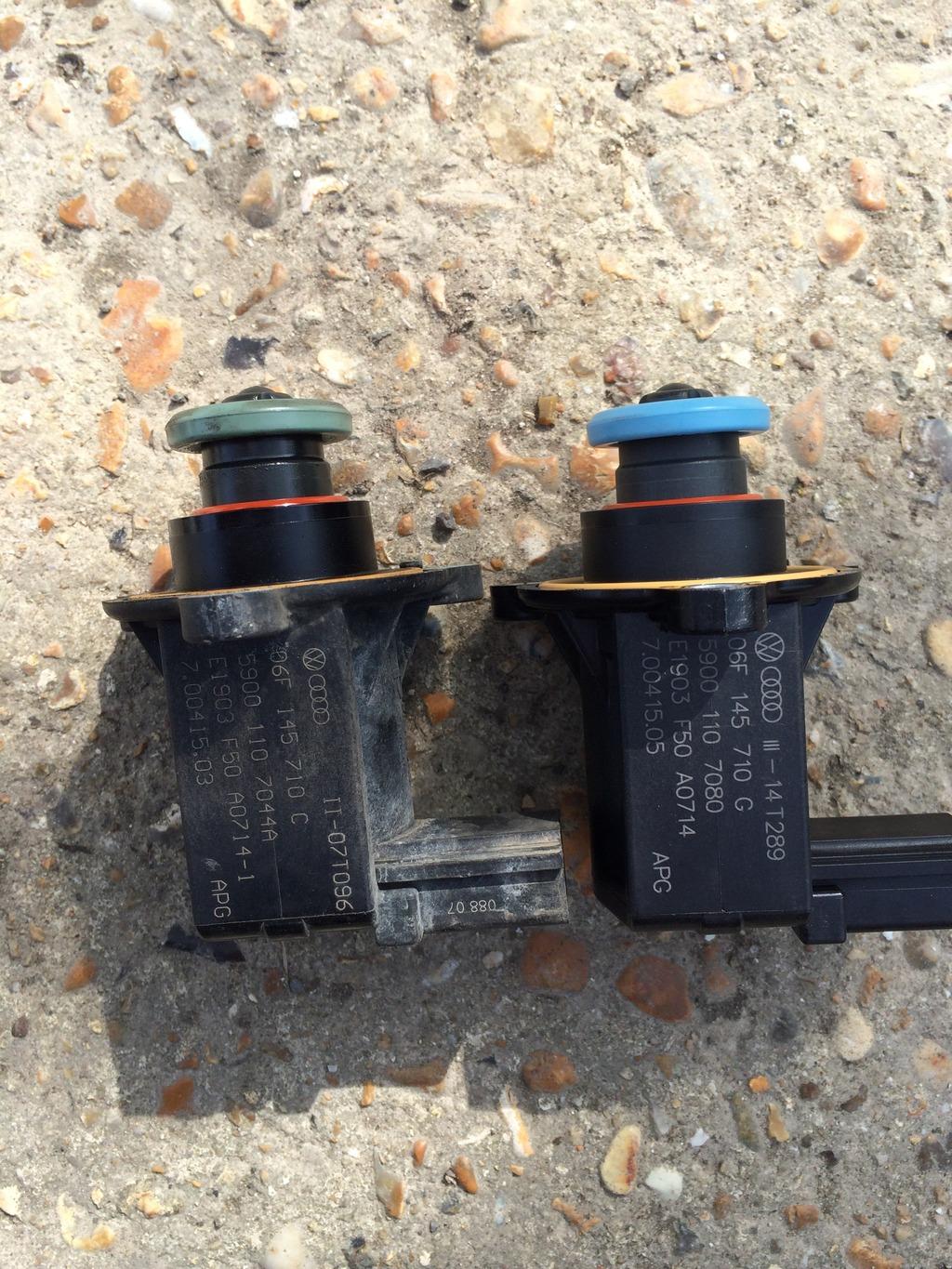

A quick update on this. I bought the REV D as I was told by a dealer that my REV G might be leaking.
Unfortunately he lied and VW wouldn't refund my money so I'm stuck with an extra DV.
I have tried both the REV D and REV G but I have to say on a stock GTI I'm not noticing much of a difference. If I had the option I'd probably go for a REV G.
For those that don't know, D is a piston and a mechanical top and G is a rubber diaphragm that will seal better but can rip.

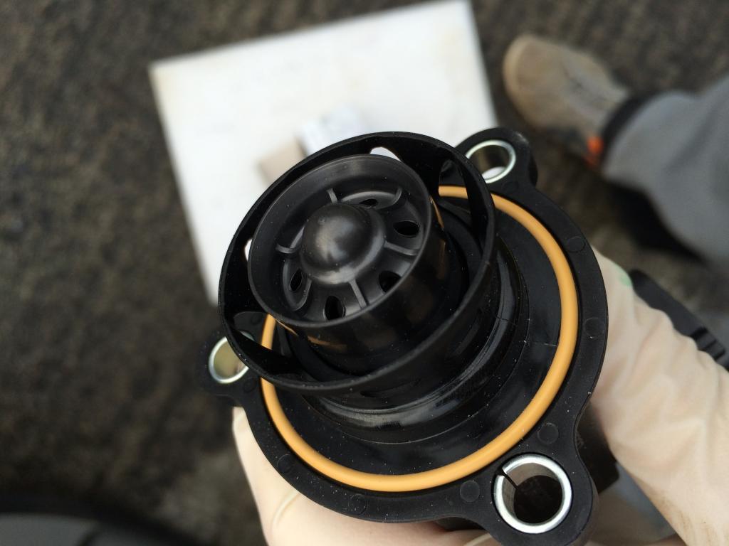

Here's my new REV D

Just thought id add my input, just bought a rev g as i thought my current dv had possibly failed, turns out that a rev c and g are from what i can see the same. No noticable difference so abit annoyed but hay ho.

I thought that the rubber on the Rev G was supposed to be stronger and no so prone to ripping. They say that the Rev D (piston design) doesn't seal as well and leaks boost pressure.

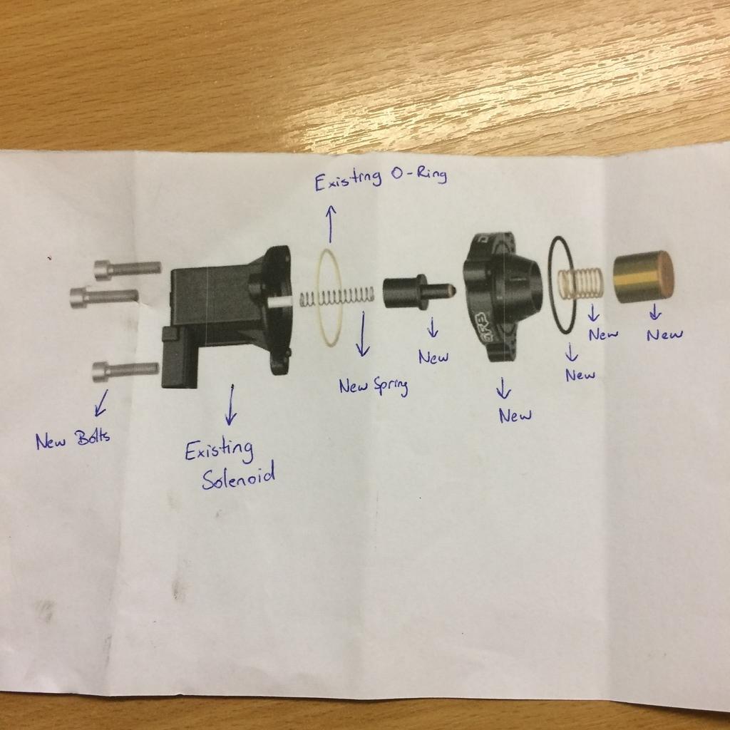

Update 29/09/2016 - Installation of GFB DV+
Step 1 - Fit GFB DV+ to existing solenoid. Two second job but don't forget to use 5W-30 to oil up the parts when assembling!
Step 2 - Photograph final assembled unit so people know you mean business

Aaah... I forgot you posted a pic of it haha ... I should of re read the thread  :signLOL:
... but still.... that rev d you put in looks brand new!    :thinking:
