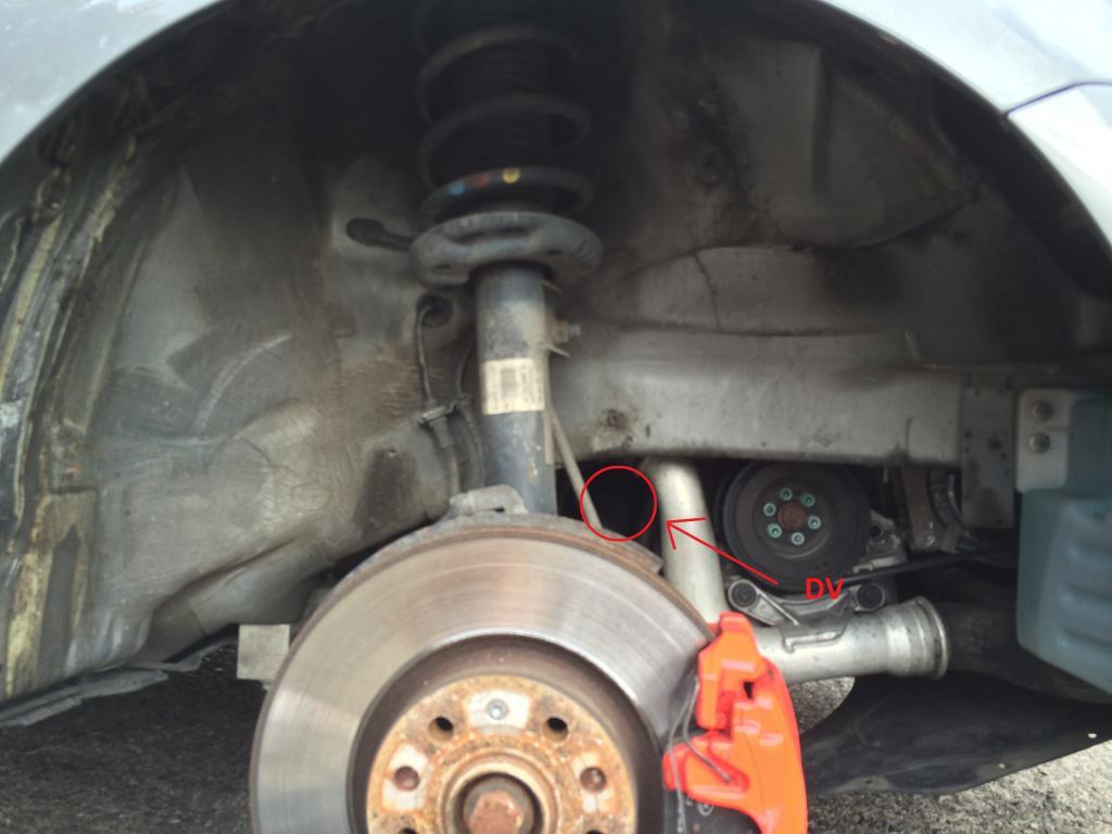

Remove the wheel and the plastic arch mud guards. There’s 2 of them and the one on the right hand side is also screwed onto the skid plate so you need to remove all of the screws at the front too.

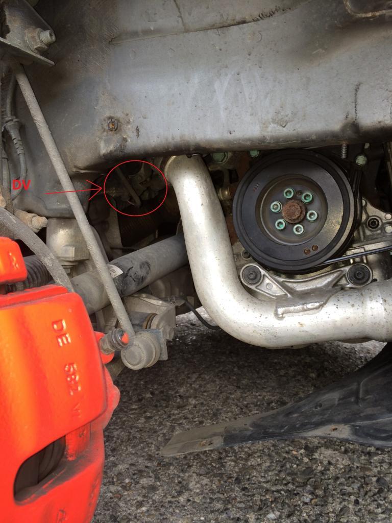

The DV is located just inside the only bit of free space you can get to and I’ve circled it in the photos below.
A good tip is to get a small torch and tape it to one of the pipes so it’s not in your way but it’s providing you with better lighting. Will save time in the long run.

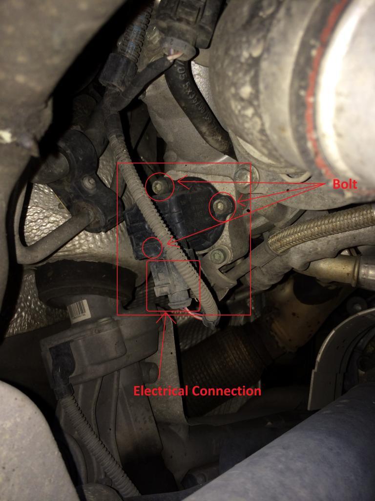

Start by removing the electrical connection. Prize clip up with flathead screwdriver and remove. Please do this safely or you’ll tear the wires. Now cable tie it to something higher so it’s not in your way.
The 3 number bolts are held in place tight enough with threadlock – a glue put around bolts to keep them coming free from vibration so they require a bit more force to remove than a normal bolt would.
As long as you have the right tools all 3 bolts can be removed but you can’t tackle this with a  bit set and a screwdriver. You really need the extension pieces, right angle adapter etc. for your socket set. The area is also very tight so you’re going to need the socket set to be quite small.

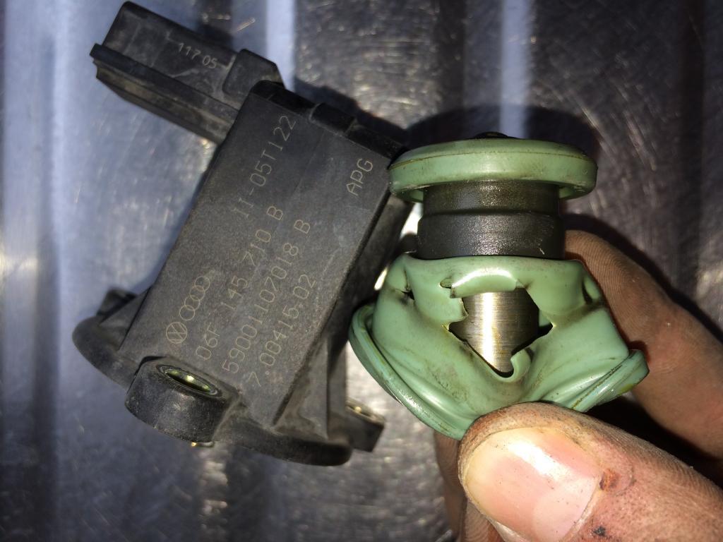

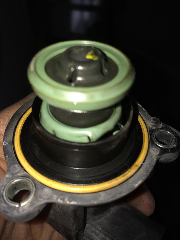

When you get the DV off inspect the rubber diaphragm for tears and what revision it might be. As you can see, mine was torn badly and a revision B.
I replaced mine with a revision G. For the reinstallation start with the bolt on the top right corner. You’re going to need some fresh threadlock here on the bolts to keep them from coming out. Add a small amount and hold the DV in place with the first bolt. Don’t fully tighten until you get the other 2 bolts in.
Now fully tighten all 3 bolts and reconnect.
