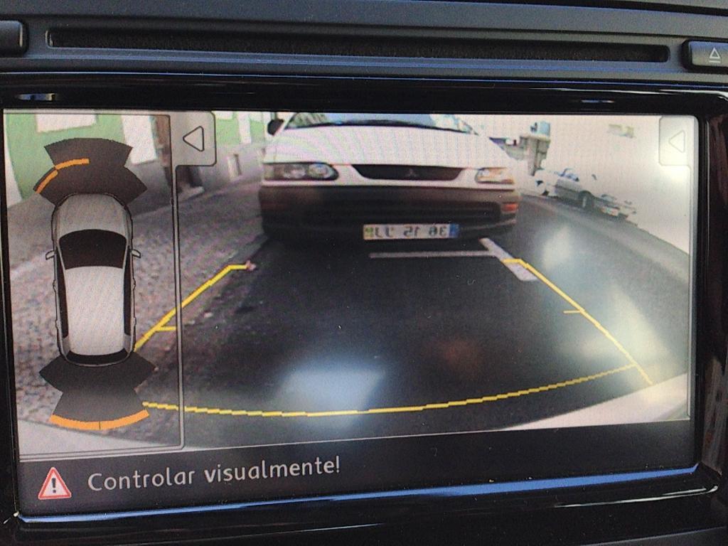

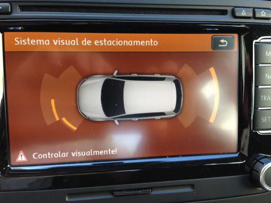

Nice specs! Can you post some pictures of OPS?
Finally I got time to make the pictures you've asked for. I hope they please you.
Outside placement:
How they look on the RNS-510 screen:

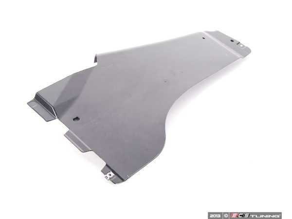

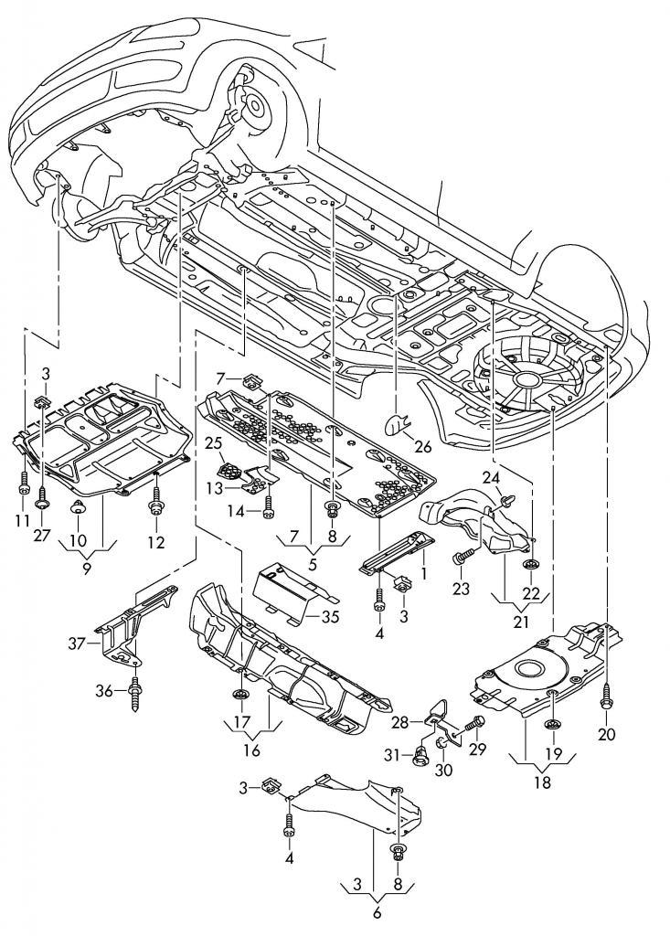

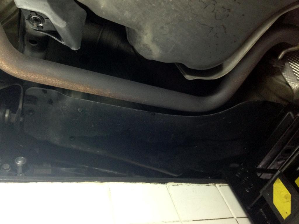

I also fitted this lining part on the left rear of my Golf. I don't know why it doesn't come as standard. Do your Golfs have it? It's possible to install in either Mk5 and Mk6. Part number 1K0825206A:
It's #6 in this ETKA image:

I kept looking for more information on the underside lining part and got to this interesting topic: http://www.golfmkv.com/forums/showthread.php?t=163575.
You can see where that part I've gotten goes:
I have to check but most likely my Golf doesn't have this part from the Bluemotion as well: 1K0 501 713 D.
Getting the needed Bluemotion and Audi A3/TT 8J parts, the ideal underside lining would be something like this:

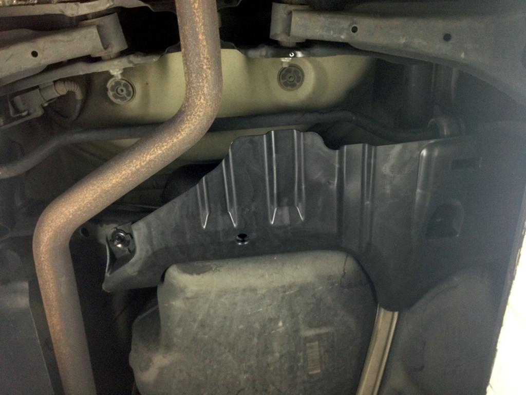

Pics to update the fitting of the Bluemotion's rear lining:
Parts list:
-Left rear lining (1K0825206A)
-Bolts x3 (N10354602)
-Rear axle cover (1K0501713D)
-Bracket (1K0501682)
-Bolt (N90548305)
-Nut (N90183802)
For older models you'll also need to fit this bolt (N91001101) to support the rear axle cover:
It should be something like this:
