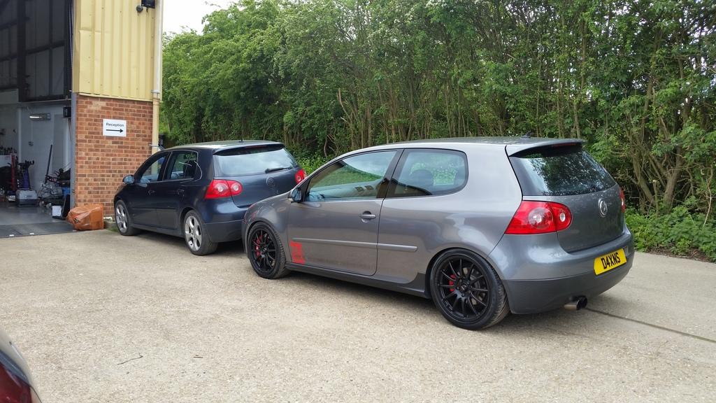

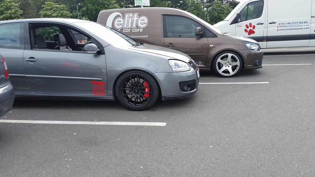

So the car is now with AKS.
I've bought some Chinese hi-flow discharge and inlet pipework.
Also some (road) vibratechnics engine and gearbox mounts will be going on
R-tech PCV delete
Braided clutch pipe
And if all goes well Polar FIS+

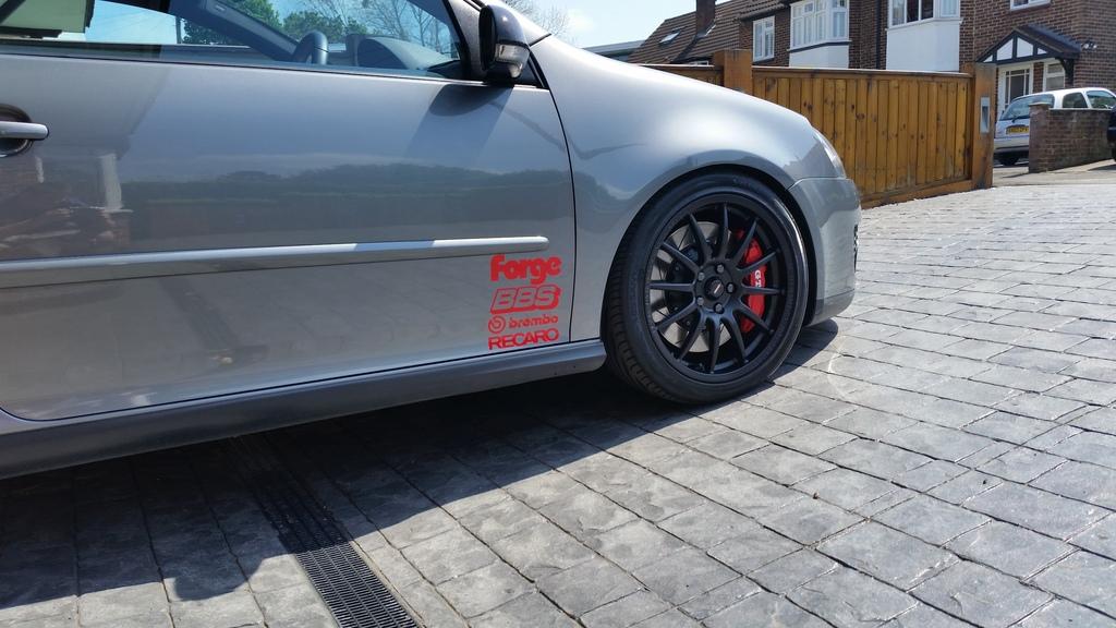

Yes you will notice that I have put stickers on my door which most if not all if you will hate  :signLOL:, I felt it was too boring and decided to try this to see if I like it and I'm still on two minds although I like it more than a thought I would actually. As a bonus they've added 50bhp  :jumping:

« Reply #626 on: May 14, 2016, 07:26:53 pm »
Look good man, but you need some proper Recaro seats now, so your sticker doesn't look so out of place. Just sayin'...
dansmith180
Re: Dans grey MK5 GTI - soon to be BWJ powered - car at AKS
« Reply #627 on: May 14, 2016, 07:51:40 pm »
 Stop bullying me  :slap:  :laugh:
Hopefully at some point mate
