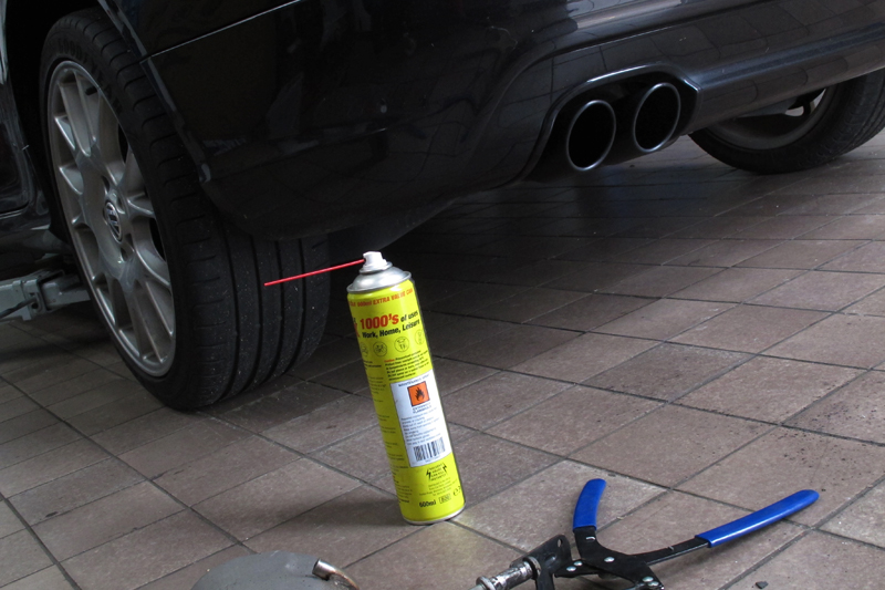

Re: Dirty black exhaust
« Reply #9 on: October 16, 2014, 12:02:20 pm »
Meh.....
 :signLOL:

« Reply #10 on: October 16, 2014, 11:04:56 pm »
Meh.....
 :signLOL:
 :signLOL:
That photo makes me want a replica set of those wheels even more :drool:
