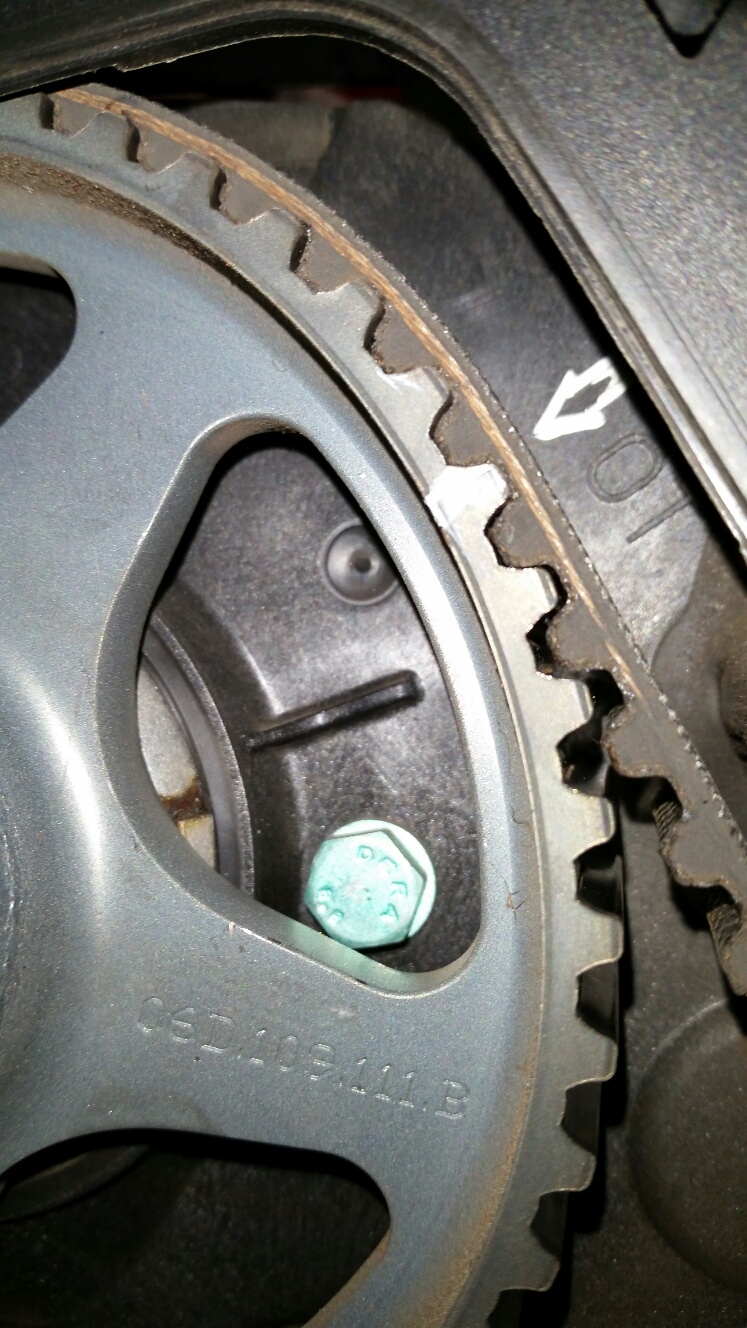

Aligned mark on camshaft sprocket with mark on toothed belt cover. Even this was a pita cant even see the mark on toothed belt cover so had to use my phone.

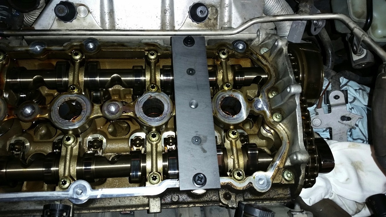

Must have been nearly on the money as cam locking tool slid into place.

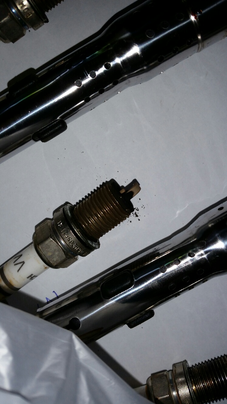

Firstly Plugs reuse or replace?

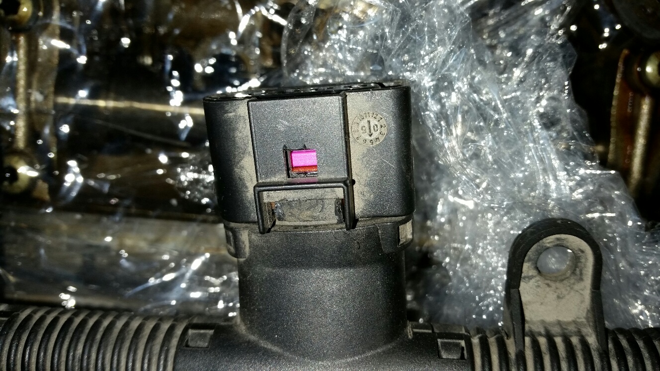

Coil pack clip can i change just the clip part? I broke it :sad1:

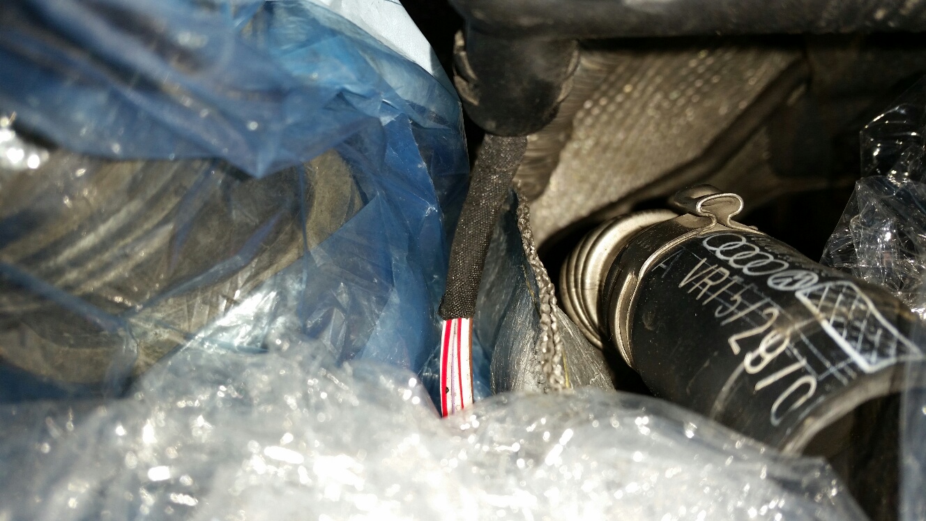

Protective cover on wire going to coil pack harness disintegrated!
Should i try and re-protect this?
