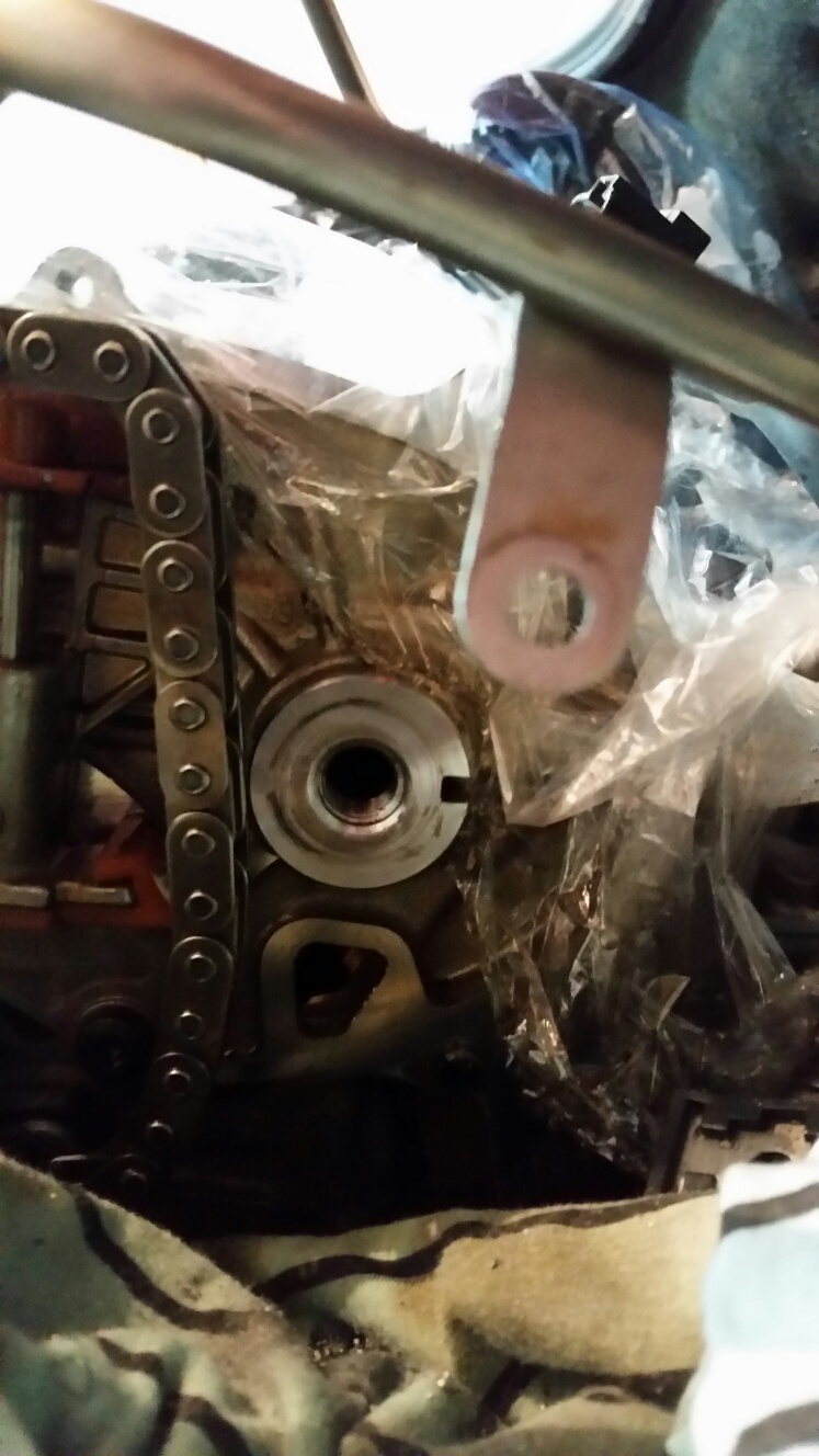

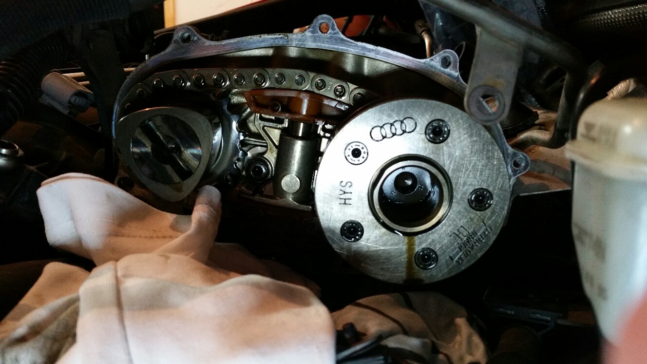

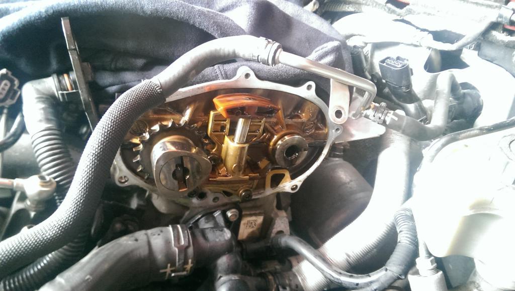

So some goodies arrived today.
Got the new adjustor, chain and tensioner installed sorry for the sh*t pic its been a long day.
Any way to check the timing before i start reasembly? @vRSAlex
I decided to change the coil pack clip while i was there expecting it to be easy. @bigmig95 is the pin u sent me for the coil clip? If so my pins are different see attached pic.
Thanks again guys for all your help.
Also any pointers for getting her put back together anything need a spot of oil etc?
