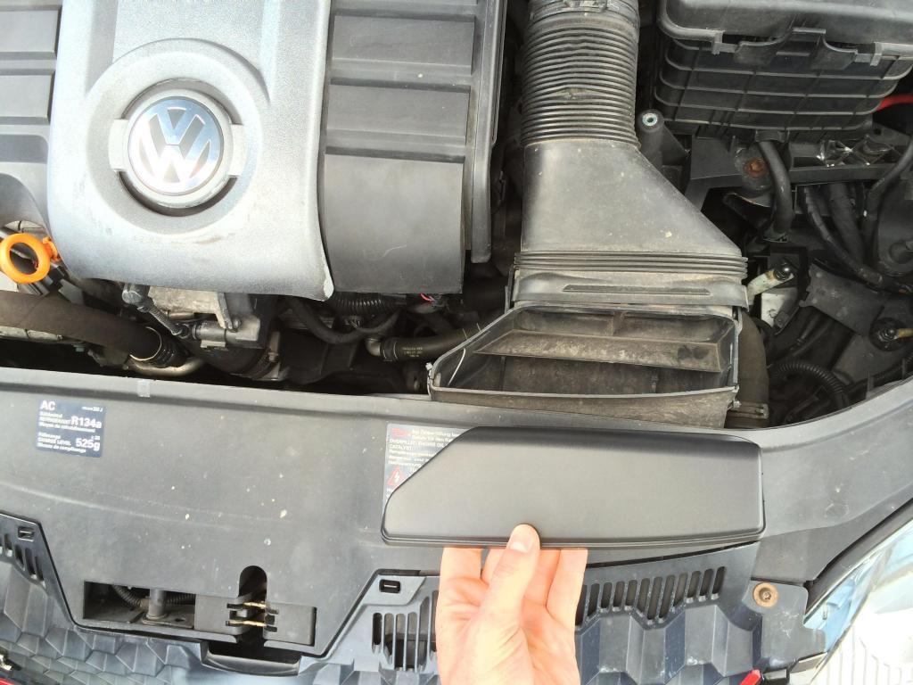

20.   Engine Intake Cover

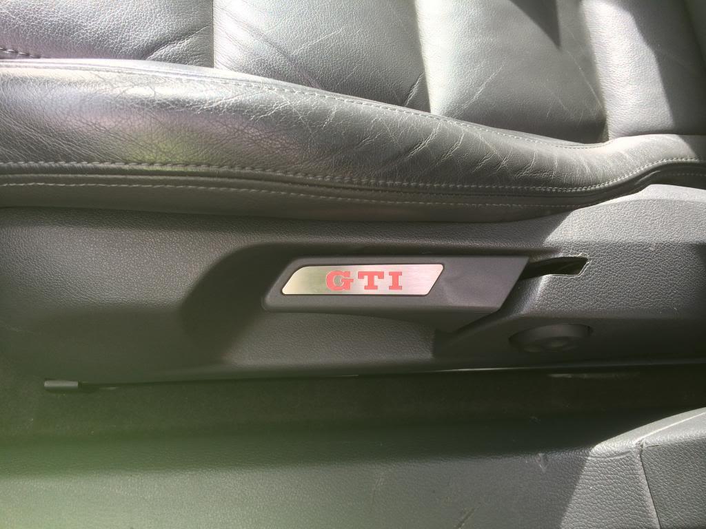

 GTI Seat Inserts
I love these inserts and they can be purchased in several different styles. Use eBay keywords such as ‘GTI Seat Inserts’ and you’ll find countless different ones. Here is a current link for the ones I purchased. Again the prices change regularly so look around to save a few euro http://www.ebay.ie/itm/2PCS-Seat-Lift-Wrench-Seat-Insert-Trim-For-VW-GOLF-5-6-MK5-MK6-GTI-/171042685352?pt=UK_CarsParts_Vehicles_CarParts_SM&hash=item27d2f041a8

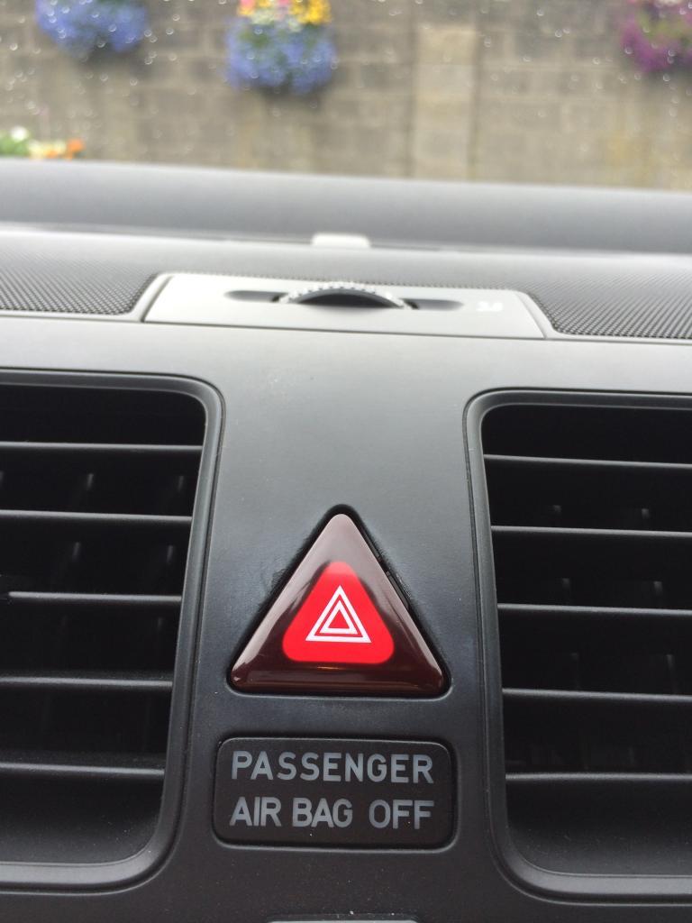

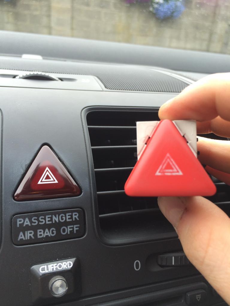

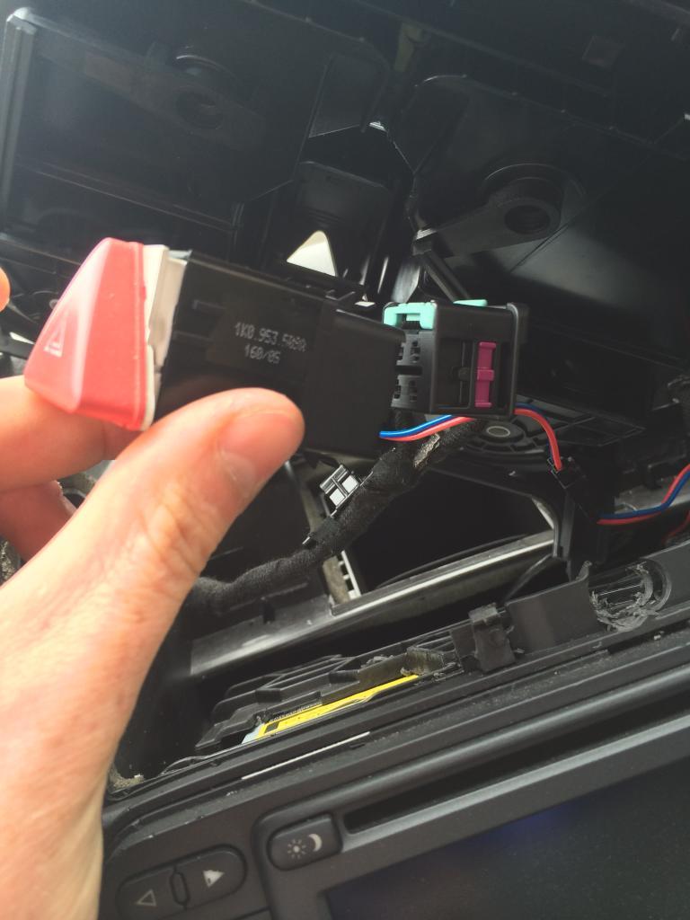

Cherry Red Hazard Switch
This was a find I picked up here on the forum. My original hazard switch was faded to nothing.

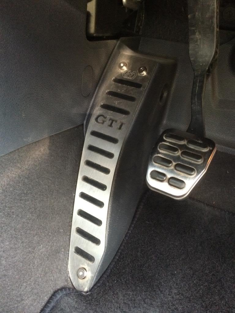

GTI Footrest Pedal
This piece really does look OEM and the work takes 10mins. You remove the plastic foot rest with the use of a single screw. Clean it down. Remove sticky tape from footrest and apply. Then you screw it in place permanently with the included screws. It may only be a small fix but I think it’s a must.
http://www.ebay.ie/itm/VW-GOLF-MK5-MK6-GTI-FOOTREST-R32-TURBO-EXCLUSIVE-WITH-OEM-BLACK-RUBBER-BACKING-/171151099551?pt=UK_CarsParts_Vehicles_CarParts_SM&hash=item27d966869f

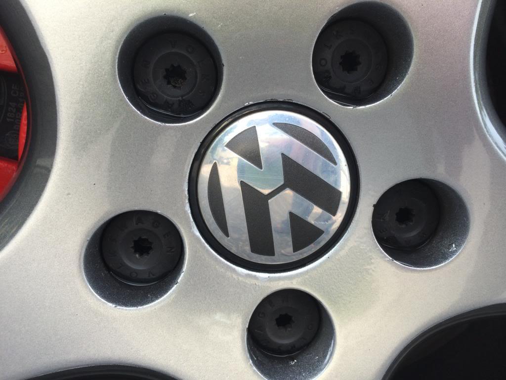

VW Centre Alloy Caps
My original ones were destroyed by whiteworm. How someone can let this happen and not do anything about it is beyond me. I picked another set up for my 18” monzas. 65mm caps suit mine. Also, I have to say these are on the car 6 months and they still look brand new. Part number - 3B7 601 171

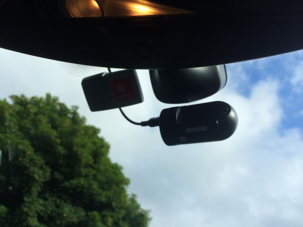

HD Dashcam Mini 0801
This is one of my best purchases. I bought this from micksgarage.com for €100 which is the going price. The quality is amazing and it’s so small that it’s completely hidden by my rear view mirror. It runs on a continuous loop so as the SD card fills up it records over the oldest footage. I have a full guide and software for the firmware update if anyone is having trouble with it (I did at the start). The camera runs on motion detection so I leave it on in car parks and if I come out and find a new dent I know how it happened. Get one of these, trust me, it can really help if you’re in an accident too.
I was fed up having to plug it into the cigarette lighter every time so I direct wired it to my internal fuse box. Now it starts automatically when I turn the ignition on and turns off when I stop the car. The wires are also completely hidden so you won’t even notice it.
http://www.micksgarage.com/proddetails.aspx?pid=3419409
My very crude wiring diagram

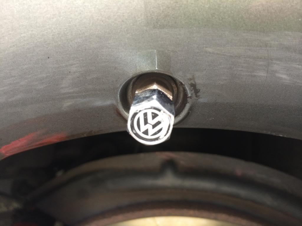

VW Tyre Air Valve Caps
These small caps took 30 days to deliver from Hong Kong but it was worth the date. They match the alloys nicely and every time I go to a tyre shop I get asked how much they were and where to buy them.  The photo was taken before I washed the car but they really have held up great.
http://www.ebay.ie/itm/Wheel-Tyre-Tire-Valve-Dust-Cap-Spanner-Keyring-Alloy-Stainless-For-VW-Volkswagen-/310969045536?pt=UK_Cars_parts_Vehicles_Wheels_tyres_trims_Valve_Caps_ET&hash=item48673

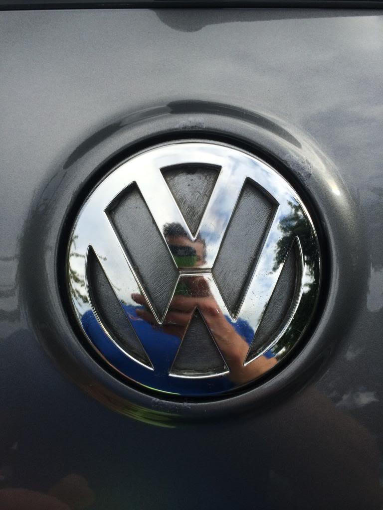

Rear Badge Boot Handle
UPDATE - Page 2 Mk6 3D boot badge handle installed.
This was the first job I undertook on my GTI. I noticed when I bought the car that it had slight whiteworm on the rear badge. Just a note here, my car is a 2005 model so the boot handle is a slow close mechanism with a flat VW badge for a handle. NOT the snap shut handle on newer Mk5 golfs.
After looking at the following review for replacement with the mk4 handle I set out to do the work. http://www.mk5golfgti.co.uk/forum/index.php/topic,8746.0.html
I purchased a mk4 golf gti badge which was the perfect fit. I then stuck it on using double sided tape.
The guide in the link above goes into full detail so I won’t say much on this myself as Garth has done a great job on it.

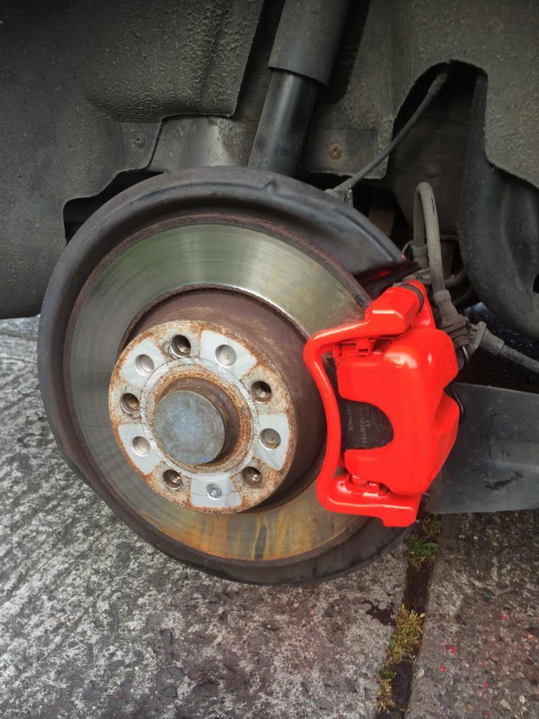

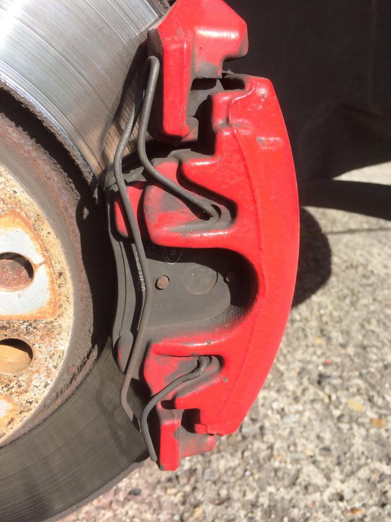

calipers Painted
My old faded pink calipers really took away from the look of the car so I tackled them over a few hours doing 2 wheels per night on a sunny Monday & Tuesday. Before you remove the 2 wheels make sure you mark which is front/back and that they go back on the same or you’re tracking will be off.
Safety: Use disposable gloves with harsh chemicals.
Products Used:
1.   Alloy Cleaner
2.   Brake Cleaner
3.   600 Grit Sandpaper
4.   1200 Grit Sandpaper
5.   Flat Head Screwdriver
6.   Pliers
7.   Masking Tape Large
8.   Masking Tape Small Detailing Tape
9.   Newspaper
10.   Brillo Pad
11.   Temperature Resistant 650 degree red spray paint
12.   Clear Lacquer Spray Paint
13.   Silicone Remover

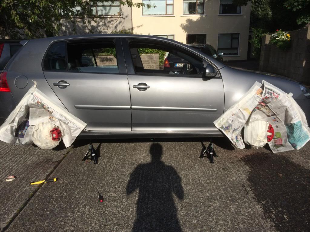

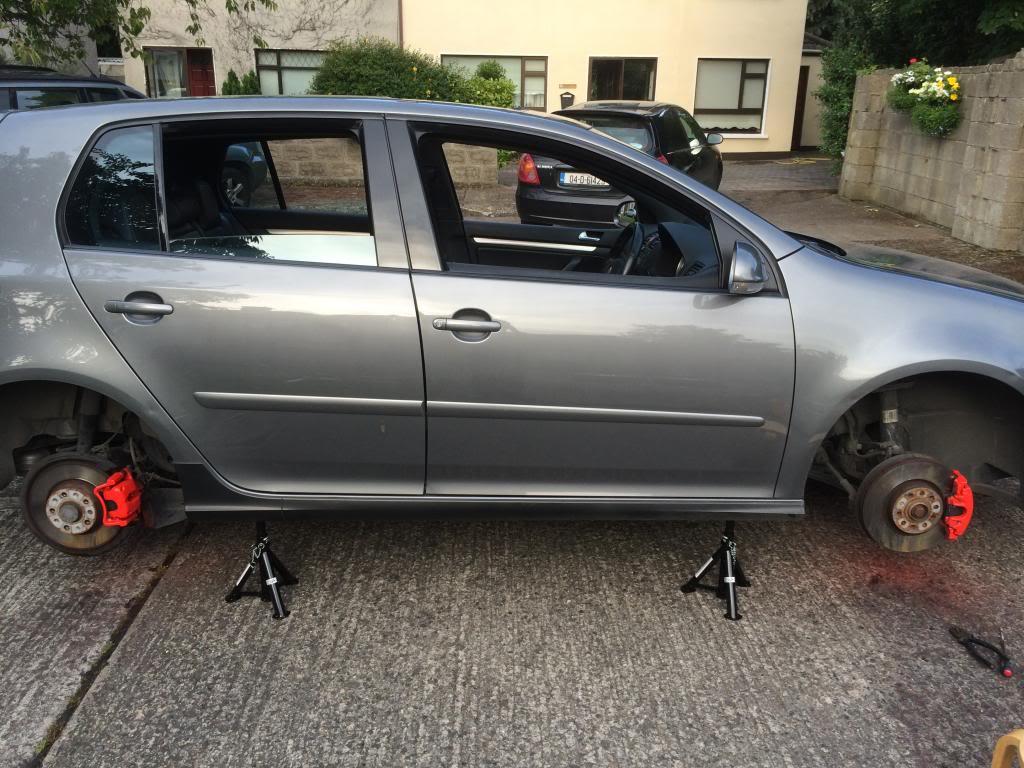

I jacked the car up and put axle stands under each support joint so that one side of the car was fully raised. Both wheels were then removed and set aside for their own repair work.
Firstly, I think you should try using the brillo bad with plenty of water on its own first. This may actually be enough to bring them back to good condition so PLEASE try this before you attack them.
I applied alloy wheel cleaner and allowed it to soak into the dirty calipers while I got set up.
I then removed the quick release spring from the front caliper and gave it a quick clean with the brillo pad.
I then started by taking off the already chipped paintwork with a flat head screwdriver.
I applied liberal amounts of the brake cleaner regularly.
I then went at them with a wet brillo pad removing what dirt I could.
Any bits of grease/dirt that remained were scraped off with the flat head screwdriver.
I then sanded the entire caliper down with 600 grit sandpaper which eventually moved up to 1200 grit sandpaper.
I cleaned down the entire unit with liberal amounts of silicone remover http://www.micksgarage.com/proddetails.aspx?pid=1640492&pk=6aabf

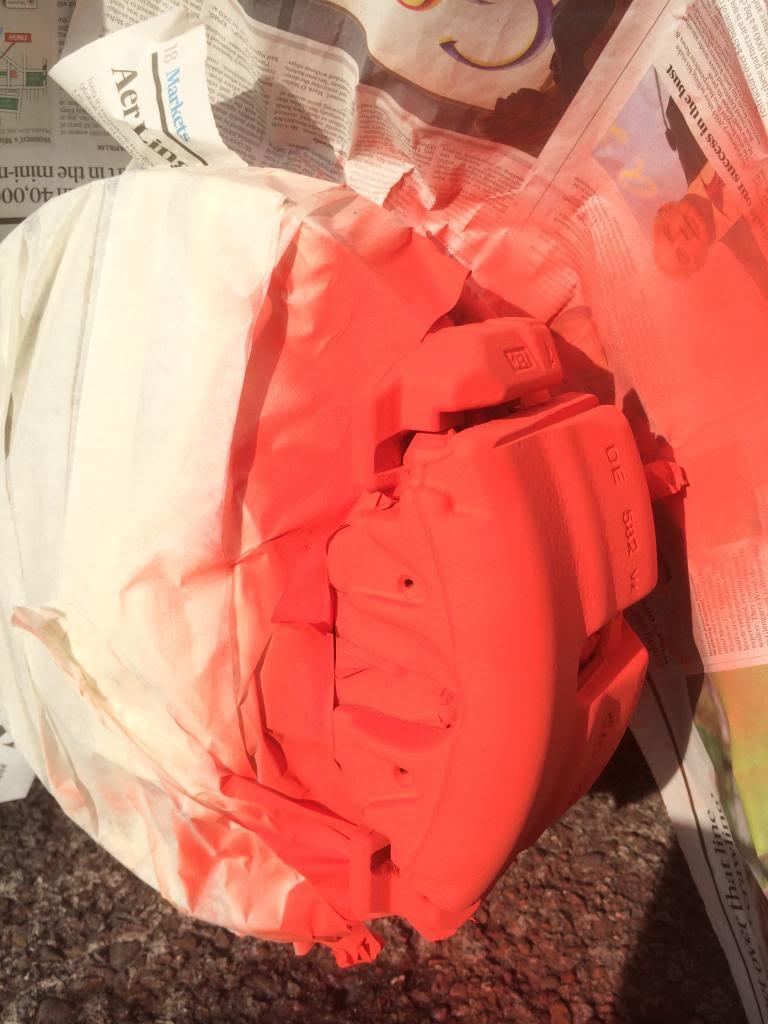

I then masked up the small detailed parts with the smaller detailing masking tape taking extra care around the pads etc. Make sure you cover the hose connections and fittings along with the centre of the face of the caliper or else you’ll spray your discs.
I then masked off the rest of the parts using the larger tape and added newspaper all around the wheel well and into the doors to prevent wayward sprats hitting the panels.
When everything was set up and ready to go I gave the calipers one last clean with brake cleaner which dried up in the sun in a couple of minutes. NO cloths here.
I then applied the first very thin layer of temperature resistant red spray paint. Remember you’re only giving it a few light coats or you’ll form droplets.
Each coat dried for me in about 20mins facing the sun in about 24° weather.
After another 1 or 2 more coats of red paint I was happy they were fully covered.
I then set upon applying the lacquer. Again in very thin layers.
I put the quick release spring back onto the front caliper very carefully holding it in place with the screwdriver and moving it with the pliers. Please be very careful doing this as I guarantee you will scratch the fresh painted caliper.
I put the wheels back on and gave the car a quick spin applying good braking pressure to make sure nothing was out of place.
Note: While the wheels were off and I was waiting on the coats to dry on the calipers I started to repair my alloys as shown in the next section.

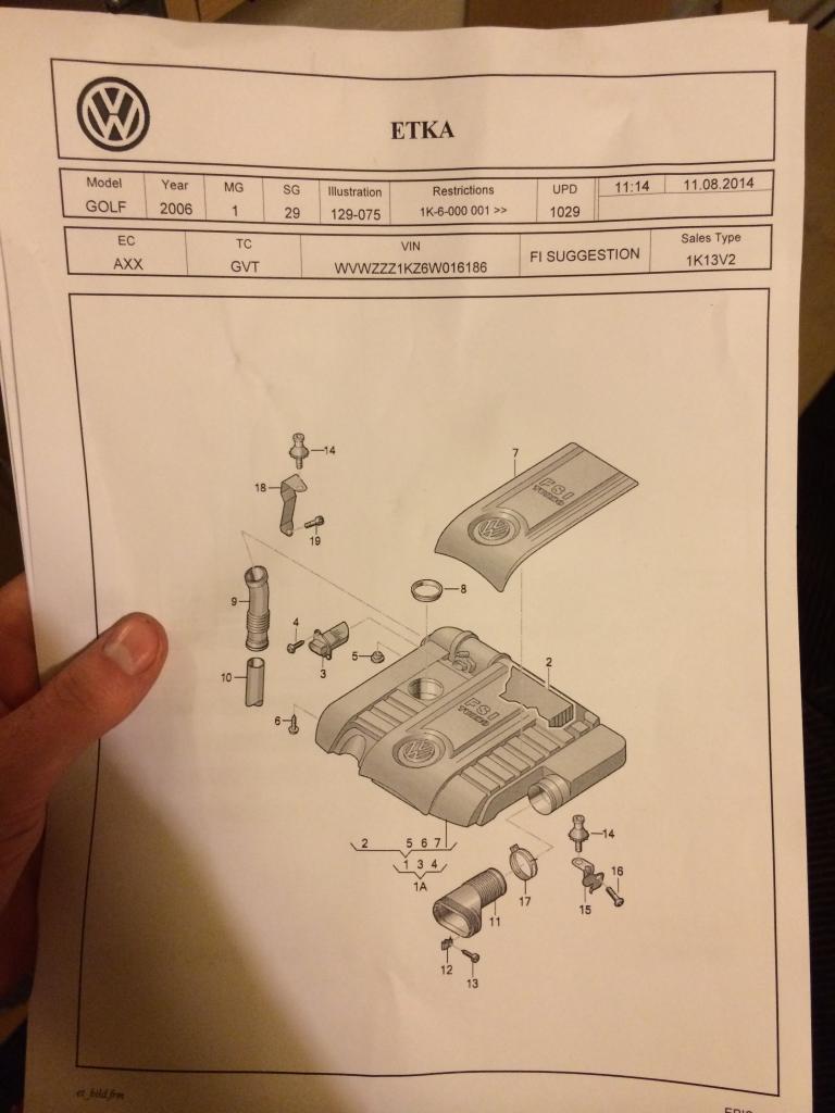

Engine Cover
Note: You only need to remove the grey cover on the engine to do this but I removed the entire casing as I wanted to replace the rubber mounts below.
The engine cover removal was tricky enough. It is held in place by 4 rubber grommets and at this stage of its life I guarantee that rubber has degraded and you will most likely tear one of the rubber grommets trying to get it off. Please see the guide I followed. http://www.golfmkv.com/forums/showthread.php?t=113978
I actually replaced these rubber grommets with new ones from VW parts as they were showing signs of wear. Only €2 each from memory.
I left the air suction pipe on and just unscrewed the 2 number torx bolts when taking mine off.
I then separated the silver FSI Turbo section from the middle of the engine cover which just snaps off. Do this in warmer weather or the clips might snap.

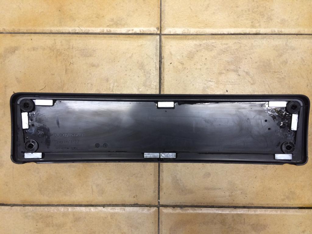

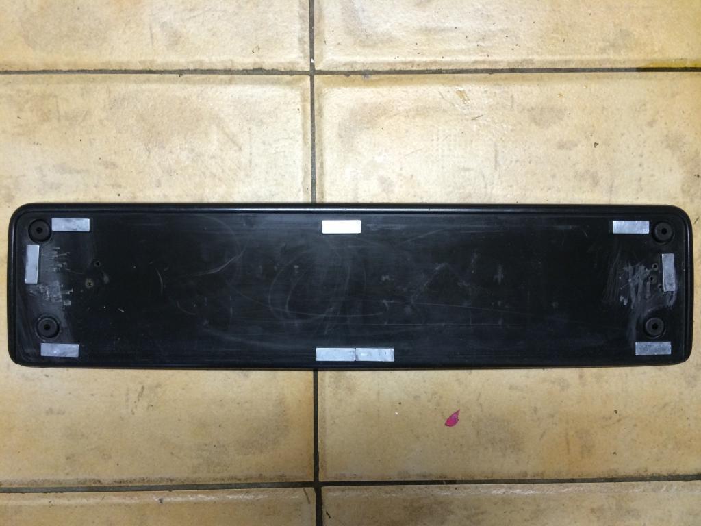

Magnetic Registration Plates
I got a nice set of aluminium German pressed plates for my car and tried holding them in place with 3m double sided tape. Unfortunately after time the 3m tape tends to lose its grip on the front plate due to temperature fluctuations and the curvature of the plate I imagine so I thought I’d hold them in place with magnets. Another benefit to this is that the plates can also be taken off with ease for taking photos if you didn’t want your reg on show.
I happened to have a load of neodymium magnets (the strongest naturally occurring magnet on the planet) at home for a previous project but they were too small and wouldn’t adhere to certain parts so I decided to go for some 30mm x 10mm x 2mm ones here
 http://www.ebay.com.au/itm/5X-N35-Strong-Bar-Cuboid-Block-Magnets-Rare-Earth-Neodymium-30-x-10-x-3-mm-/131208288816?ssPageName=ADME:L:OC:IE:3160
For the rear of the car I used double sided tape as the straight surface meant the tape was strong enough to hold it in place.
Note: The magnets are very fragile so be cautious when prising the magnets apart. They tend to snap!
With the front reg I removed the black registration plate holder and cleaned up both sides with silicone remover.
To remove the reg holder you need to push the plastic centre pin out of each corner holder. If you do this carefully they are reusable so do it in warm weather.
Now for aesthetics I decided I would place the magnets at the back of the holder so that when the front registration plate is removed you won’t see the magnets. Marking this up wasn’t as easy so measure twice stick once!
From the photo below you can see where I placed the magnets. This was the ideal place as too close to the corner and you would see them sticking out around the reg.
I then turned the plate holder over and dropped magnets onto the surface which automatically adhered to the other side.
I roughed up the back of the registration plate with a steel brush and some sandpaper and after a final clean with silicone remover it was good to go.
A SMALL amount of superglue was added to the top of each magnet and I put the reg in place. Too much and it will spill over onto the plastic and the magnet will stick to it.
After waiting a short time to dry I lifted the reg off and the magnets came with it leaving a clean black reg holder.

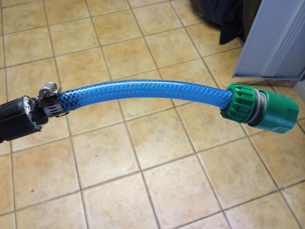

Snowfoam
After hearing about snowfoam I decided to take a trip to Halfords. Just by chance they had a 3 for 2 sale on so I got 2 bottles of snowfoam and a bottle of spray shine ‘Car Plan Demon Foam’. I also got the 2 adapters for each bottle so now my challenge was to connect this adapter directly to my pressure washer so as I didn’t have to buy a snow foam lance.
My pressure washer came with 3 different nozzles so I sacrificed the wheel brush considering I don’t use it. This wheel brush has a threaded female connection which I connected to a corresponding threaded male connection with a male hose connection on the other side. I then used a short length of braided hose to connect the male hose connection to a female hose connection. A jubilee clip held the hose onto the male hose connection and the female hose connection is tightened in place.
After a quick round of PTFE tape to provide a good seal on the threaded connection I was good to go. Although the above seems confusing I basically just connected the original pressure washer connection to the demon foam hose connection with a few fittings I had lying around.
The connection piece I made comes off incredibly easy and fits both the snow foam and the spray shine so now the whole car can be washed in half the time.

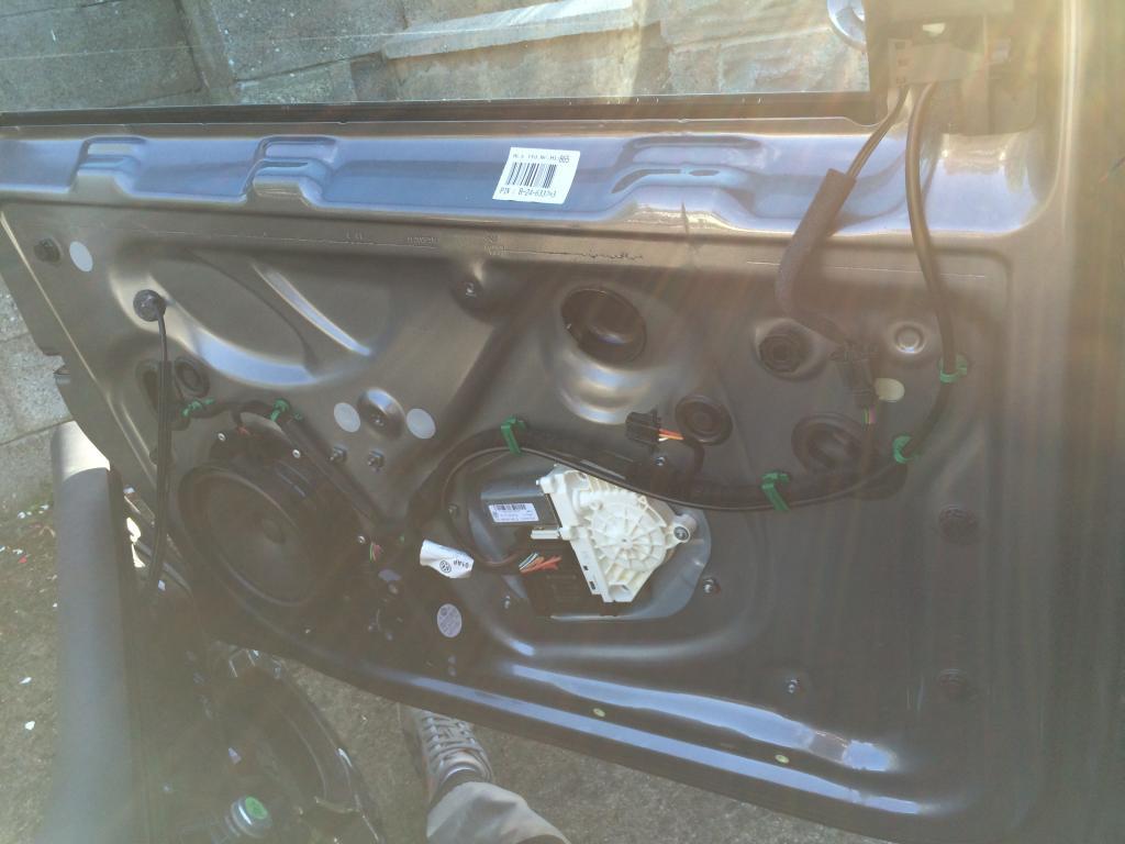

Replacing Door Handles & Switches
A common theme among VW seems to be the coating on the handles and switches being scratched off over the years. The mk6 golf came out with chrome tipped switches so no more scratching off on the buttons but the handles themselves will wear again in a few years.
I went with aliexpress.com for the switches after checking feedback on the forum. I picked up these ones for €36 http://www.aliexpress.com/snapshot/6169988034.html
I then set about replacing the front 2 door handles which I bought direct from VW.
Part numbers for 5 door handles below:
Handle: V1k0867179d
Cover: v1k0868039b
Cover: v1k4868050c
There are many guides on here for replacing so I won’t go into much detail.
Driver Side:
The driver side is very easy. I used a piece of plastic to prize the handle off which isn’t too difficult at all. The old switches simply unplug and unclip with a flat head screwdriver. A 5 minute hob here.
Passenger Side:
Now this is messy. The passenger side handle is made up of 2 pieces. If you’re only changing the switch then you’re fine and you can access the switch by taking off the lower section and unplugging switch from below.
IMPORTANT- There are 3 number hidden torx screws holding the handle in place from the inside of the door leaf. Do not try and pull the handle off thinking they’re only clips.
If you’re replacing handle then you need to remove the 2 number torx screws from the handle. Then you need to remove the inner door leaf which is held in place by around 7 pop clips. Do this in warm weather or you’ll crack the clips.
Some of the clips will stick in the door frame after removal so you’ll need to use a pliers to get them out and put them back into the door leaf before replacing.
You then need to unclip the wires on the door leaf before getting to the back of the handle and removing the 3 number hidden torx screws holding the handle in place.

This seems to be a very common issue with the GTI. The intake cover near the bonnet is only held in place with 2 small clips and comes off very easily. It’s a very quick fit and although there’s no real harm leaving it off it looks better aesthetically putting it back on.
Part Number:
1K0 805 965 C
Rubber Engine Mounts
As you call know rubber degrades over time so a lot of the rubber mounts on the car will need to be replaced. A common one is the 4 number rubber mounts the engine cover sits on to hold it in place. I took my engine cover off to paint and noticed a few were torn so I replaced for a few euro. Don’t have part numbers but your dealer can work off the following illustration.
Illustration 129-075
Piece 5. While I was at it I also replaced piece 14 along with new bolts for the intake holder (Piece 12 and 13)

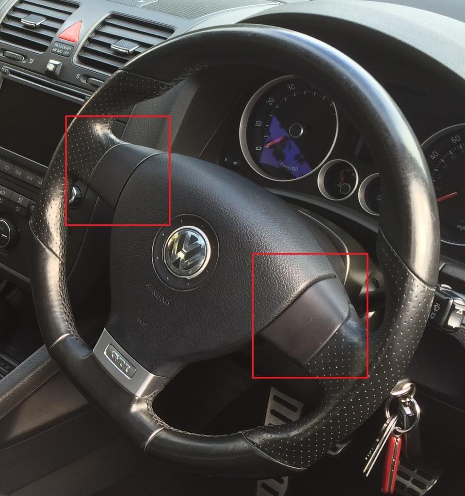

Steering Wheel Plastic Surrounds
There are 2 piece of plastic either side of the horn on the steering wheel that have the same coating as the door handles. They show slight wear so I said I’d change them.
Part Numbers:
616 083 65
616 083 66
I was looking at the old ones thinking I could do something with them so I peeled off all of the old coating with my nail.
I then sanded them down with 600grit.
2 coats of colour match paint.
2 coats of clear lacquer.
They look much better than the original ones I just bought brand new
I now actually prefer these to the original ones so will put them back in storage.

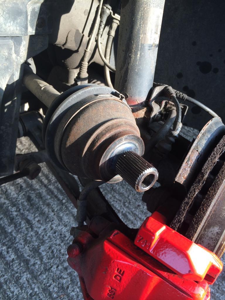

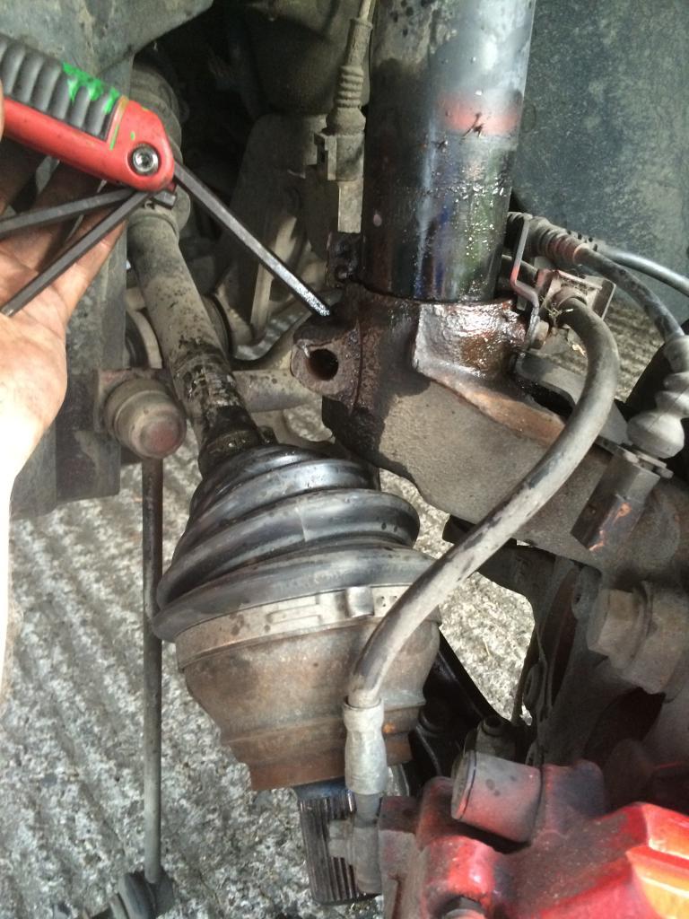

Outer CV Boot Replacement & Suspension Bearings
I left my car in for it’s full service with VW and they let me know my passenger side CV was weeping so I picked up a new boot for around €20 and tackled myself in a few hours.
Coincidentally my driver side boot failed a week later so I have since replaced that also!

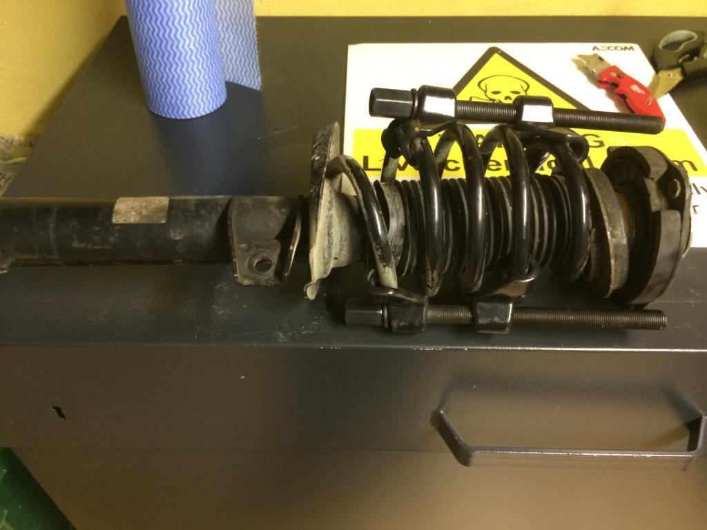

I decided while I was doing this to check my strut mount bearings and the shock absorbers so I did both jobs together.
You need a special tool here to secure the clips onto the CV boot. Get this now or don’t tackle the job.
This isn’t a full how to guide, it’s just a basic overall as I’m bound to have forgotten a few bits. It’s just to give those who have the same problem an idea of the work involved before they make their decision. Overall time for an untrained mechanic is about 6 hours.

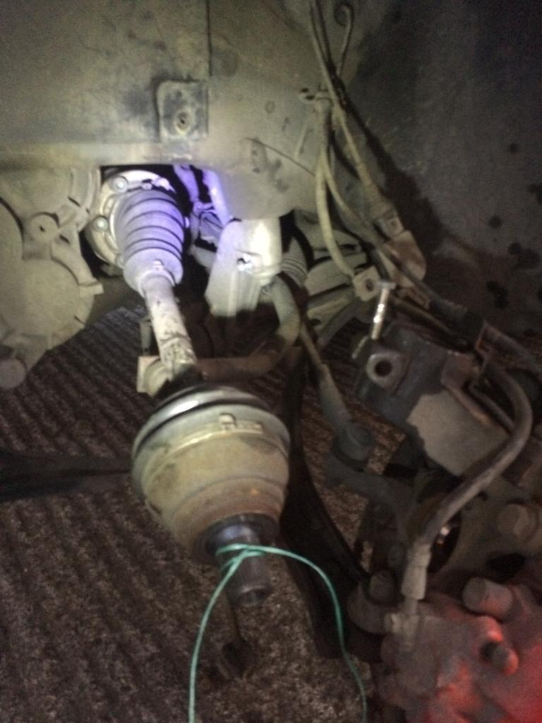

Before you lift the car remove the wheel centre cap and unscrew the driveshaft centre bolt just a quarter turn along with the 5 bolts holding the wheel in place.
Start by jacking the car as high as you can to give a good working area. Apply axle stands and wooden chocks.
Remove wheel. Now if you have forgotten to loosen the centre bolt earlier on fear not. Put a flat head screwdriver in between the brake disc and the caliper and you can turn the bolt now without the shaft turning.

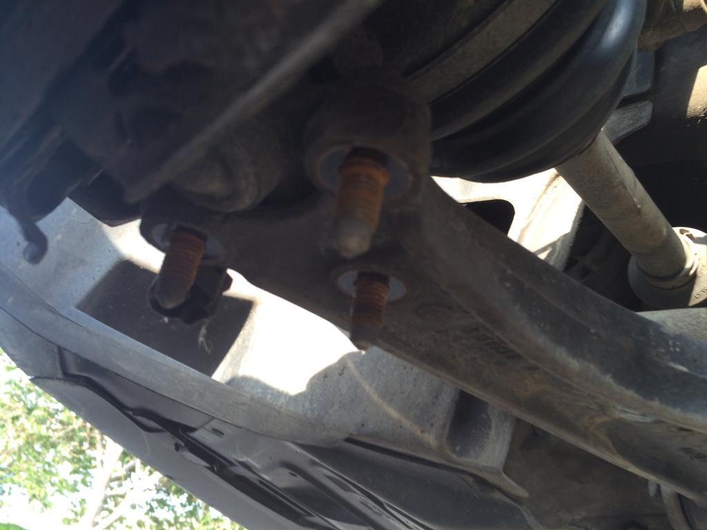

Remove the 3 bolts holding in place the wishbone.
Now get the driveshaft out of the wheel hub. I put a socket into the hub and gave it a bang to push it out of place.
Get the hub to one side and hold it propped up. Disconnect all connections.
Move the driveshaft to the other side and prop it up with a rope. Don’t let the CV joint rest under it’s own weight.
NOTE: Remove the headlight level sensor and switch!!!! It’s connected to the wishbone and the frame with M10 nuts.
At this point I diverge to tackle the suspension. If you don’t need to then continue with work on CV and disregard below points on suspension.
Remove the bolt holding the suspension to the hub. You need a special tool to spread the frame surrounding the suspension to remove it. I put an allen key in the gap and twisted it, then banged a bolt into the space to keep it open. Now  a few taps with a hammer and it should come off.
Again keep the wheel hub propped. Remove the 3 bolts inside the engine bay to release the suspension. Compress springs, check bearings, top mount and shock absorber. All was ok and in good conditions so back in it went!

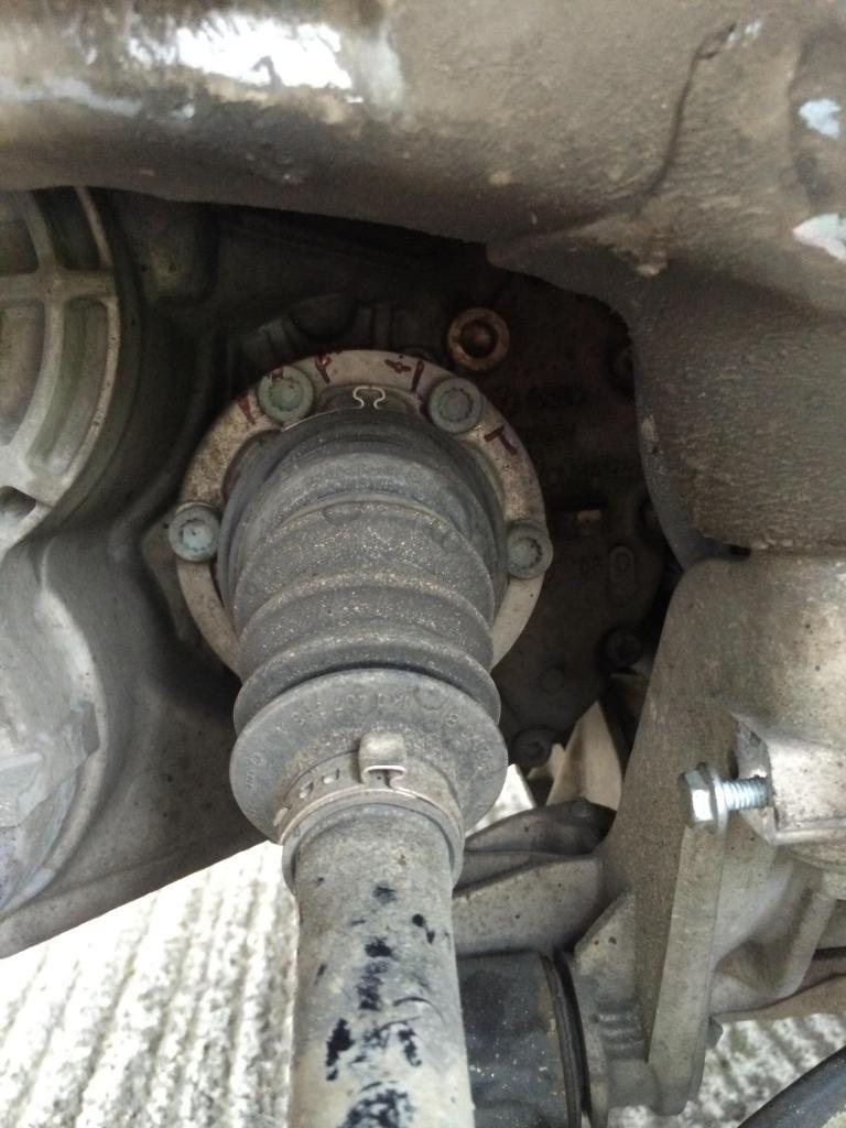

Now get the old boot off with a Stanley blade. Remove old clips with a snips. Clear off as much grease as you can.
I only needed to change my outer CV boot so I removed the joint in situ. If you need to change inner CV boot I suggest removing outer CV joint from a vice. The inner CV joint is held in place with 5 number spline bits threadlocked to death!
Now I have my old boot off and the joint is visible. Start watching youtube videos on how to do this but basically you tilt the joint to one side to gain visible access to the joint. Give it a good thump with a hammer and the joint will come off. You need to hold the inner joint in place at the same time. Just learn about this beforehand and don’t beat away with a hammer thinking it’s fine!!
Now I have my old joint off. Remove old grease and check for damage. Now pump it full of new grease.
Put the washers etc. back in the way you found them and put the first clip on. Now slip on new boot. Line up cv joint onto splines and hammer home. Secure both clips with a specialist tool.
Putting it back together is handy enough. Lining up the splines and pulling them into the wheel hub was a pain so I got them somewhat lined up and poked a bar into the middle to raise it to the right height. I then put a bolt into it and tightened it to pull the driveshaft into place.

If you have the old slow close mk5 badge then you need to remove the thin metal vw cover which has the whiteworm. Behind this badge is a small hole around 4mm wide that'll need to be filled and sanded or you'll see it when you put the mk4 badge on.
When you get the old badge off you'll see what I mean.
My honest opinion though is that I don't particularly like the mk4 look and in the future I would like to go for another option. Possibly the beveled mk6 badge

Where did you take the power for the dashcam from ?
Do you have any photos ?
Offline lukemk5gti
  • -Given: 28
  • -Receive: 118
  • Posts: 1845
Re: Luke's GTI Build Thread - Full of How To Guides
« Reply #6 on: November 18, 2014, 01:26:56 pm »
Nice looking GTI Luke. Great write up.
Thanks! I took the power direct from the fuse box. Brief how to:
Trace the cable behind the driver side airbag column to the inside of the fuse box.
Connect the cigarette end on the dashcam into this attachment - http://www.ebay.ie/itm/12V-24V-Single-Waterproof-Cigarette-Lighter-Auxiliary-Power-Socket-Car-Motorbike-/380503208544?pt=LH_DefaultDomain_3&hash=item5897c23260
Connect the red wire on the attachment above onto this red wire from the piggy back attachment http://www.ebay.co.uk/itm/2-Add-A-Circuit-Fuse-Tap-Piggy-Back-Standard-Blade-Fuse-Holder-ATO-ATC-12v-24v-/170709632237
Connect the black wire to a ring end and earth it onto a bolt inside the fuse box.
Plug the fuse into an empty fuse inside the fuse box.
I'll get a photo there of the set up inside when I'm at the car if you need.
