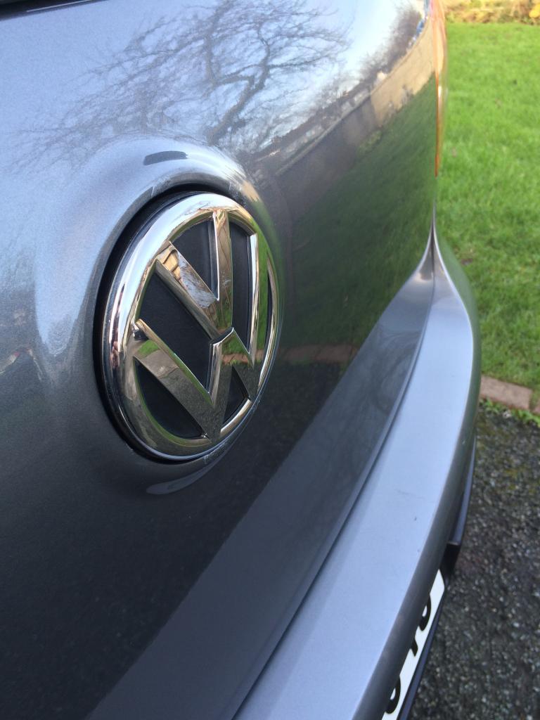

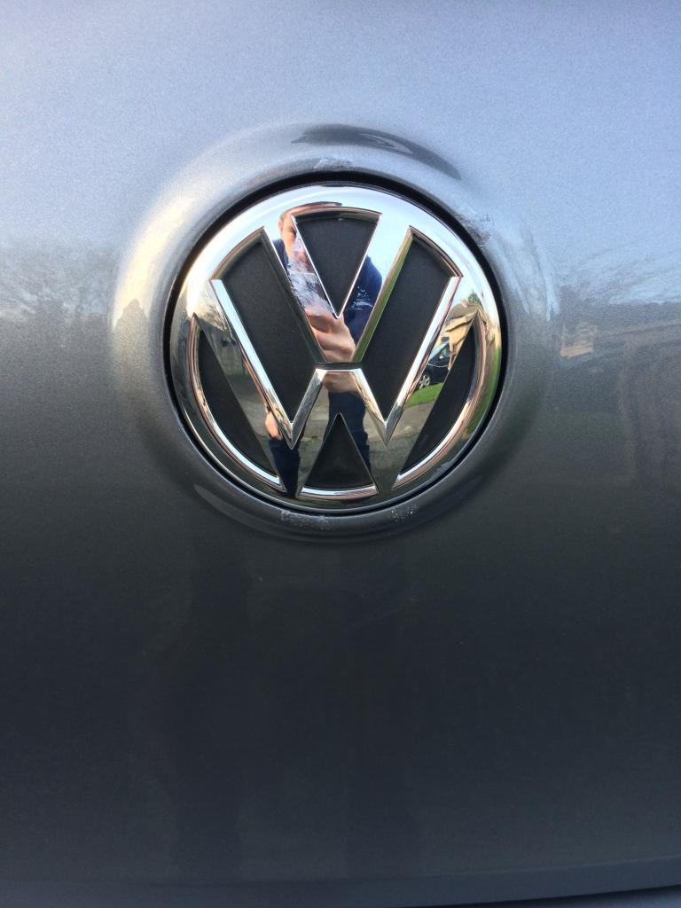

New Update - Rear Tailgate Handle
After I replaced my corroded slow close boot badge with the mk4 3d cover I just didn't like it so I bought a mk6 mechanism and replaced the whole lot.
Have to say this one looks much better. The wiring on the inside is tight as the plug is on the wrong side but making a few careful cuts and you can loosed it up just enough!

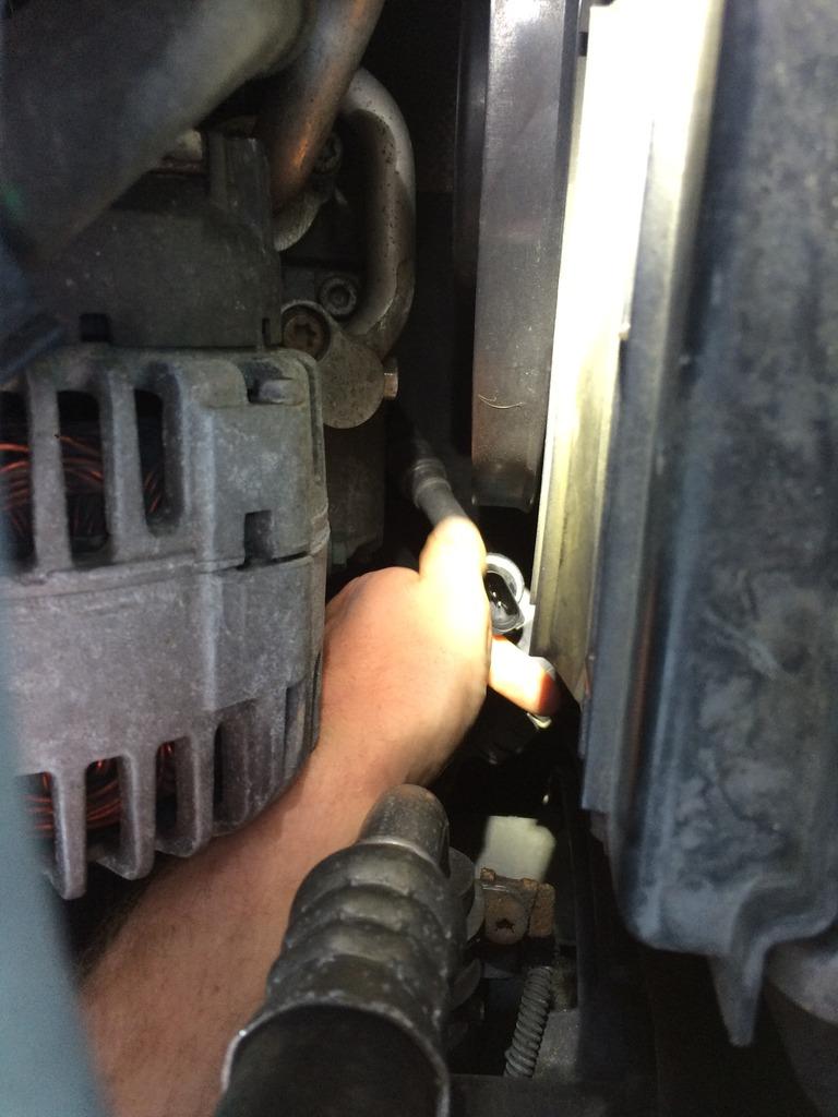

With the hotter summer months I've now started back using AC. Noticed it wasn't working well so I VCDS scanned and found the error code P00819 relating to a failed G65 sensor - Part Number  1K0-959-126-A
To change this sensor isn't much work at all if you have a 17mm crows foot spanner and suitable extension bar:
The sensor is at the front of the engine facing just slightly below the alternator
A quick change of this and a gas top up then I'm good to go.

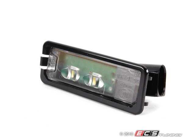

One of my reg light bulbs went so rather than replace the standard light with an LED. I replaced the entire light unit with the Mk6 LED unit.
Part number - 1K8943021C
Very easy to do, just release screw and pop the old one out.

I'd say the best upgrade to do to our license place lights is fitting the mk6 LED full units: 1K8943021C.
They look great and don't give any bulb out error in the instrument cluster of our mk5s. :happy2:
