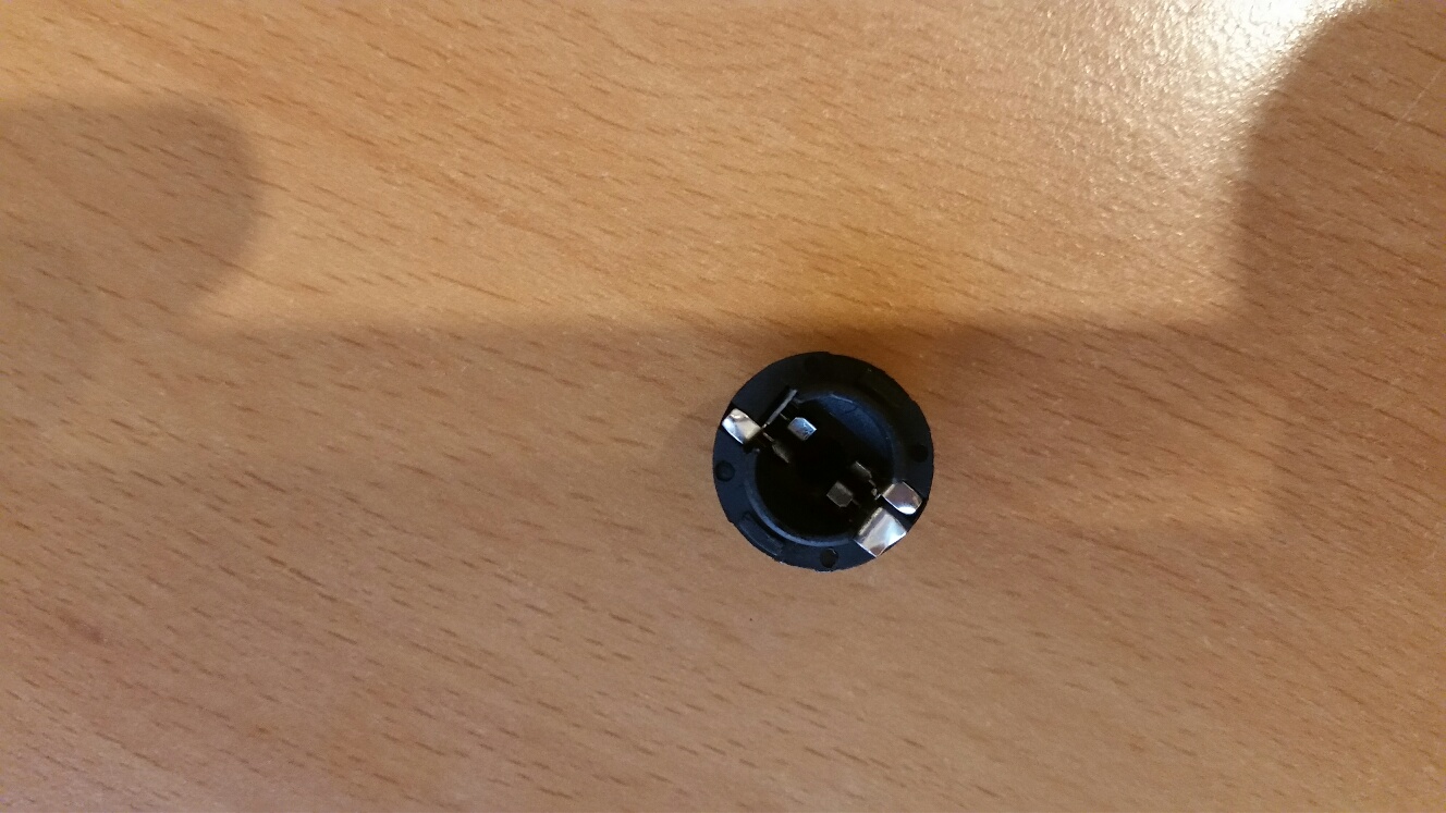

I also need a bulb holder for one of the map lights. If anyone knows the part number.

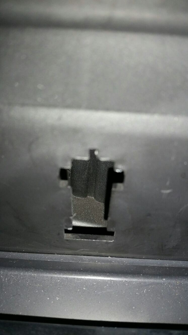

Is this hole behind the glove box supposed to have the switch for the glovebox light??  :sad1:

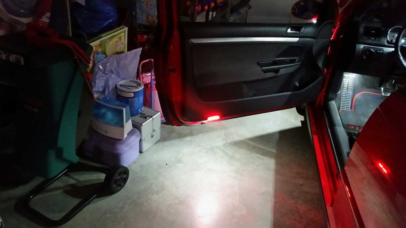

Led door warning lights are in. Simple once i found out what pins to use.
Pin 1 Positive. Sliced ground on to pin 4. No slicing needed on the passenger side again used pins 1 and 4.
Also noticed glove box light not working so will have to remove the glove box and check the switch.
Does this help for the bulb holder Dazza http://www.partscats.info/volkswagen/en/?i=cat_vag_models&brand=vw&number=1714&set=1728&ein=2007&f=474&hauptgr=1234567890&hg=9&grf=094700420&bf=94705&hgug=947&ug=47&parent_id=2363557
