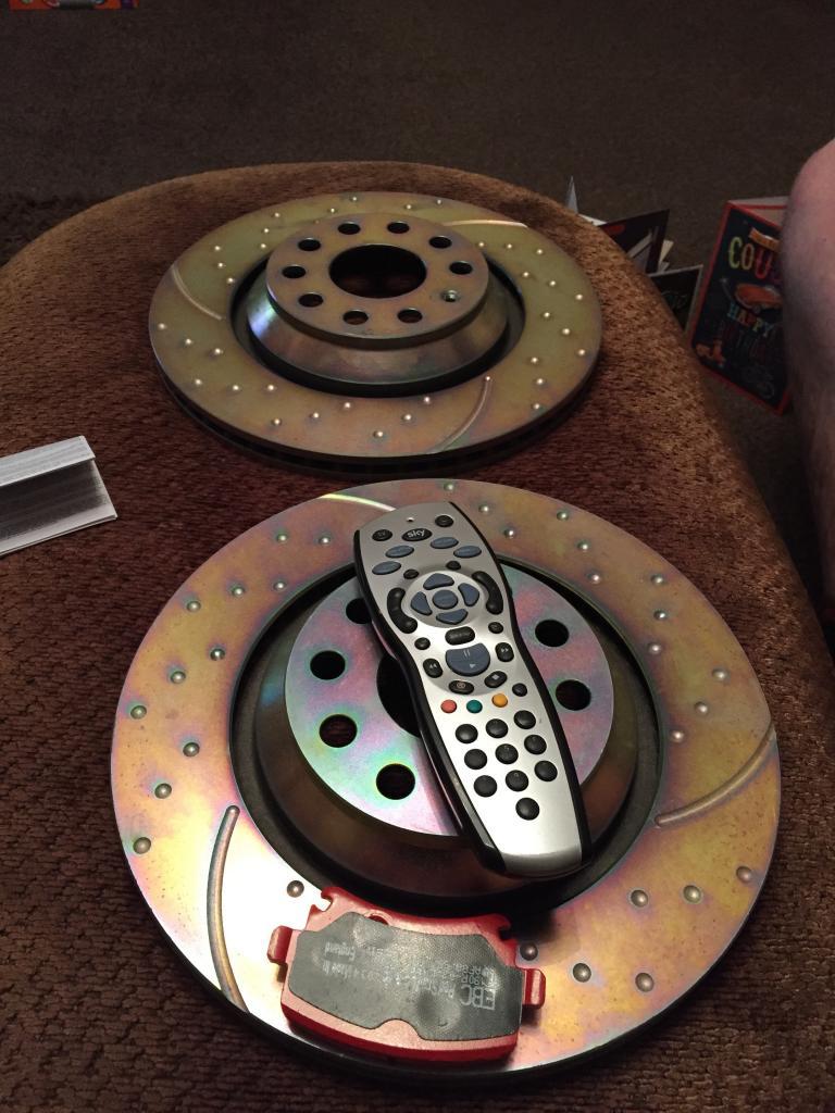

« Reply #7 on: February 07, 2015, 03:09:38 pm »
the ones i recieved;
Offline Beddie
  • -Receive: 76
  • Posts: 1303
Re: demon tweeks wtf
« Reply #8 on: February 07, 2015, 03:15:04 pm »
and they do not fit i know they are the same part no of the r32 ones, but my discs are definitely 310 x 22 vented
So you have the R32 rear disc upgrade on your car then?  :smiley:
If so, can't see why the discs supplied shouldn't fit as they definitely look like OE R32 rears..
