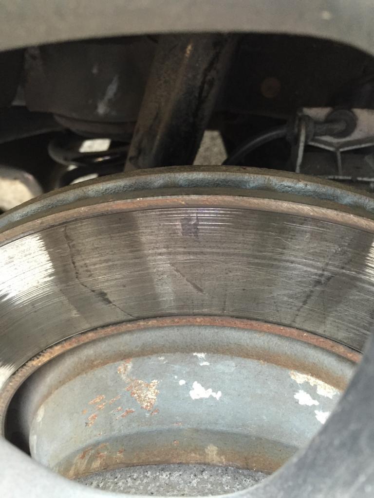

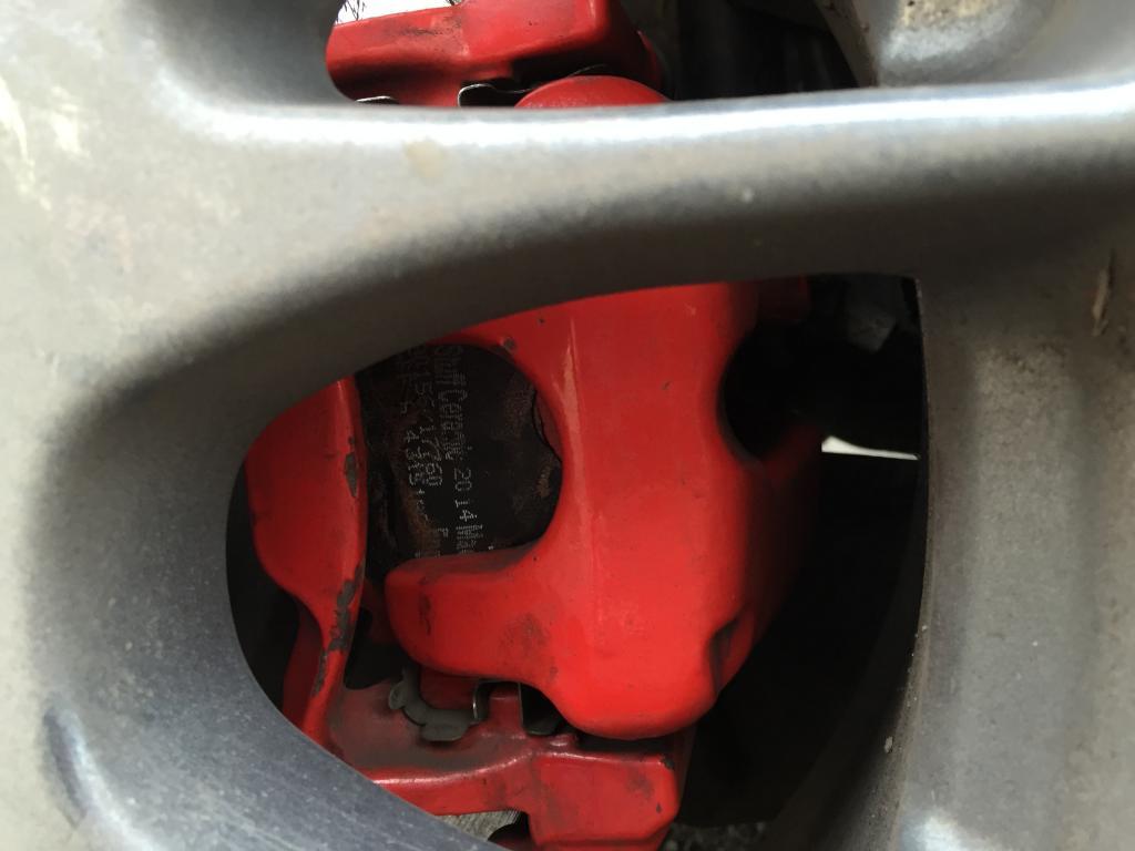

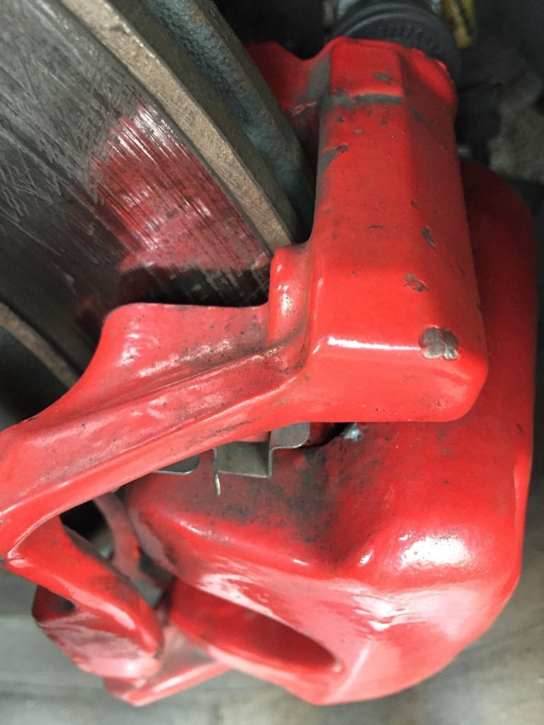

this is how it sits now old discs new pads

« Reply #18 on: February 07, 2015, 04:23:29 pm »
Does the part number on the EBC box match what you have ordered?
There are two different versions of the 310mm disc, one for the R32/S3 and one for the TTS.  The have different offsets.  TTS disc sits further in towards the car.
to be honest the new ones are not enough towards the car

« Reply #19 on: February 07, 2015, 04:24:38 pm »
So the new ones sit too far out, where the old ones sit in towards the centre of the car?
Follow AKS tuning on Facebook

« Reply #20 on: February 07, 2015, 04:26:24 pm »
correct yes like they have more of a taper, if you compare the photo of my old disc to the ones i recieved
