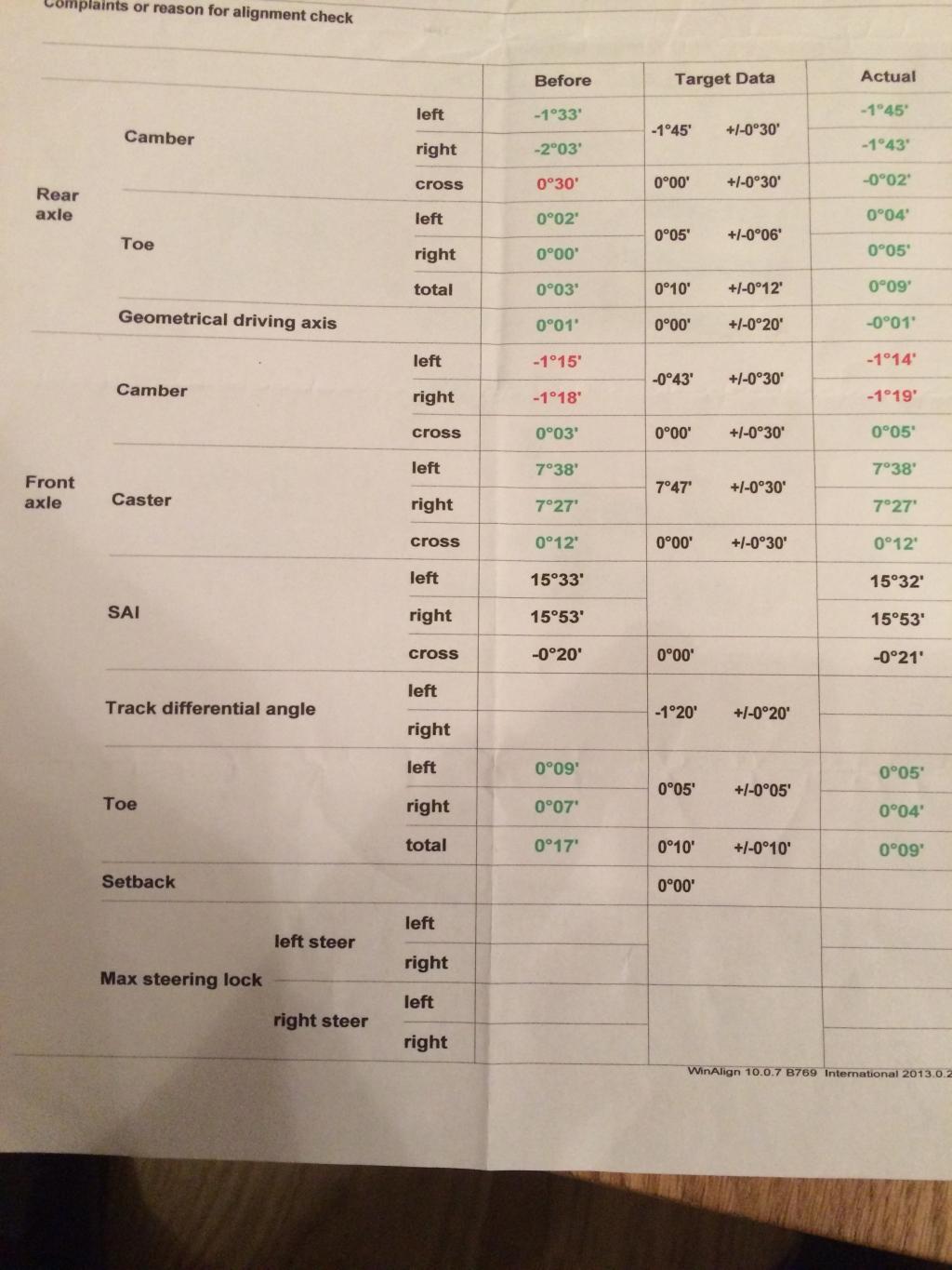

As I mentioned above, the stock settings should be fine. If it's a Hunter Alignment machine then it'll have an acceptable range that each setting has to fall within. I've got those ranges if you want them as mine was aligned yesterday. :smiley:

You've not lowered it much so you still need to aim for the factory settings range. What becomes an issue is when you slam it and it's so low that you run out of adjustability on the OEM parts and have to start adding camber plates etc.
