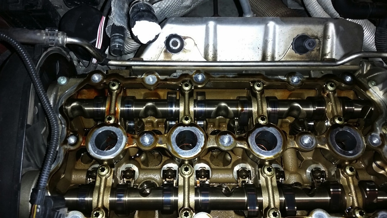

So the little oil leak has now reached the floor.
Pulled the valve cover. So that didn't seal very well.
Options?
05 | Tornado Red | DSG

Cleaned everything up the new gasket is in.
Valve cover bolts tourqed to 10NM?
I could not get the jubilee clip i got from VW to fit. There is not enough space to slide it down the pipe then back over once its on. (see pic the large pipe at the back with the tissue in.)

All finished hopefully i've done a better job than last time.

Thanks guys i replaced the 5 bolts at the back. And gave everything a good clean.
But the head felt rough in places.
Going to give the engine bay a good clean next week. Will probably try and clean the mess from underneath also.

The valve cover is still leaking from the back. Around the second and third bolt from the left not sure on the first bolt as i can't get at it.
These bolts are new. I don't get it. WTF am i doing wrong??
