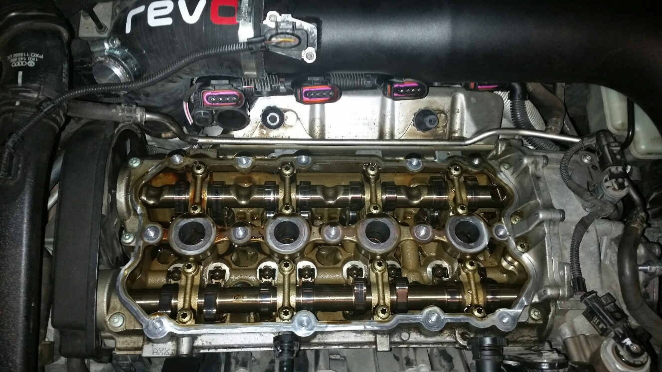

I've removed the valve cover again. See pick below.
If the rear check valve is in the very end of the pipe i don't have one.
Don't know what to do now.

« Reply #26 on: May 11, 2015, 03:22:04 pm »
check gasket around bolt holes make sure you haven't nicked it anywhere (unlikely you have but worth a check)
stick your finger down rear pipe if it goes all the way you in you have no check valve
check mating surfaces are clean and smooth
also inspect cam cover for damage etc unlikely as that is
Touran TFSI Quattro | stage 2+ BHZ | UK's first
