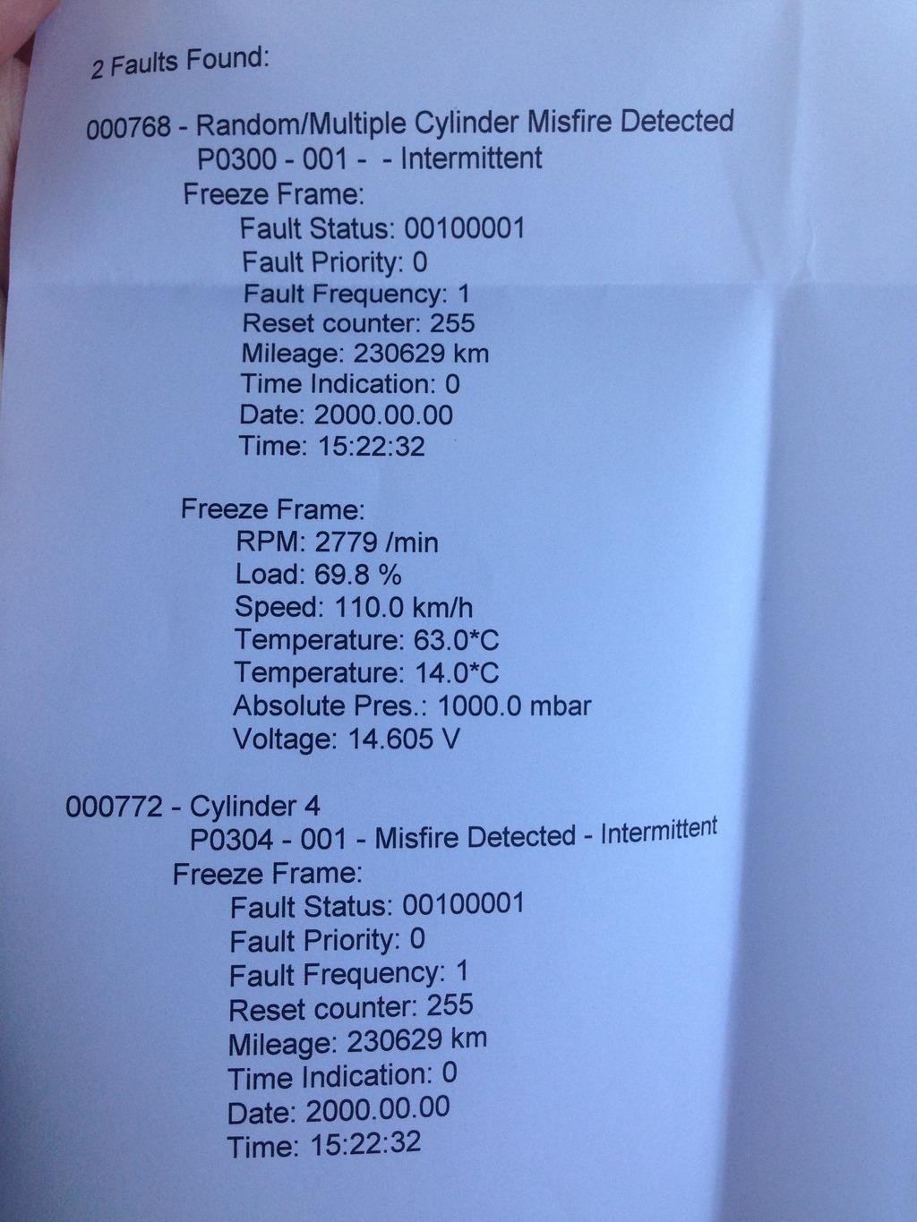

Took it back to the garage this morning, car is driving fine now, they scanned it and got these fault codes. If anyone can help or shed some light on the potential issues ld really appreciate it.
Full VCDS Hex + Can.

« Reply #4 on: March 24, 2015, 12:44:47 pm »
Check your wiring loom for signs of damage, give the connection a good clean with compressed air and check the spark plugs are in good condition and correctly spaced (refer to a Haynes manual for clearances).
