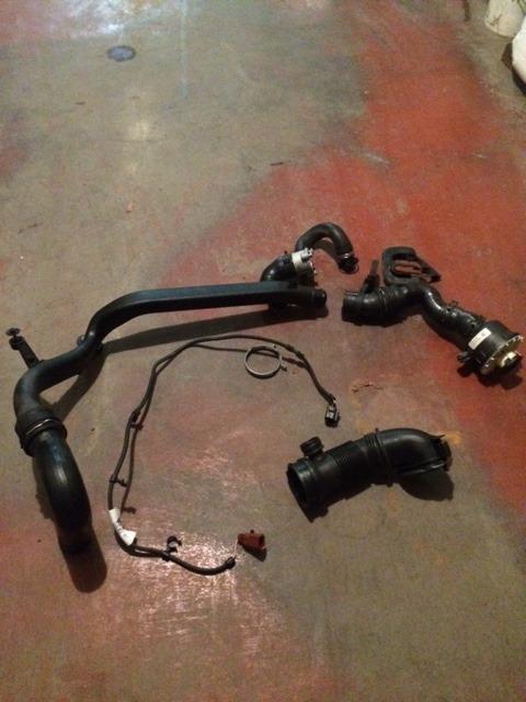

« Reply #233 on: March 09, 2016, 01:52:58 pm »
Hey there :wink:
I've mounted the bracket for the DV relocation yesterday.
You are right there's only 1 bolt and 2 nuts! Now the nuts you don't need to buy them because they are already mounted for the other bracket wich holds nothing  :surprised:
Anyway  this is what you asked me :laugh:
I also took some pic's from the parts I removed wich are no more needed.
 :wink:

Re: Candy White Golf GTI Ed. 30 - First track day
« Reply #236 on: March 10, 2016, 12:23:42 am »
Took me a while but I got it! Not bad for a dinosaur :signLOL:

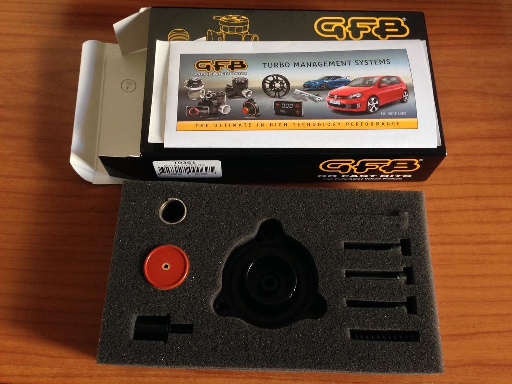

Today I went to the Post Office to pick up the GFB DV+. Just waiting for two hoses to arrive from VW to see when I can do the relocation of the DV. :smiley:

 :thinking: Now where have I seen this lovely pieces of kit before? :drinking: :congrats: :congrats:              :happy2:
You're almost ready to attack your BYD! :wink:
