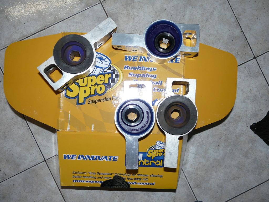

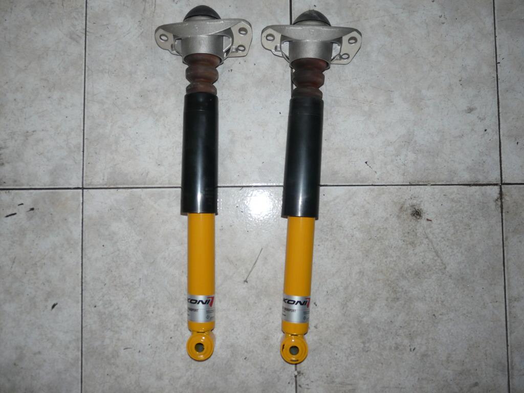

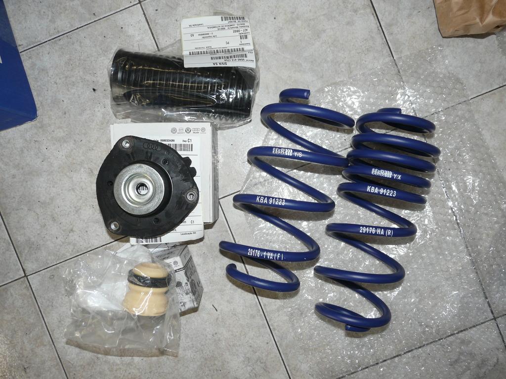

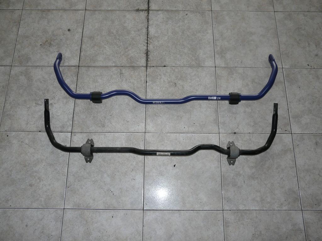

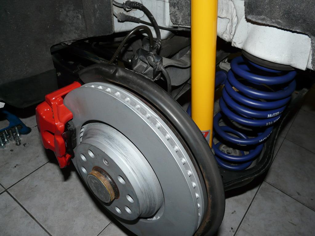

My mechanic sent me the some pictures of the work done so far. He's 200 miles away so it's not easy to go there just to check how things are going. :smiley:

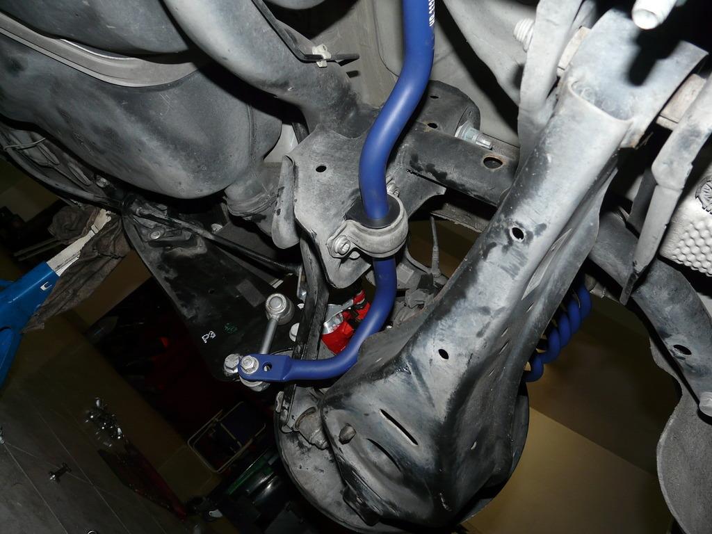

H&R sway bar vs OEM:

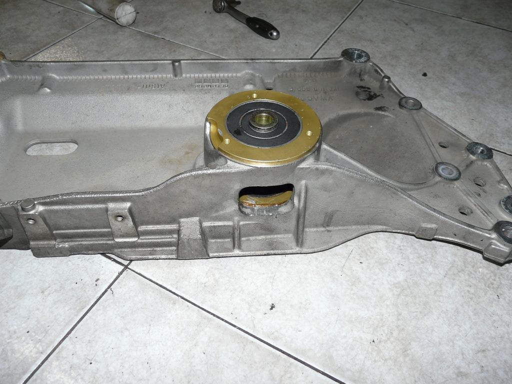

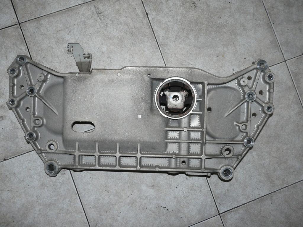

Powerflex rear bush of the front suspension control arm to be replaced by the SALK:

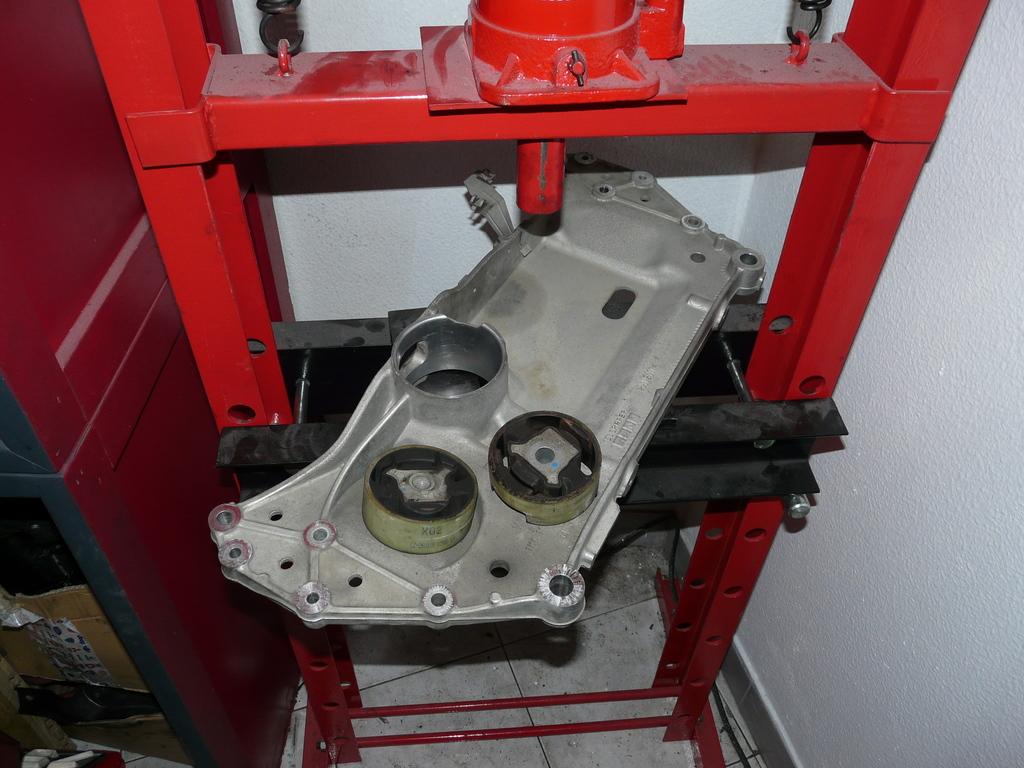

Vibra-Technics engine mount bush (2nd hand from @DanGB) to replace the Powerflex one I got when I bought the BCS exhaust:

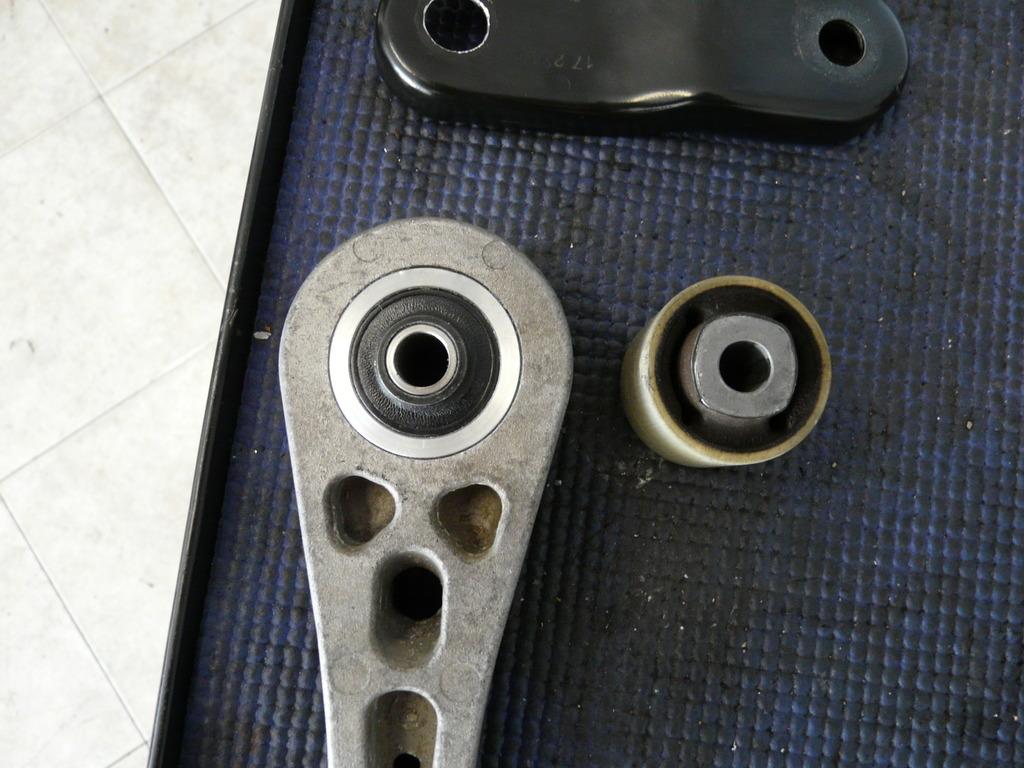

Vibra-Technics dogbone bush vs OEM:

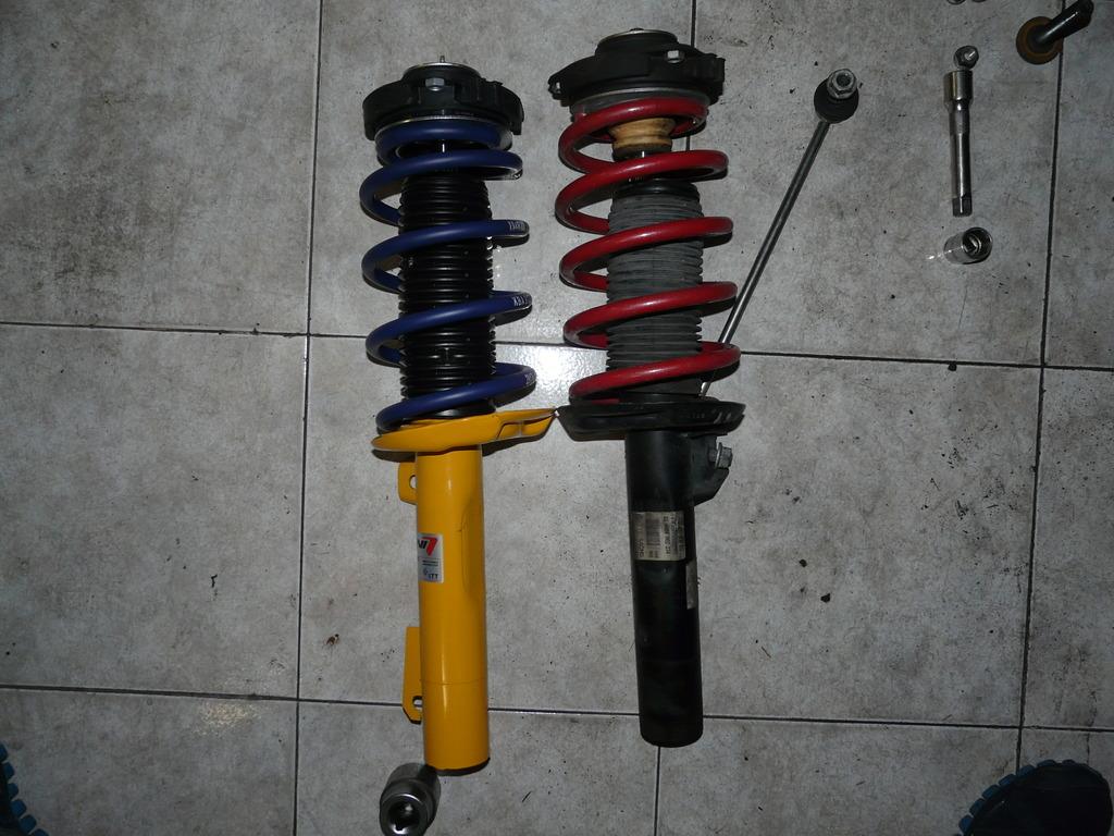

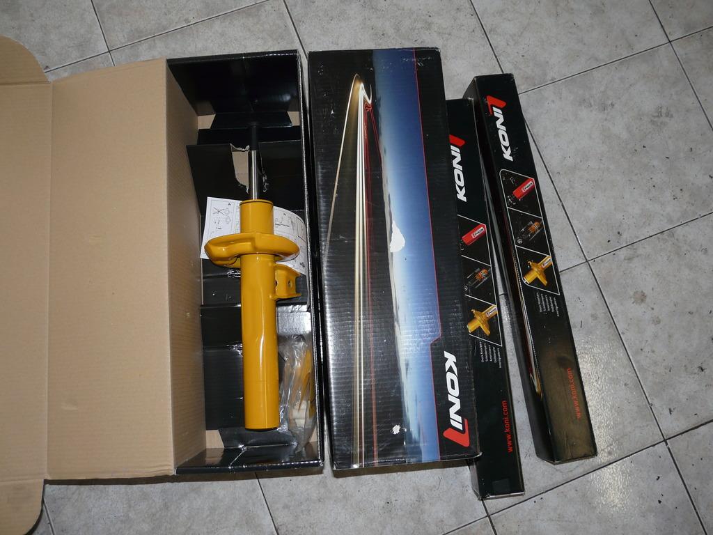

Koni Sport dampers:
H&R Sport springs with the TT/RS3 top mounts and other small bits:
Koni Sport and H&R spring vs OEM damper and Eibach Sportline:

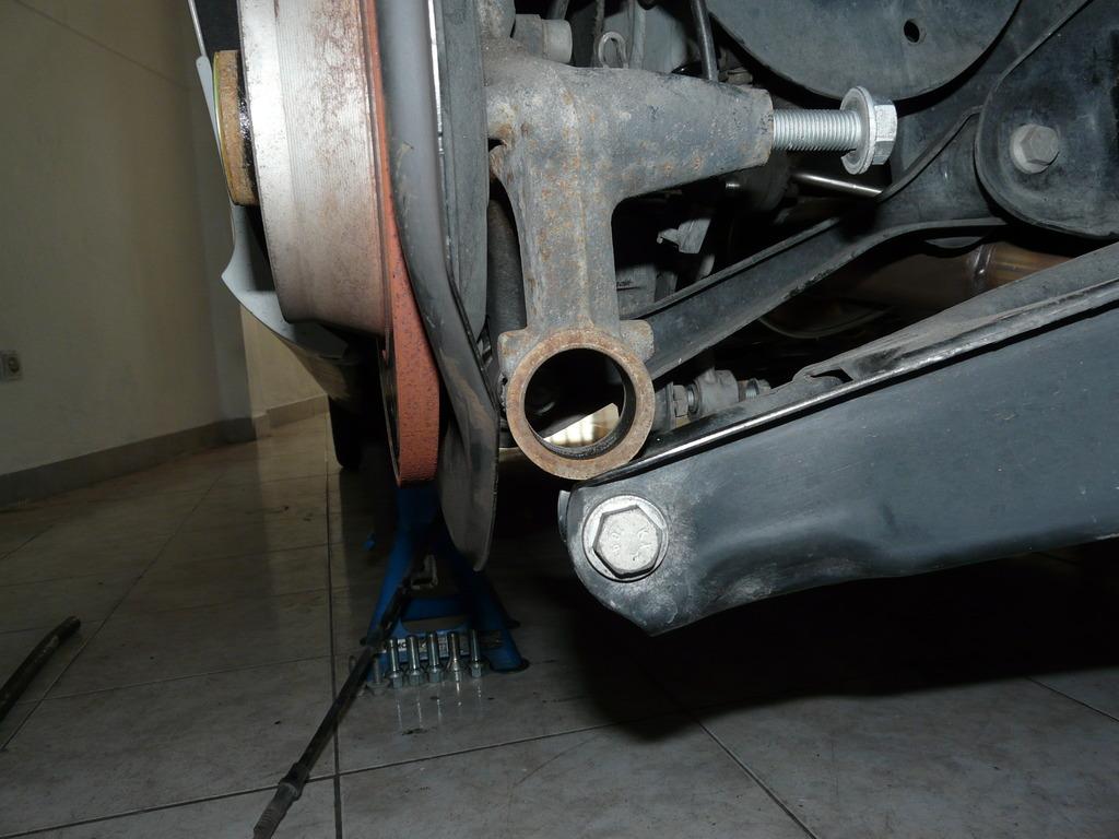

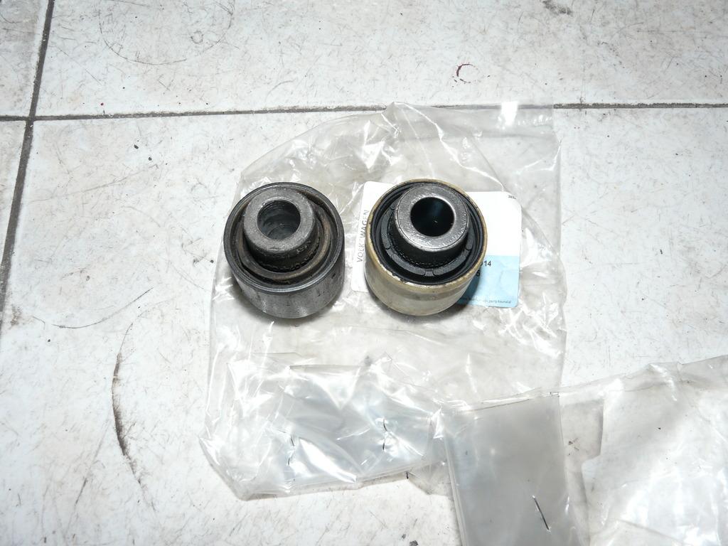

Rear suspension control arm bush replacement:
Old vs New:
Looked in pretty good shape still.

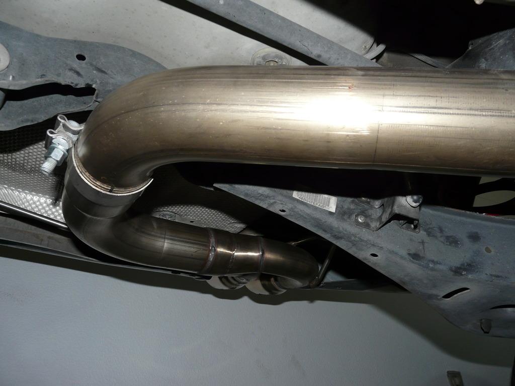

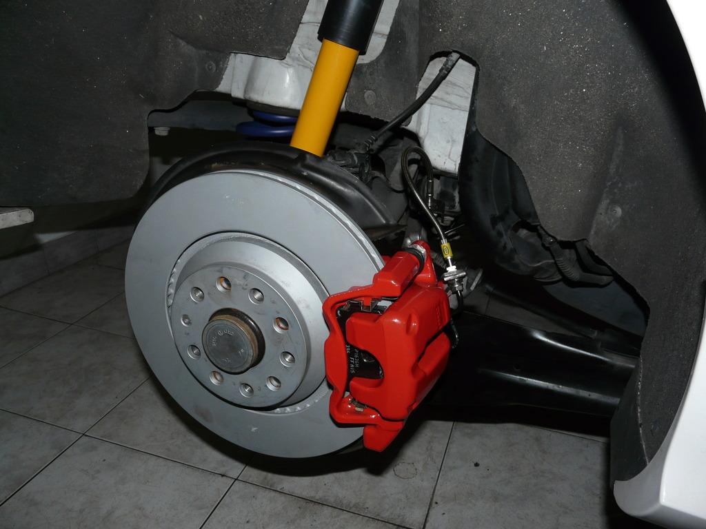

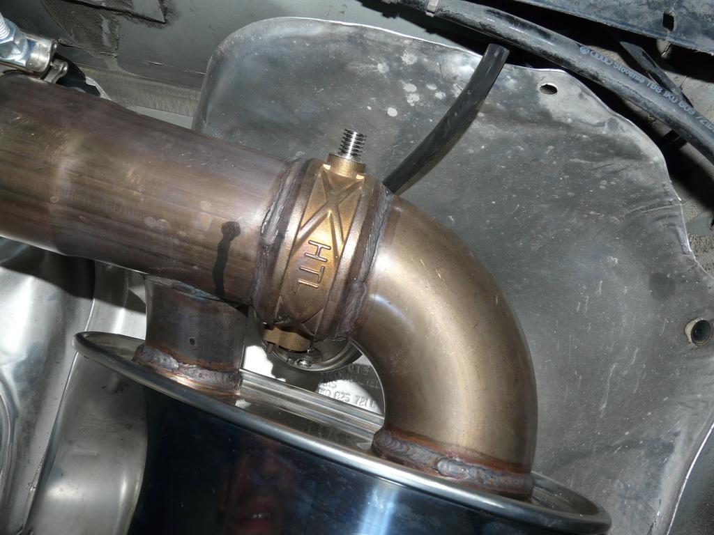

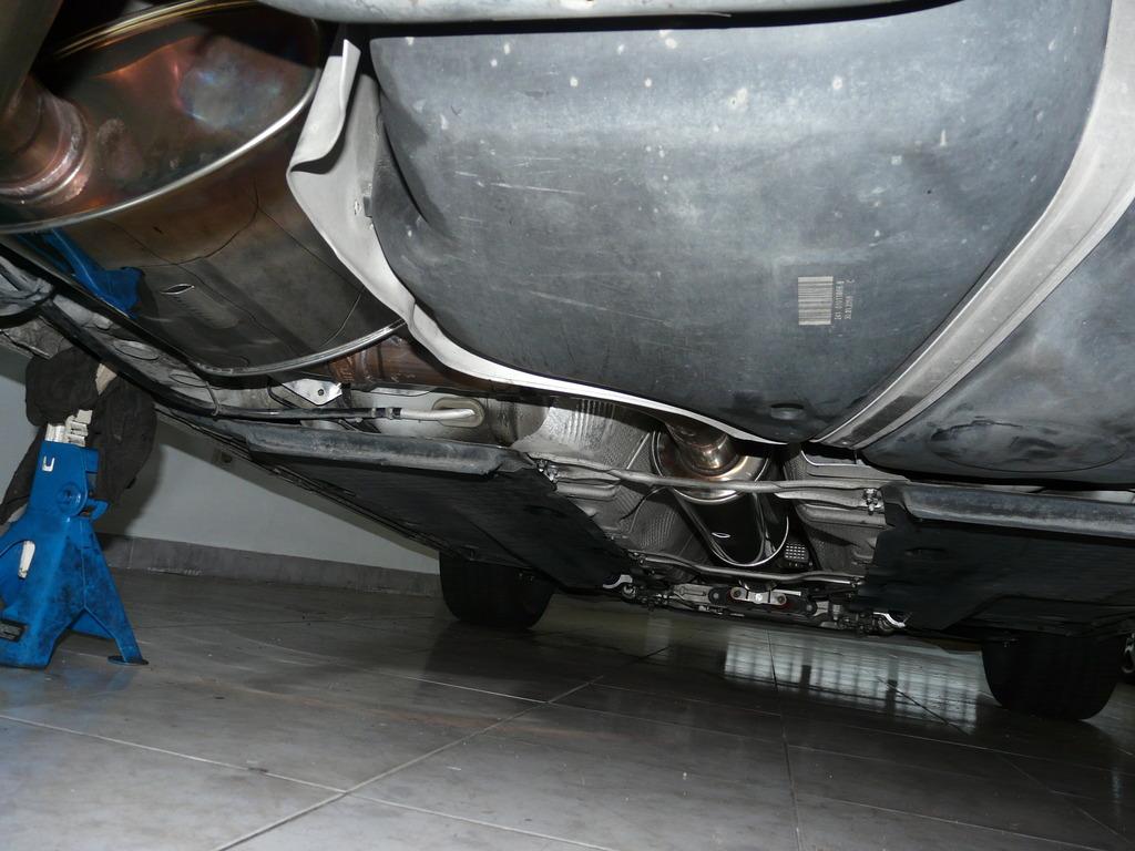

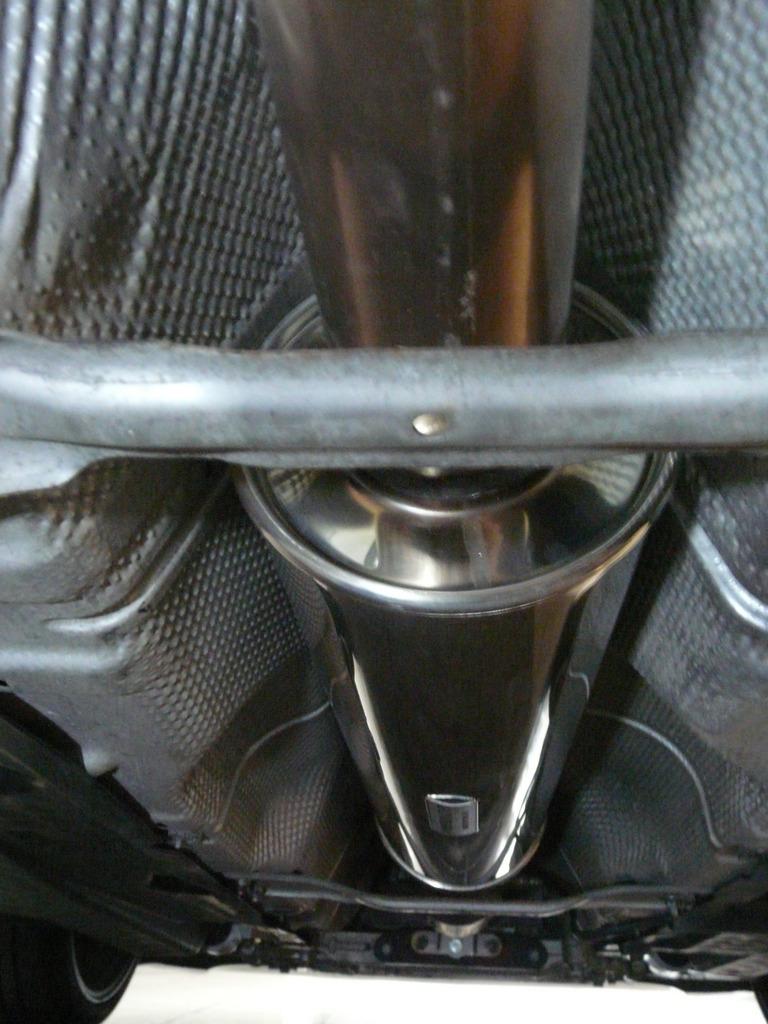

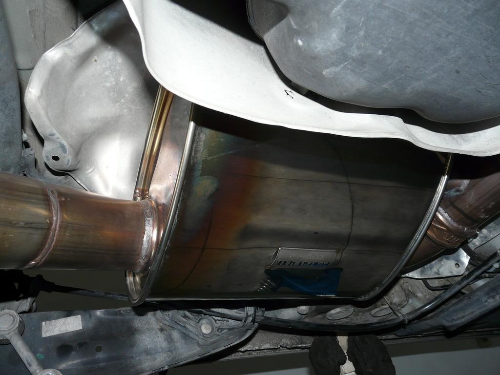

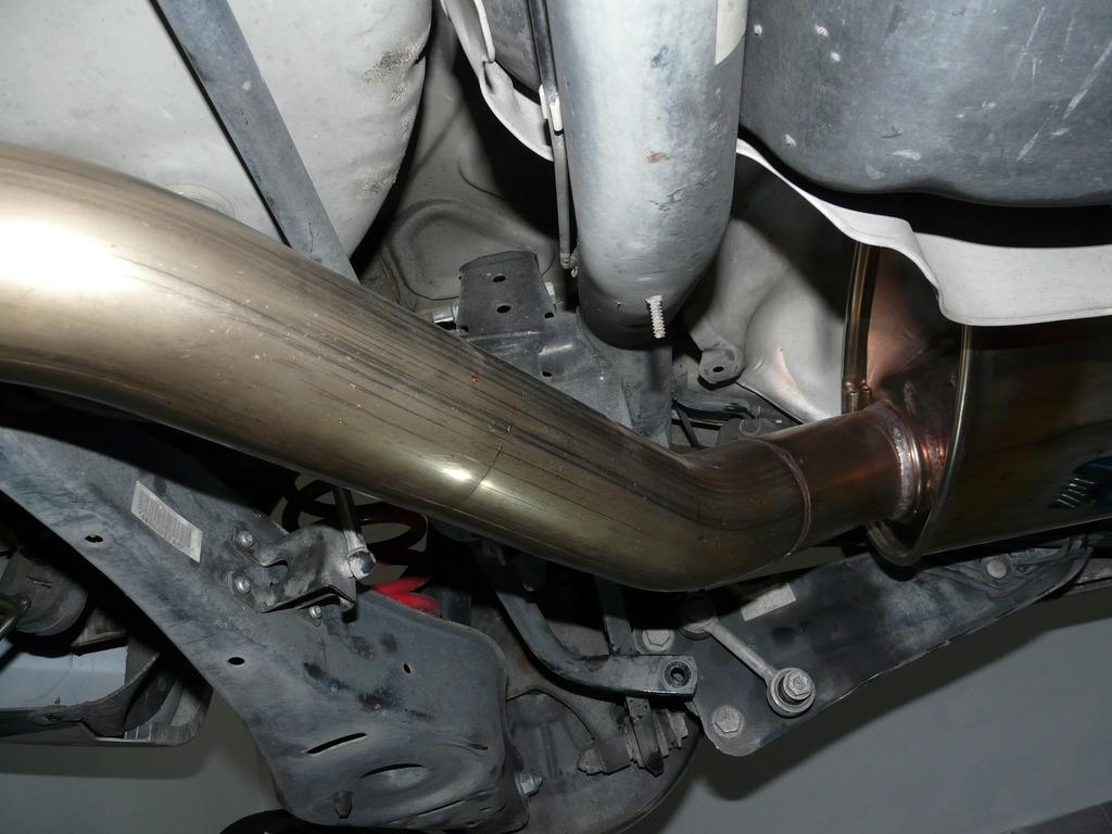

A few pictures of the BCS Powervalve TBE Prestige system with 200 cell cat and wrapped DP:

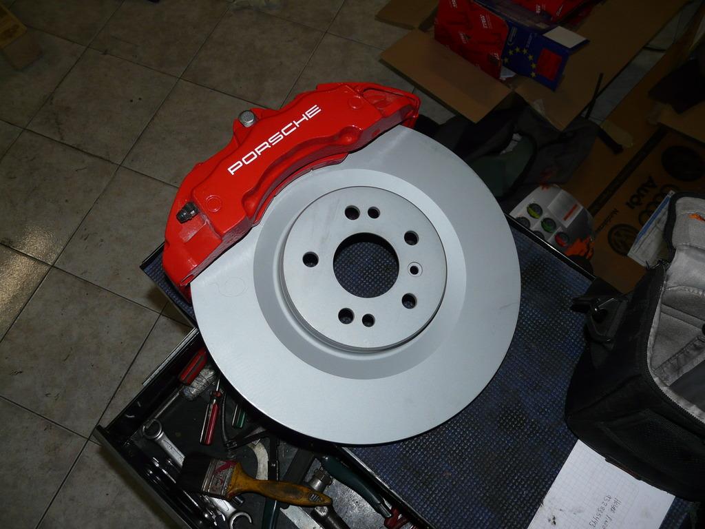

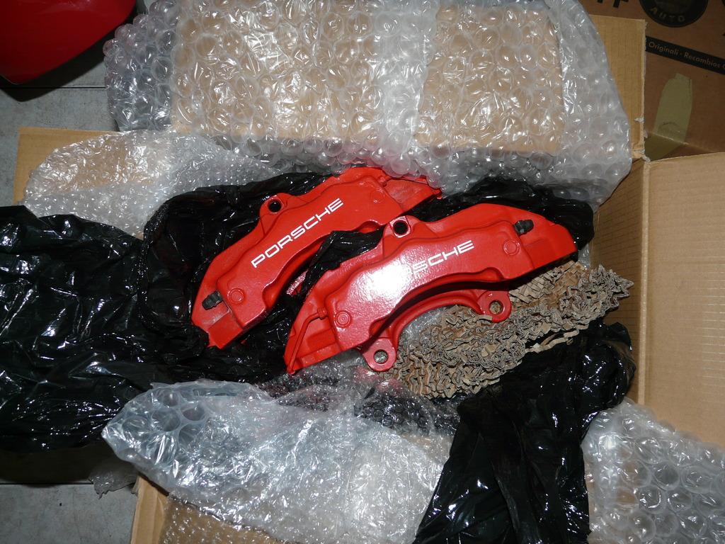

Brembo 18Z calipers to be repainted red and fitted Brembo lettering:

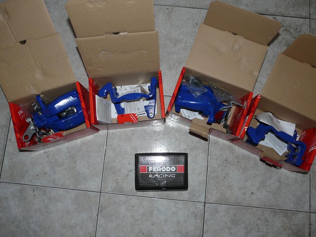

Rear R32 brake setup and Ferodo DS2500 pads:
Painted calipers and carriers:
OEM rear brakes vs R32 brakes:

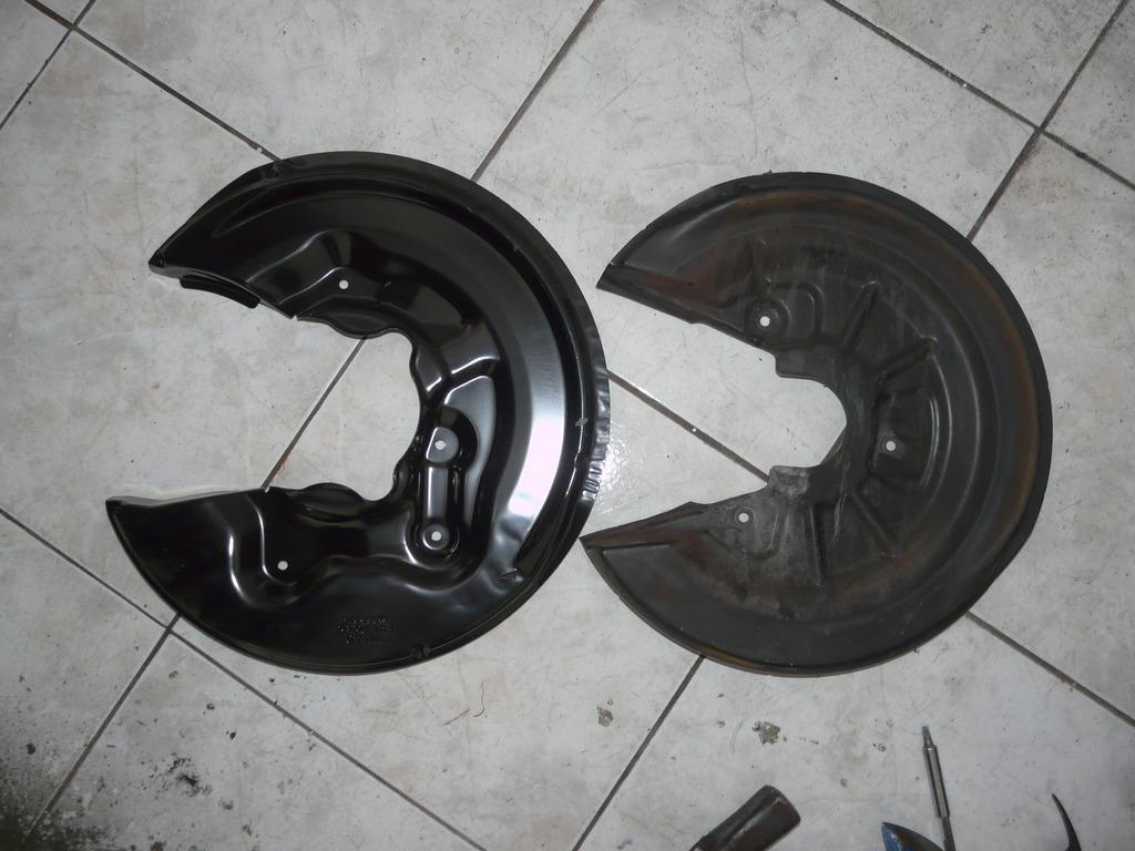

OEM rear spash plate vs R32:
The R32 plates aren't compatible with the GTI's hubs. Fortunately I can return them still.

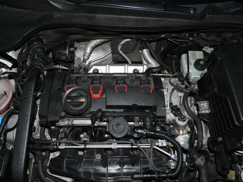

Engine bay before:

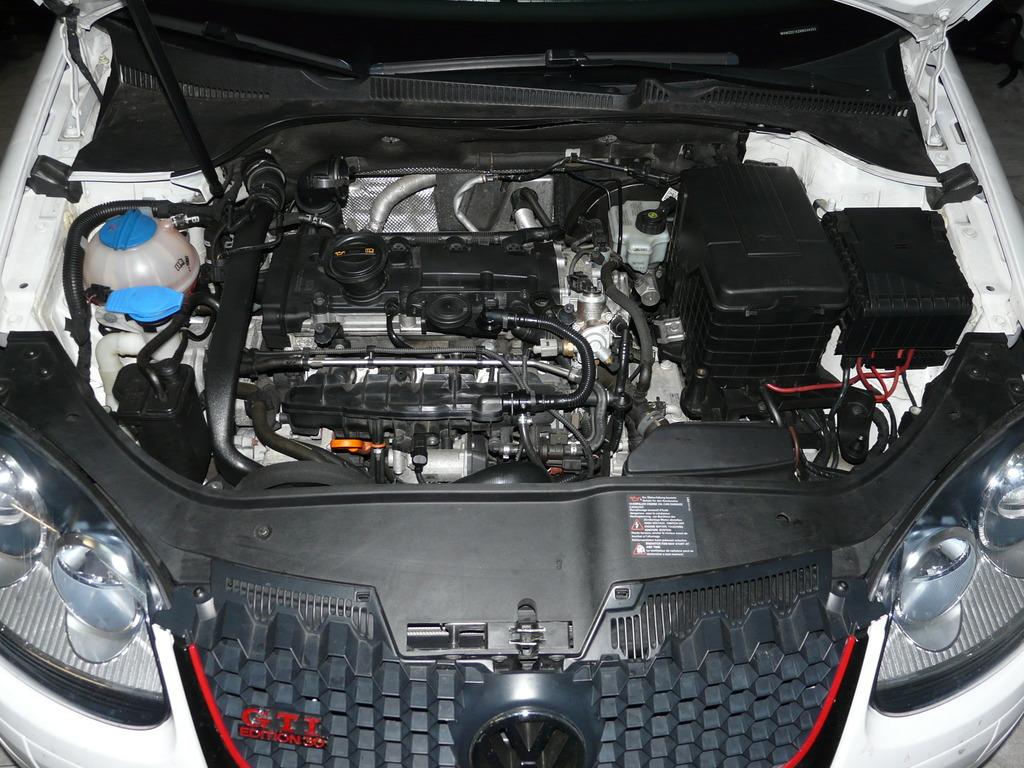

Engine bay after with R8 red ignition coils:

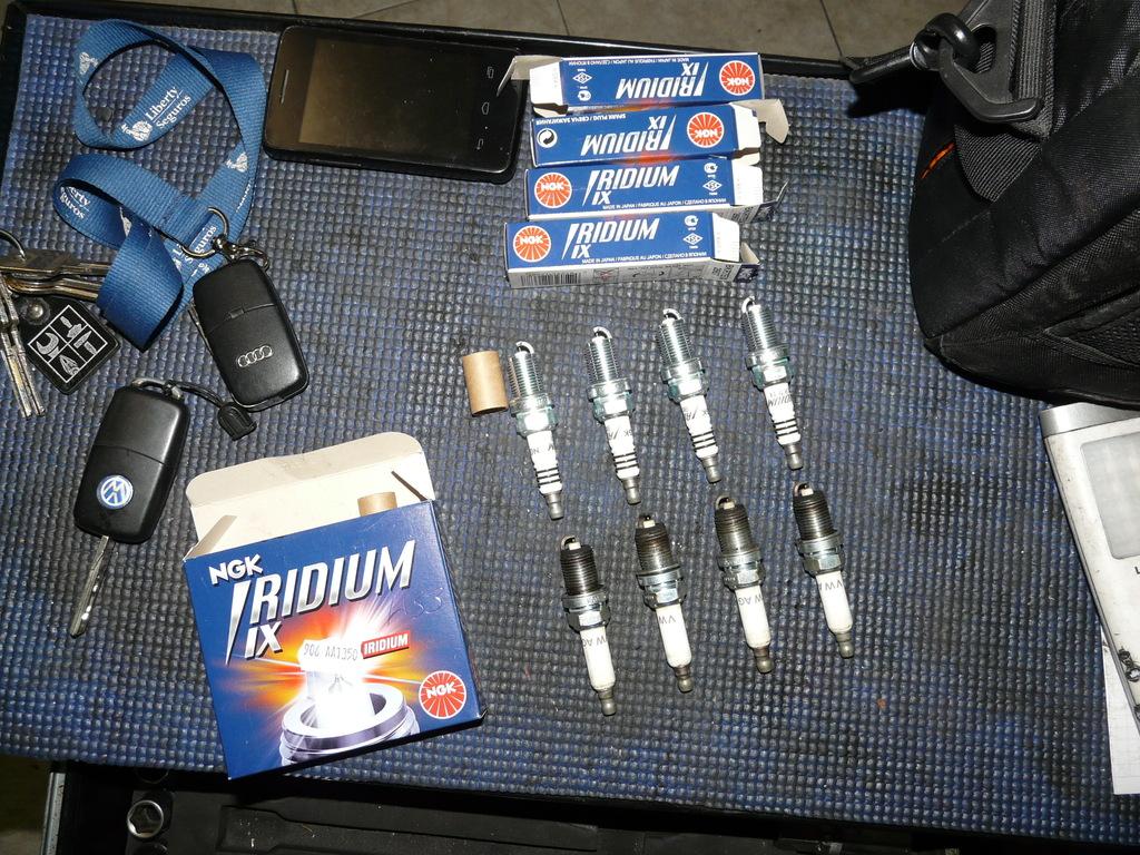

Old OEM spark plugs vs NGK Iridium BKR7EIX spark plugs:

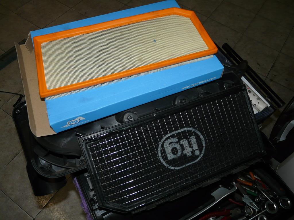

ITG Profilter panel filter fitted:

So just a few more pics. I'm still waiting to receive pics with the front brakes fitted. :smiley:

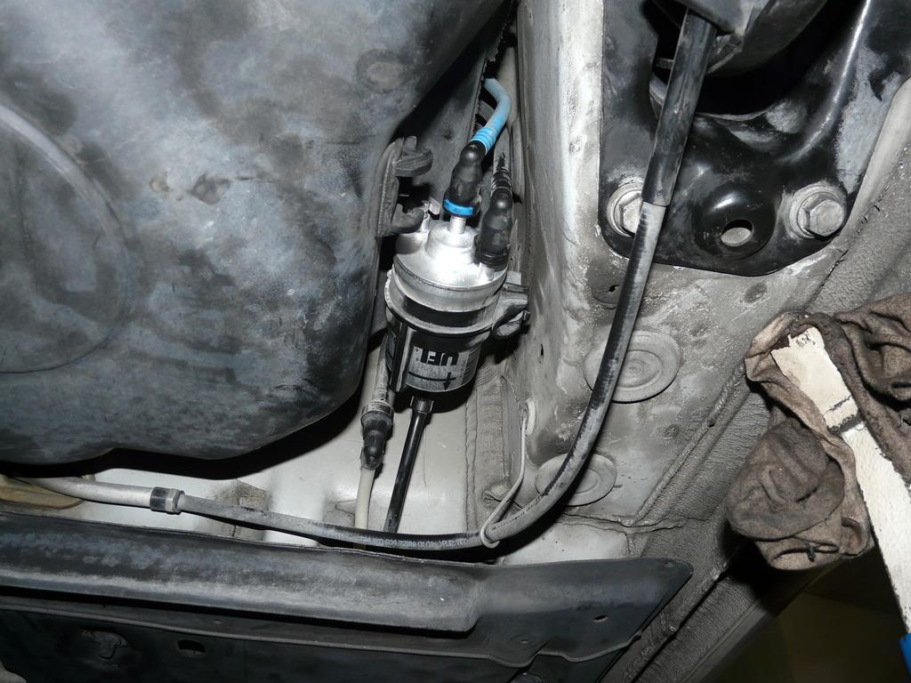

6,6 bar fuel filter fitted (1K0201051K):
I went for the smaller sway bars (26/22 mm) as this will be my daily drive and I've read better reviews for these.
H&R rear sway bar 22 mm:

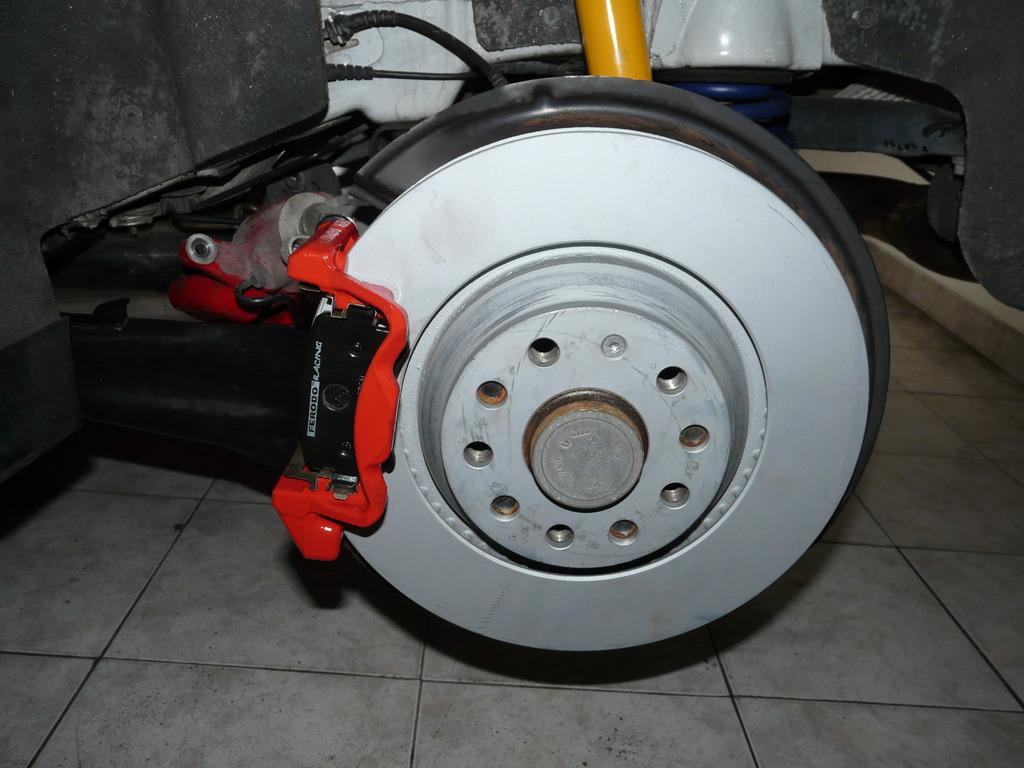

R32 rear brakes with HEL braided brake lines:

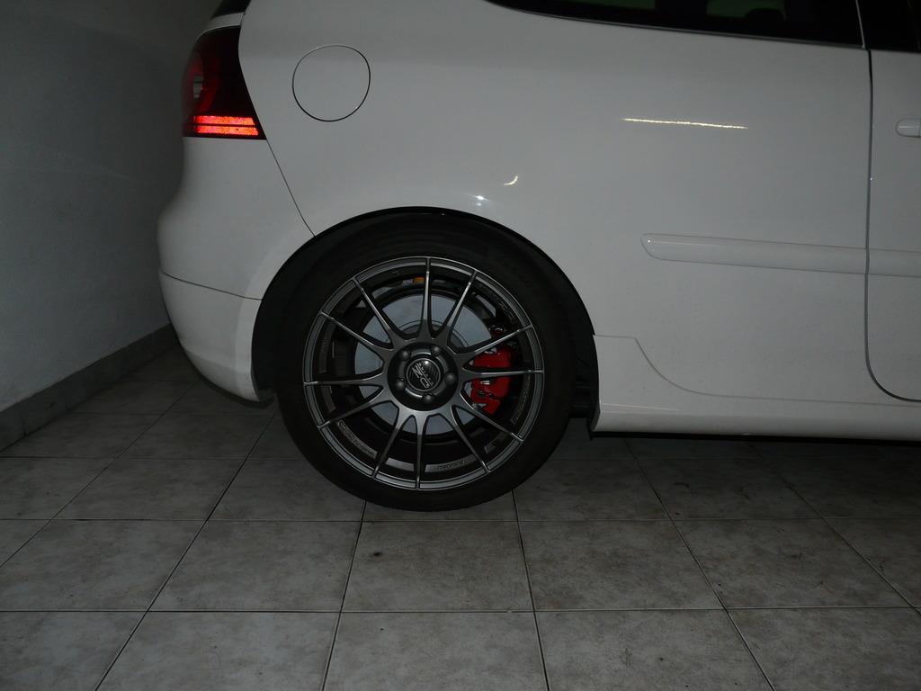

Final result:
I hope I have more to share soon. :smiley:

It looks very good, but I personally think the best pair of sways is 26/24 mm.

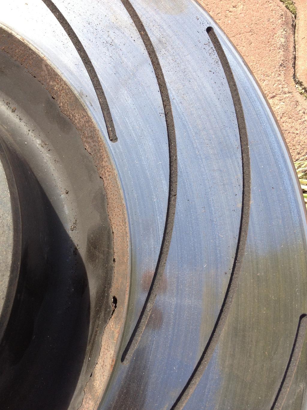

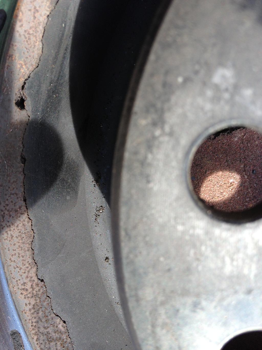

Please remember to do a proper bed in for the brakes. This has happened to me before, and they told me it was my fault because I didn't follow the bed in procedure exactly:
Thanks. The pair you mentioned isn't sold as a kit. Can you get the sway bars separately? It's either 28/24 mm or 26/22 mm. :confused:

You're right, they're not sold as pair, but you cam get them separately. ;)

I'll keep an eye out for the 24 mm RARB in the 2nd hand market. I haven't found any at the moment in ebay, just the front 26 mm ARB.
