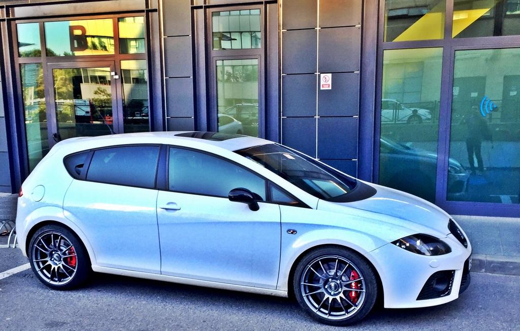

I'm Teo from Bucharest, Romania and this is my ride:
Seat Leon Cupra MK2 2008

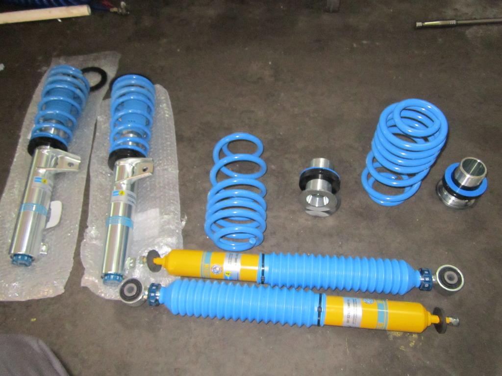

Bilstein B16 PSS10 coilovers

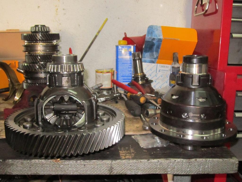

Wavetrac LSD

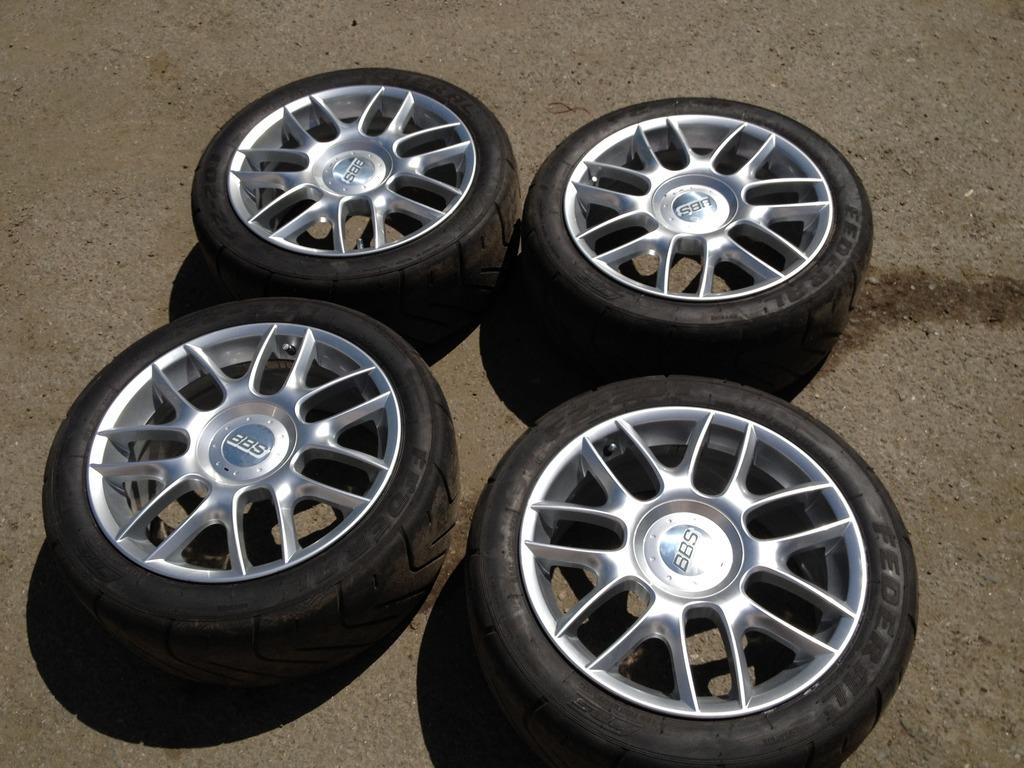

OEM Cupra Orion 18" 7.5J ET51 + Dmack Trackday 225/40/18 Tyres
OEM Seat Leon FR ALHIOTH 17" 7J ET54 wheels + Federal FZ 201 225/45/17 semislicks
BBS VZ032 17" 8J ET50 wheels + Federal FZ 201 225/45/17 semislicks
OZ Ultraleggera 18" 8J ET35 matt black wheels

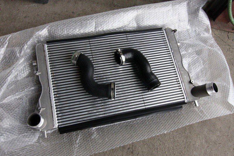

The first one was the S3 intercooler, full aluminium, larger then the stock (gti) one:

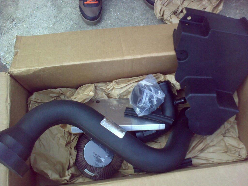

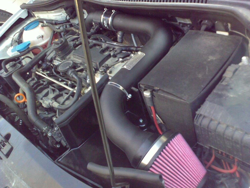

Then came the cold air intake, I choose EVO-MS for the WRC like sound and the good reviews at the time:

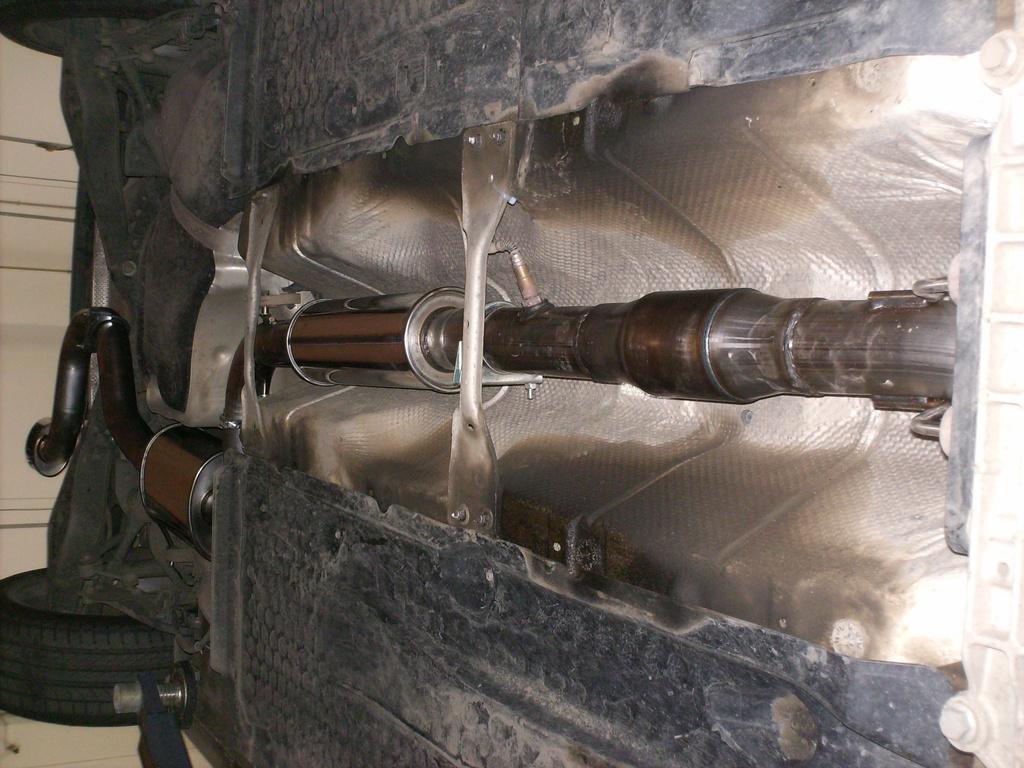

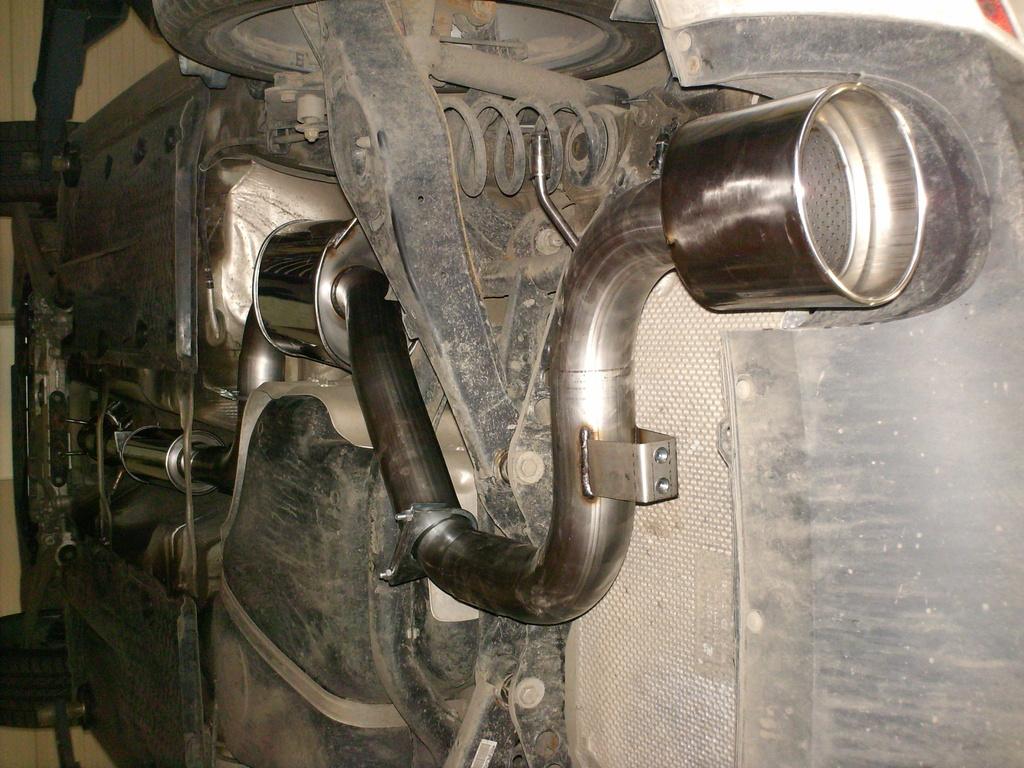

Got the Blueflame exhaust, 3", 100 cel catalyst (later de-cat):

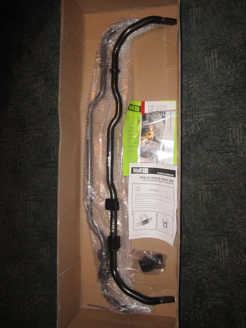

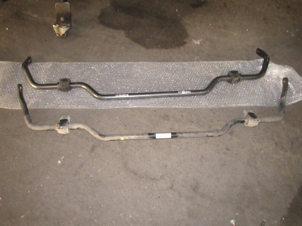

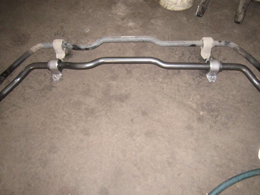

...and for anti roll bars - H&R 26mm front, 24mm rear:

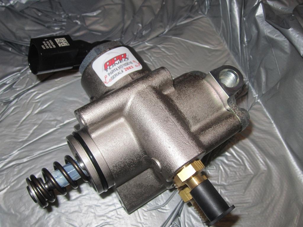

...i decided i needed more power  :signLOL: - APR high pressure fuel pump:

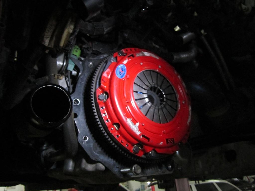

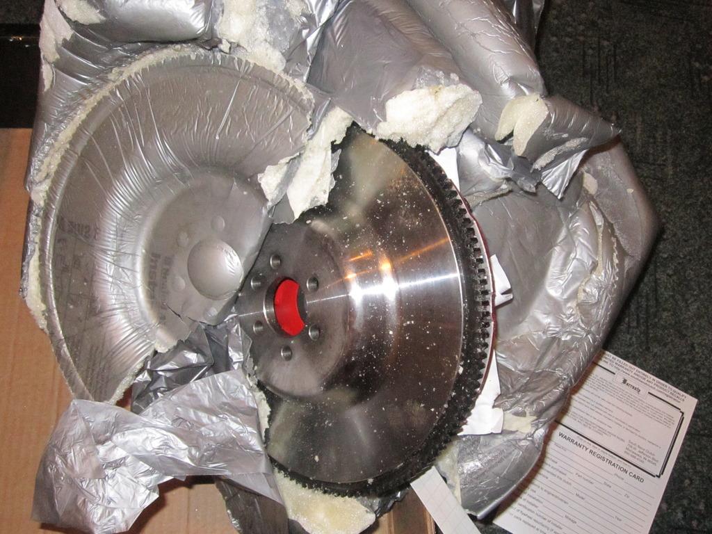

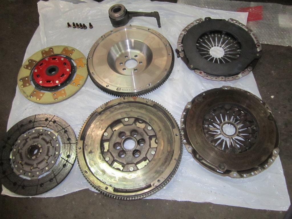

...and the clutch couldn't take it...so I have bought Southbend Stage 3 Endurance + SMF:

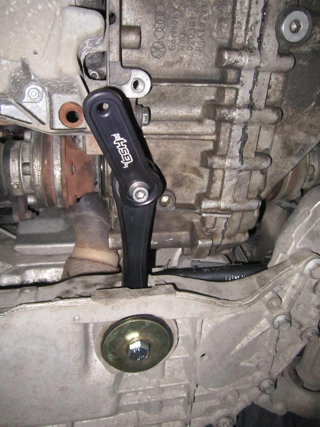

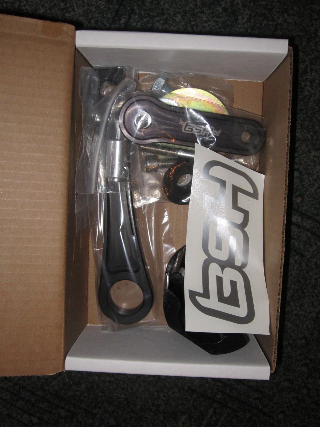

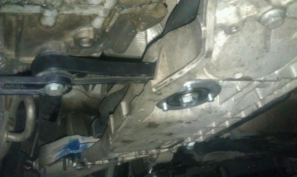

Then I had upgraded the dogbone + mount insert with the ones from BSH:

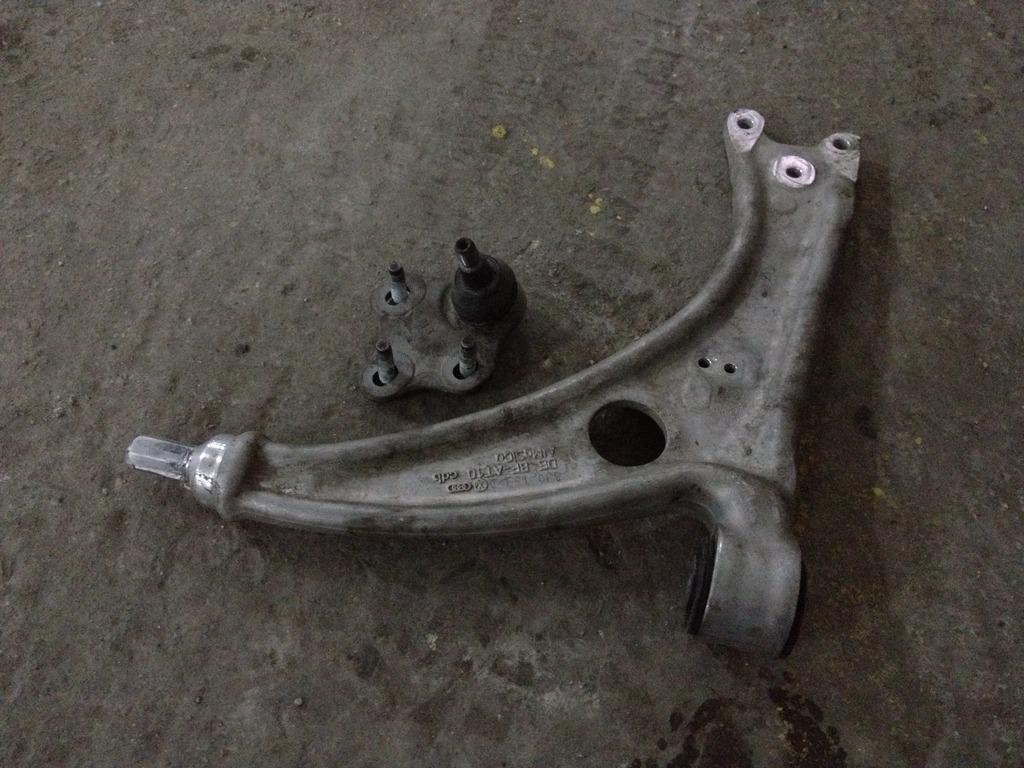

I've found some cheap used TT lower arms (it proved to be one of the best upgrades that I've ever made). Because of the negative camber everything changed, superb steering feel, greatly reduced understeer:

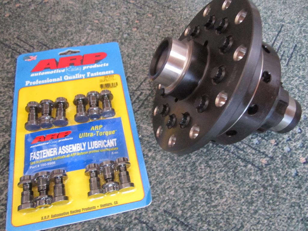

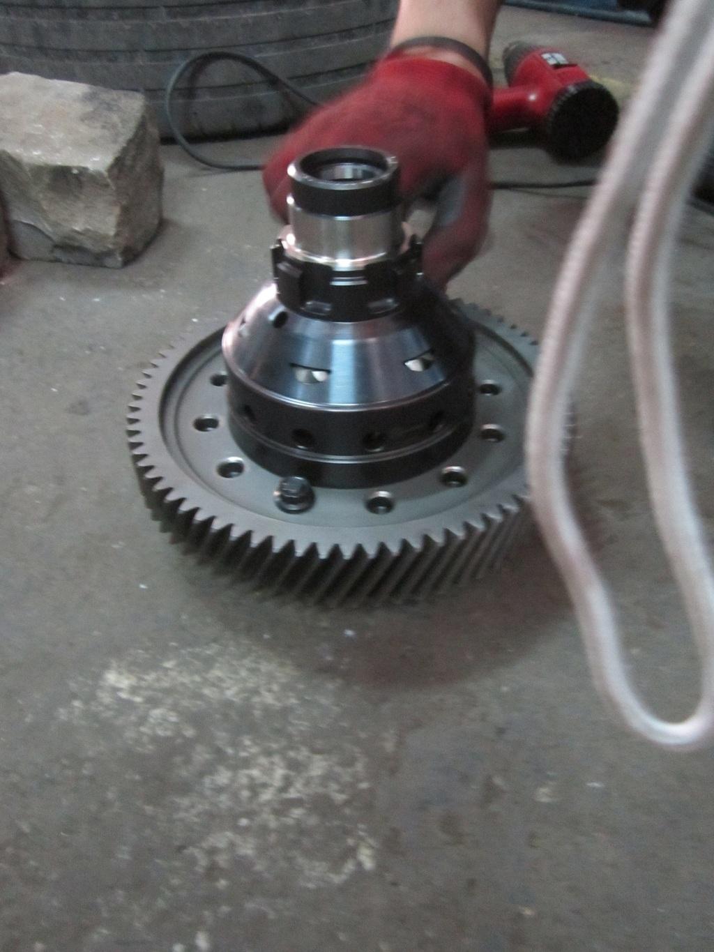

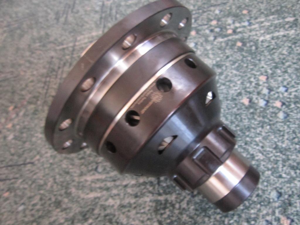

Then I got my Wavetrack LSD:

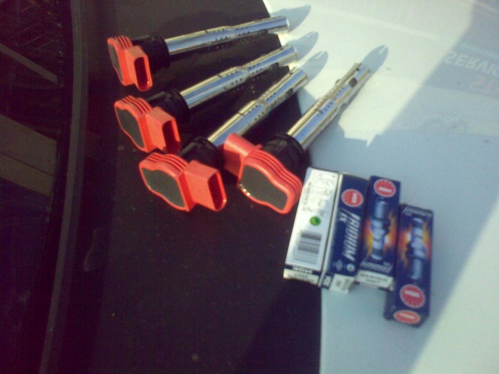

Installed new coils and plugs (NGK Iridium BKR8EIX):

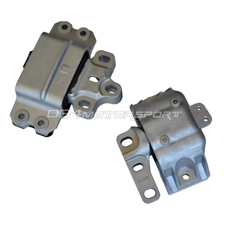

Then I had to change the lower mount to Vibratechnics and motor + gearbox to 034 density line - (no real picture) to eliminate the wheel hop:

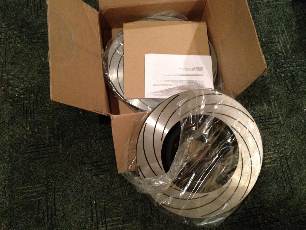

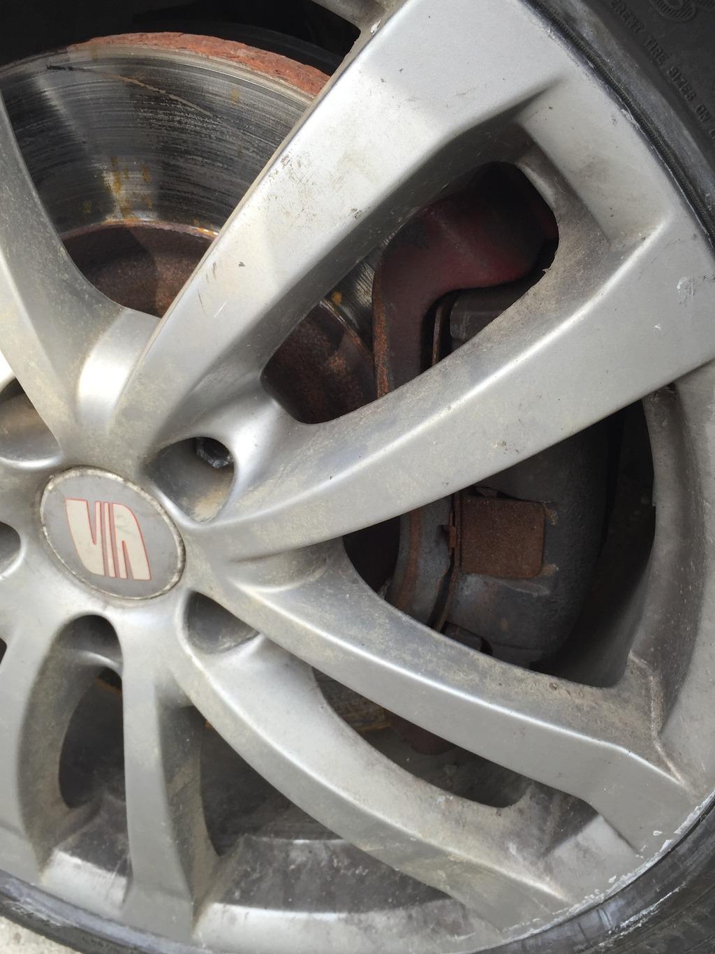

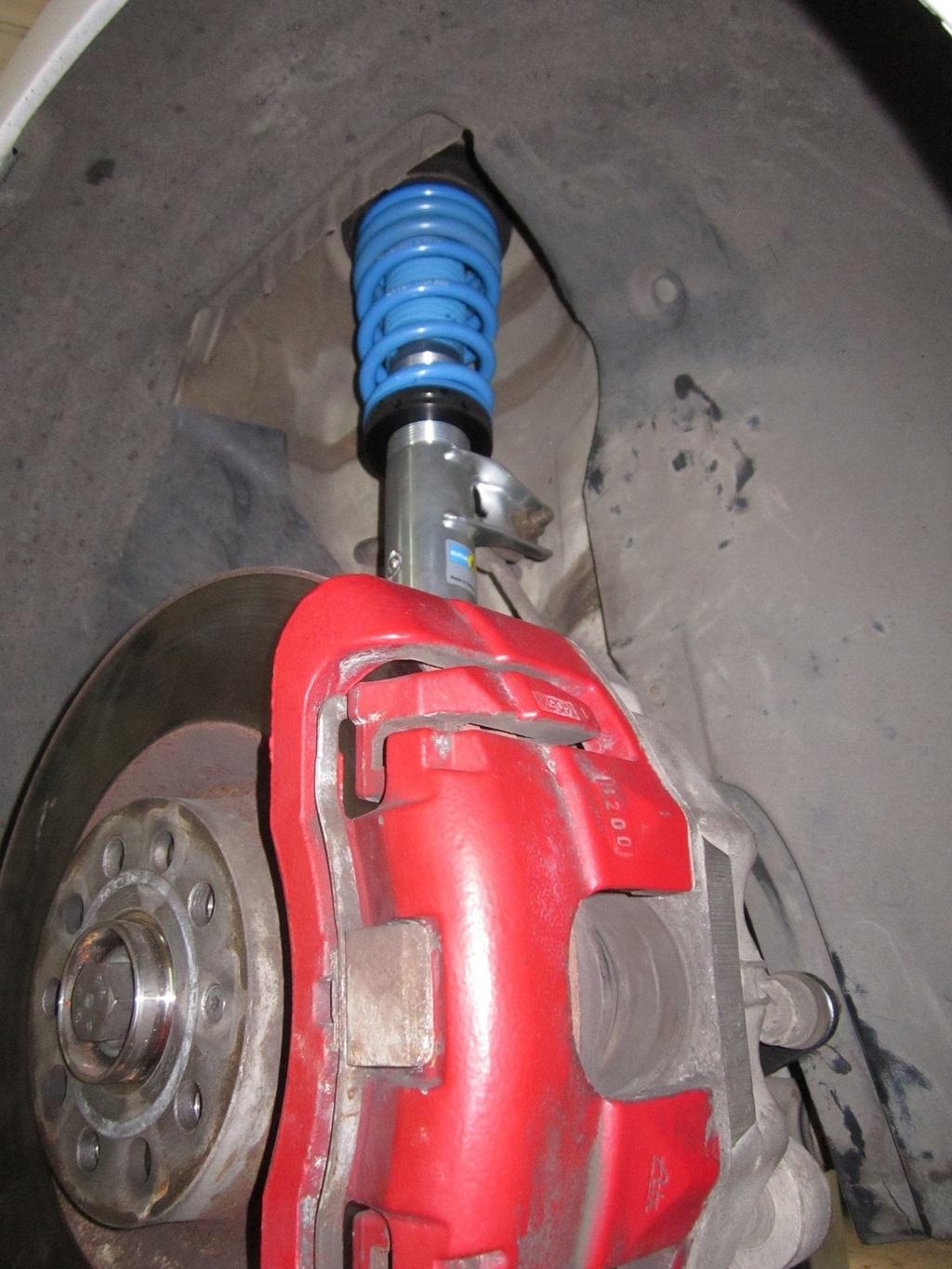

Then the endless problem with braking overheating begun - at first I have upgraded the front with Tarox F2000 discs and Carbotech RP2 and rear with DS2500 brake pads:

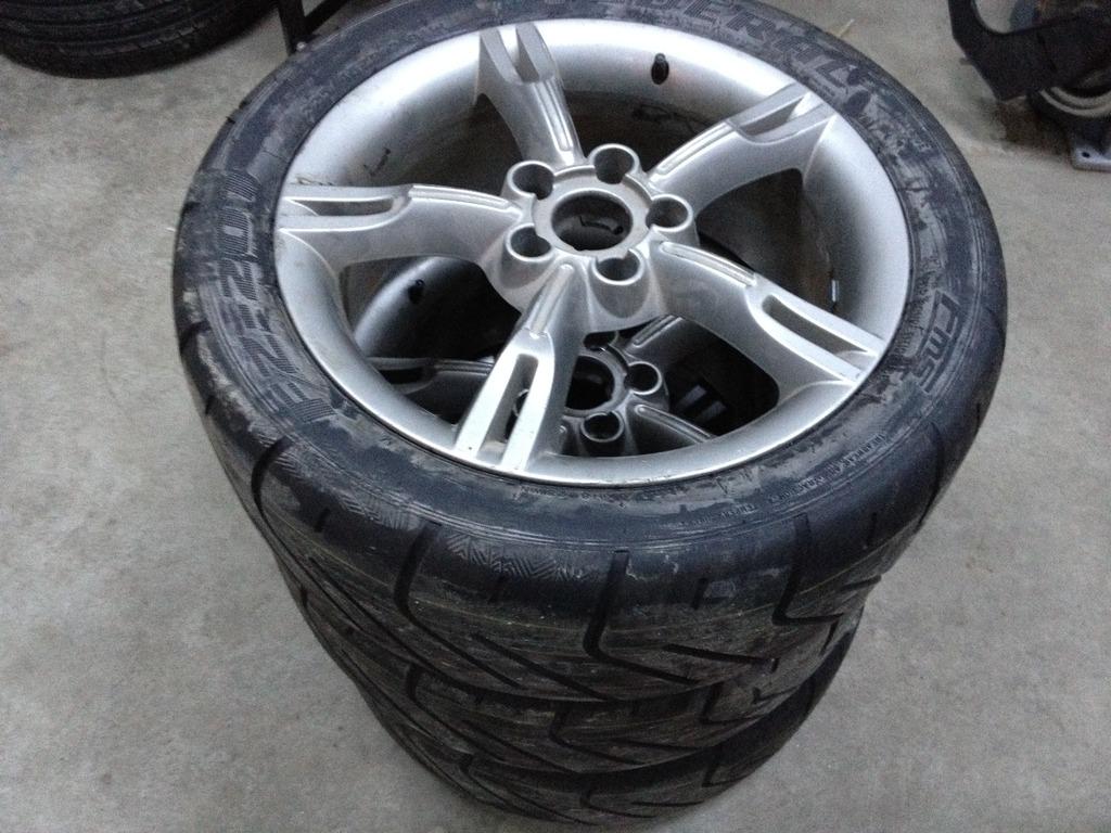

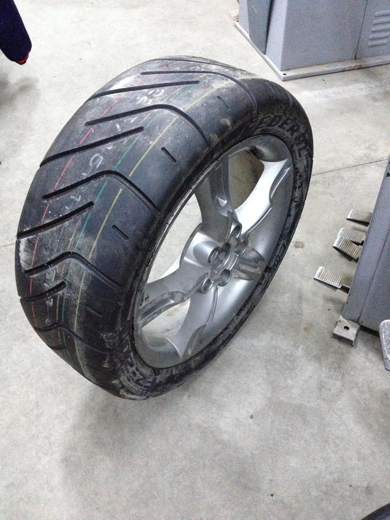

...then the trackday wheels OEM Seat Leon FR 7J + Federal FZ 201 semislicks (which were too close to the brakes):

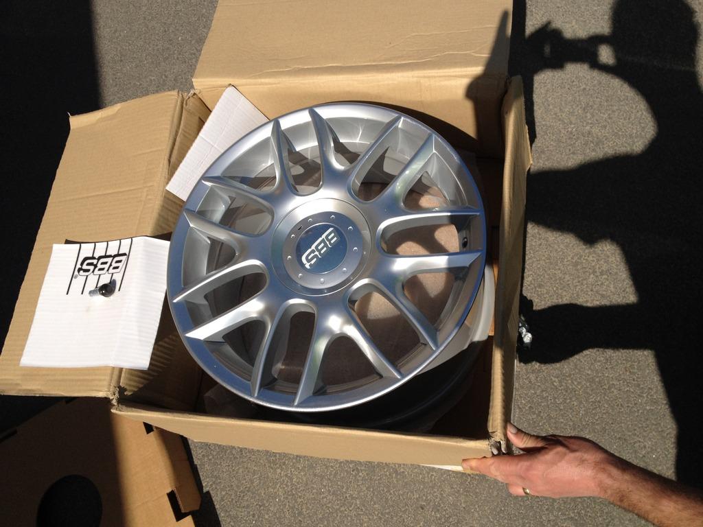

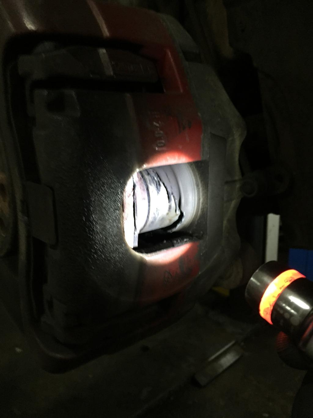

Because they were 7J (no brake clearance - or so I thought at the time) I boiled the brake fluid at my first trackday after upgrading and cracked one disc...so I've decided to change them with these (BBS VZ 032 8J):
Same thing happened, everything cooked again, calipers, pads, fluid:

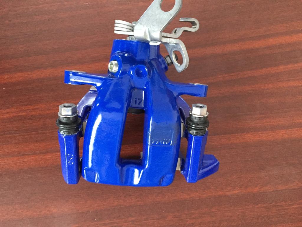

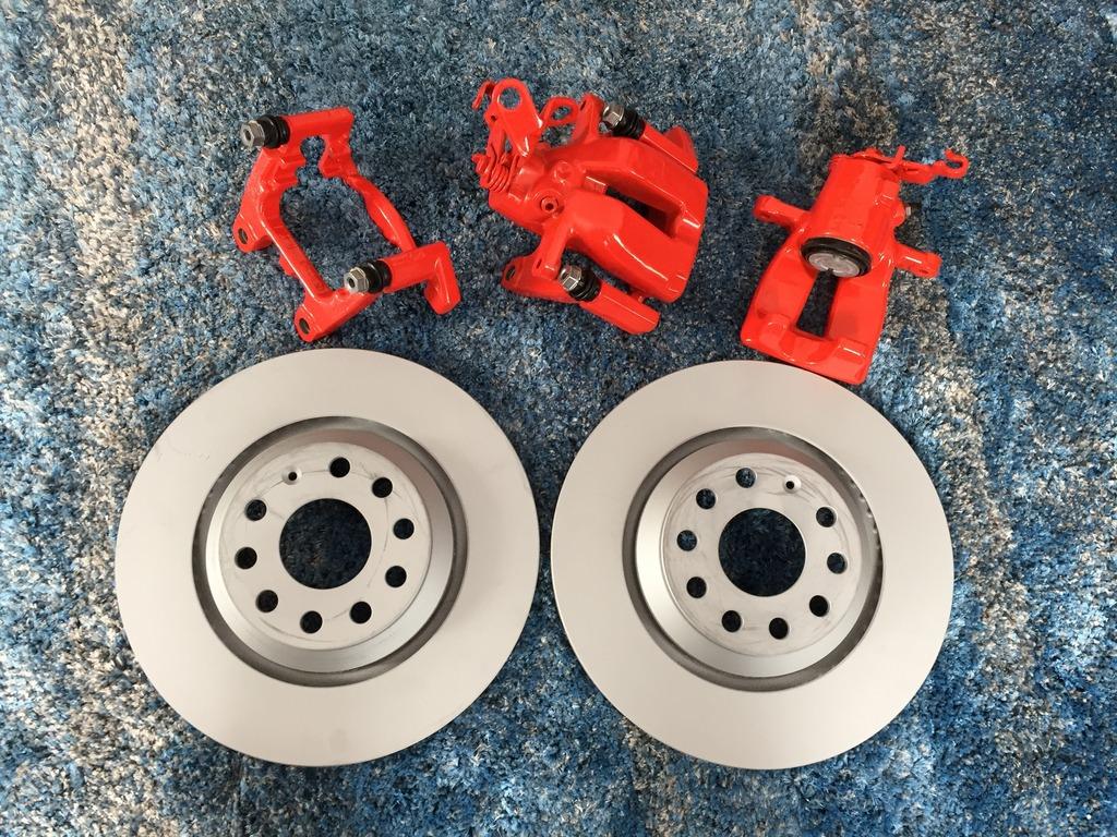

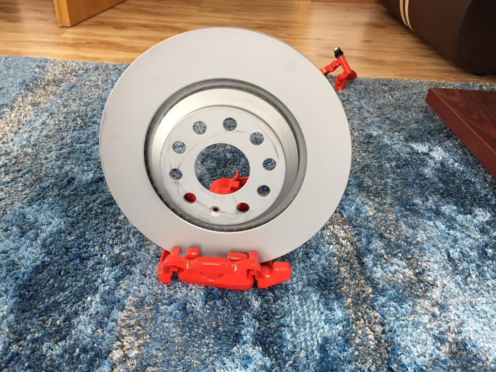

I've received the rear brakes to S3/R32 310mm and I've sent them for a paint job so they will match with the AP Racing BBK that I've ordered:
I really hope the new ventilated rear rotors will help with the heat dissipation, otherwise it is just added weight, front's do all the braking.

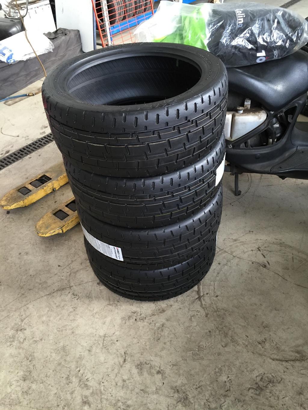

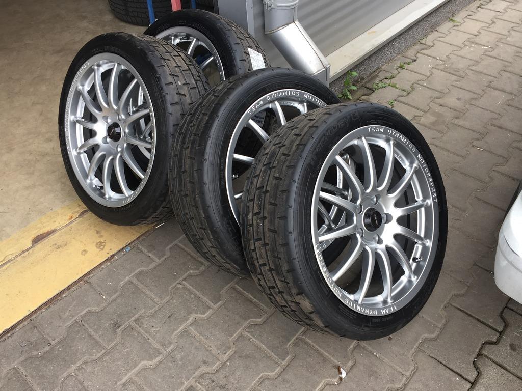

The tyres are here:
They are DMAK Trackday tyres, never used them before, I will see what they can do. They have kevlar sidewall, I've never seen anything harder
Now I still have to wait 2 weeks for the wheels and 7 for the BBK.

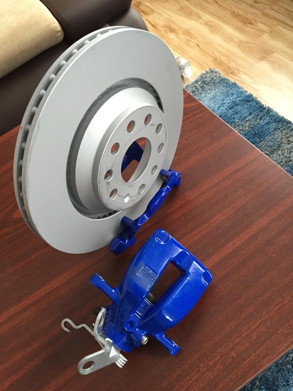

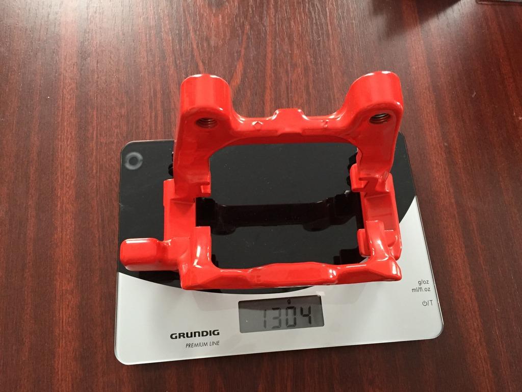

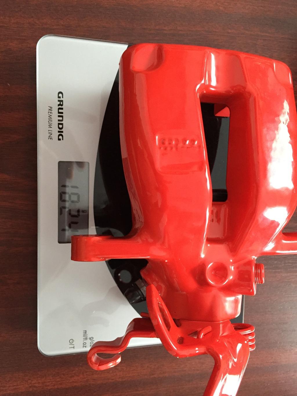

Yesterday I got the rear calipers powder-coated:
If they don't help with the cooling, it is just added weight:
Caliper:                1,8 Kg
Caliper Carrier:      1,3 Kg
Rotor:                  6,8 Kg
I still have to find out how much the GTI rear brakes weigh.

Thanks Pete! The BBS are gone now, they were 17" and the new BBK needs minimum 18" wheel.

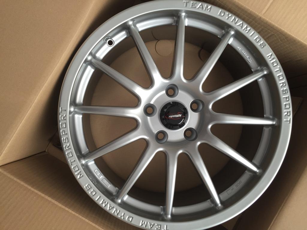

I've ordered TD Pro Race 1.2 8x18. (eta 2 weeks)

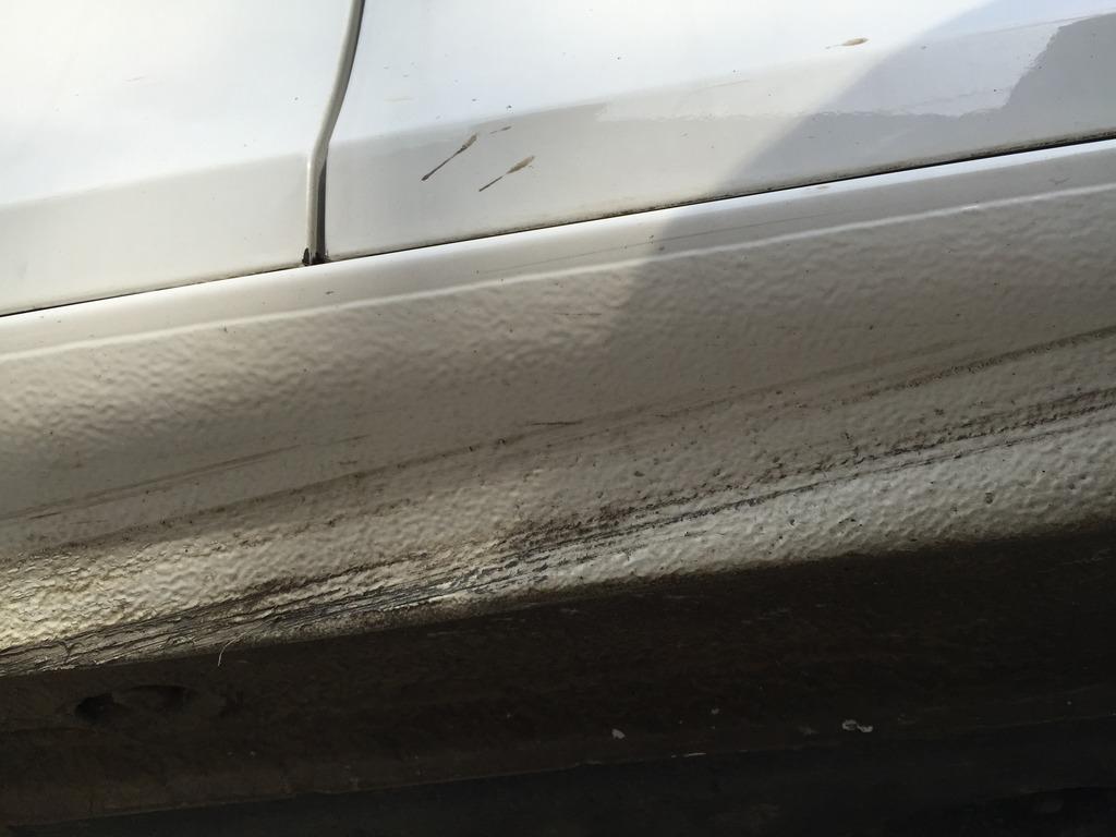

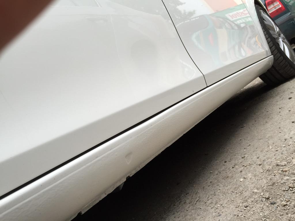

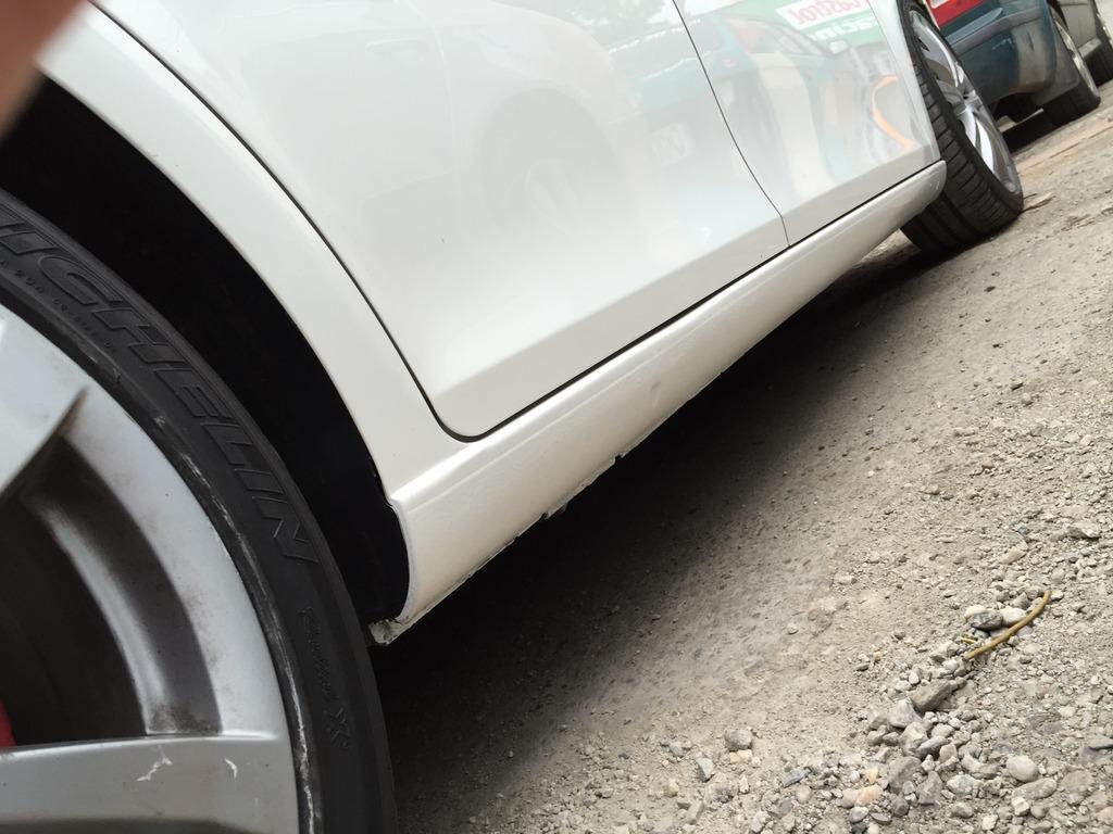

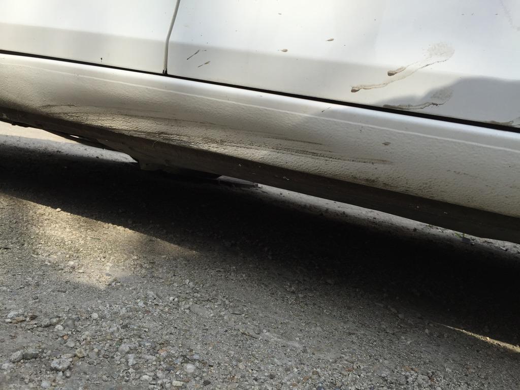

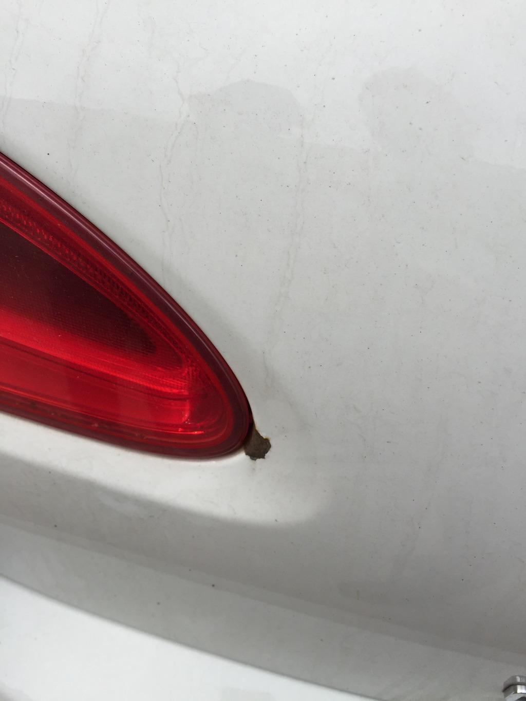

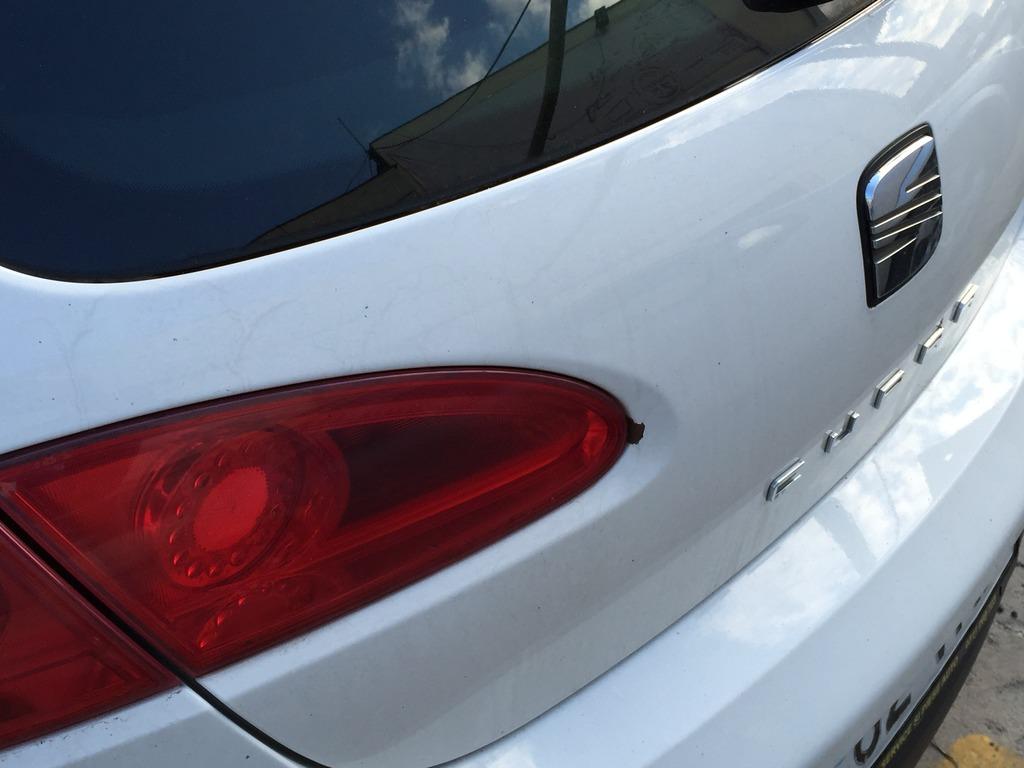

I had to repaint the passenger sill and the tailgate, there were  some old "injuries". I have some before and after pictures.
Before:
After:

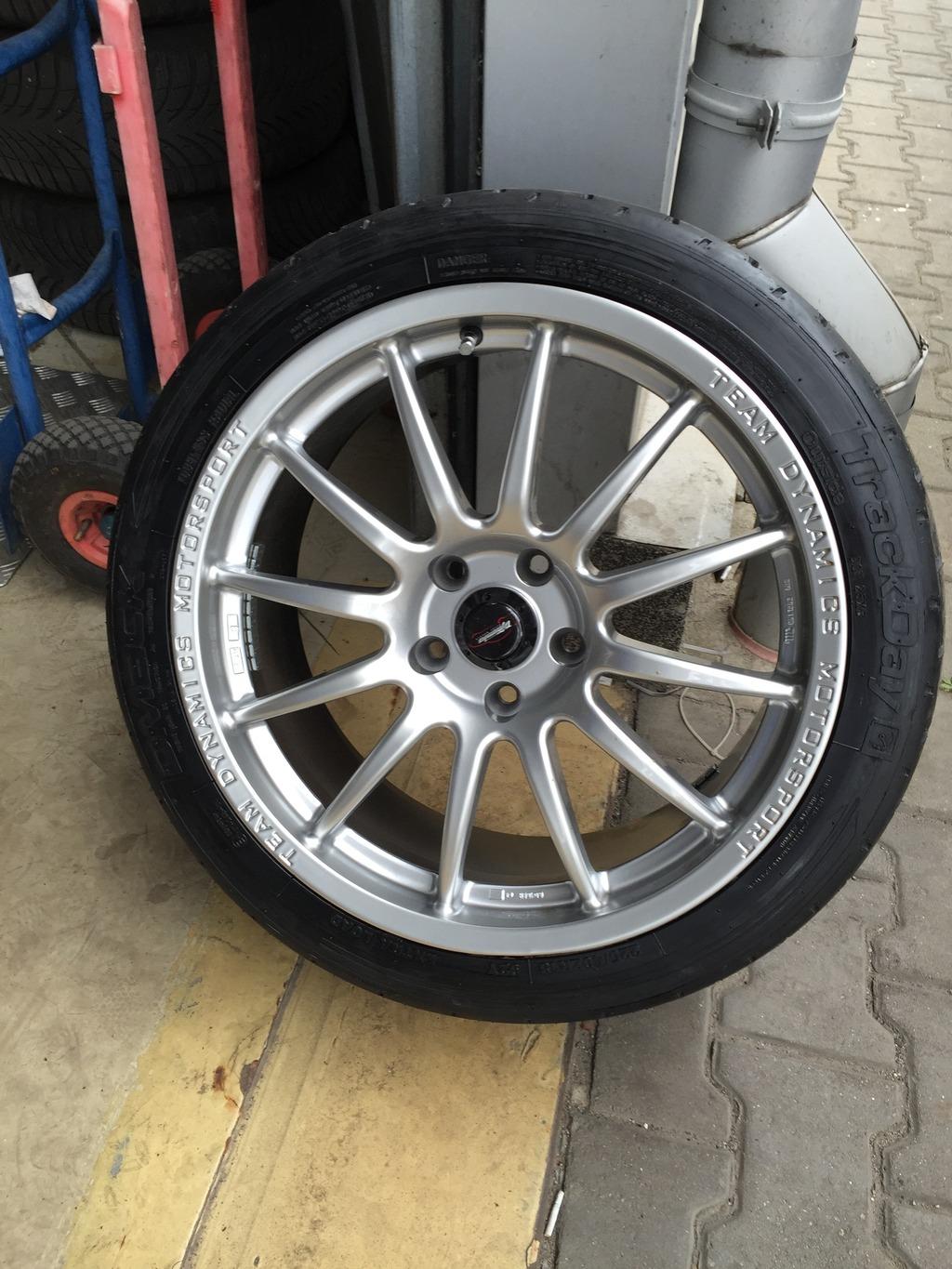

And the new wheels arrived so i put the DMACK's on them. Because of the kevlar sidewall it was a real battle getting then on the rim. After inflating to 9.5 bar, they've given up.
