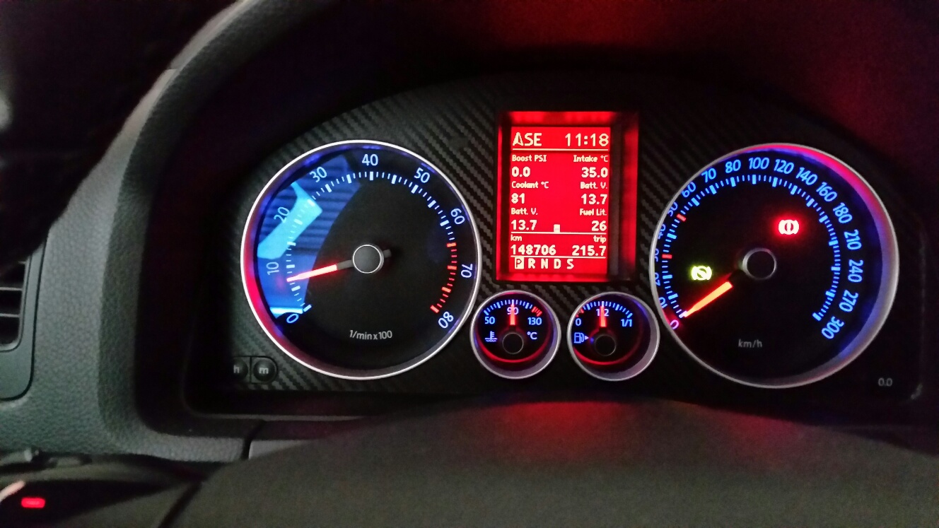

Went for a drive to the next village (16km round trip) the coolant temp on polar fis floated between 69 and 73. As i was pulling into the garage the temperature started to increase the gauge is nearly at 90 and polar fis shows 81.

« Reply #13 on: April 29, 2015, 10:48:44 am »
How do you get that menu up mate  :happy2:
Mk5 Golf....... The Real GTI Reborn
