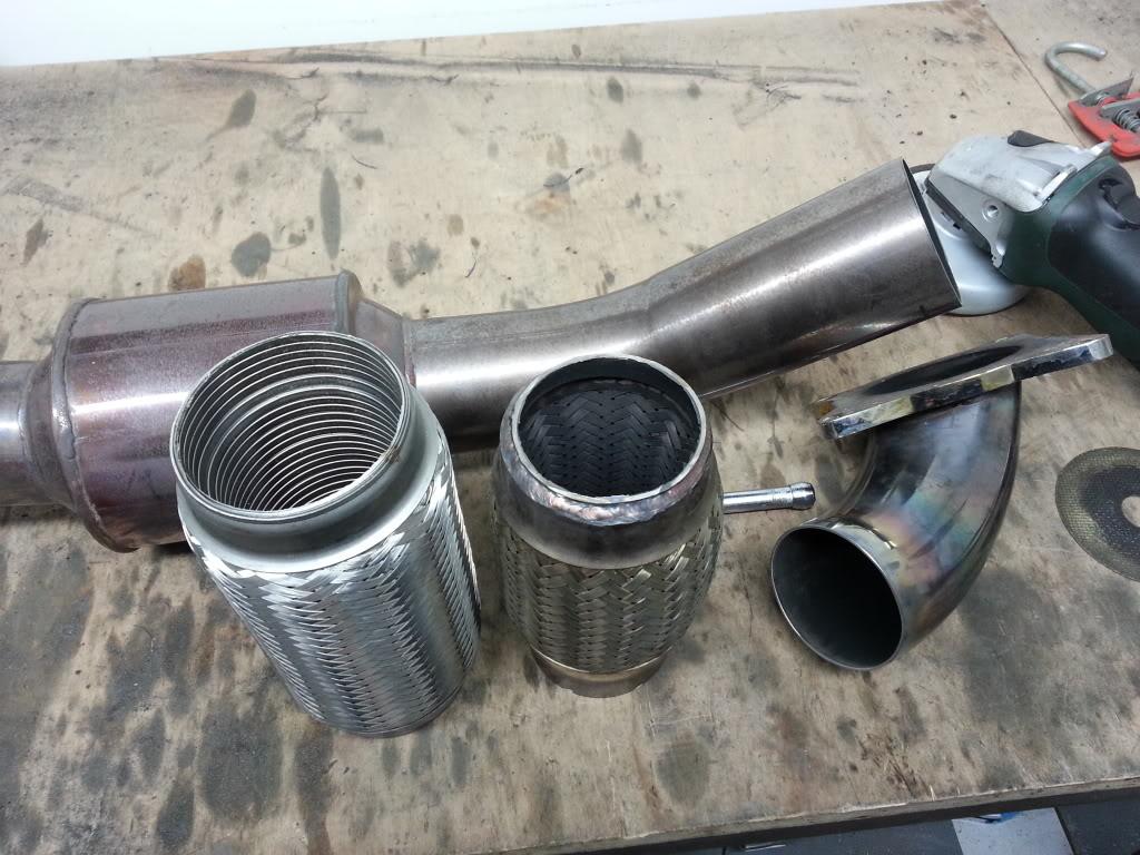

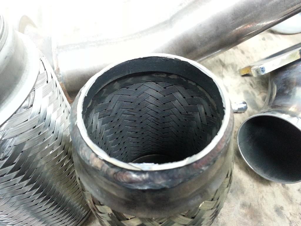

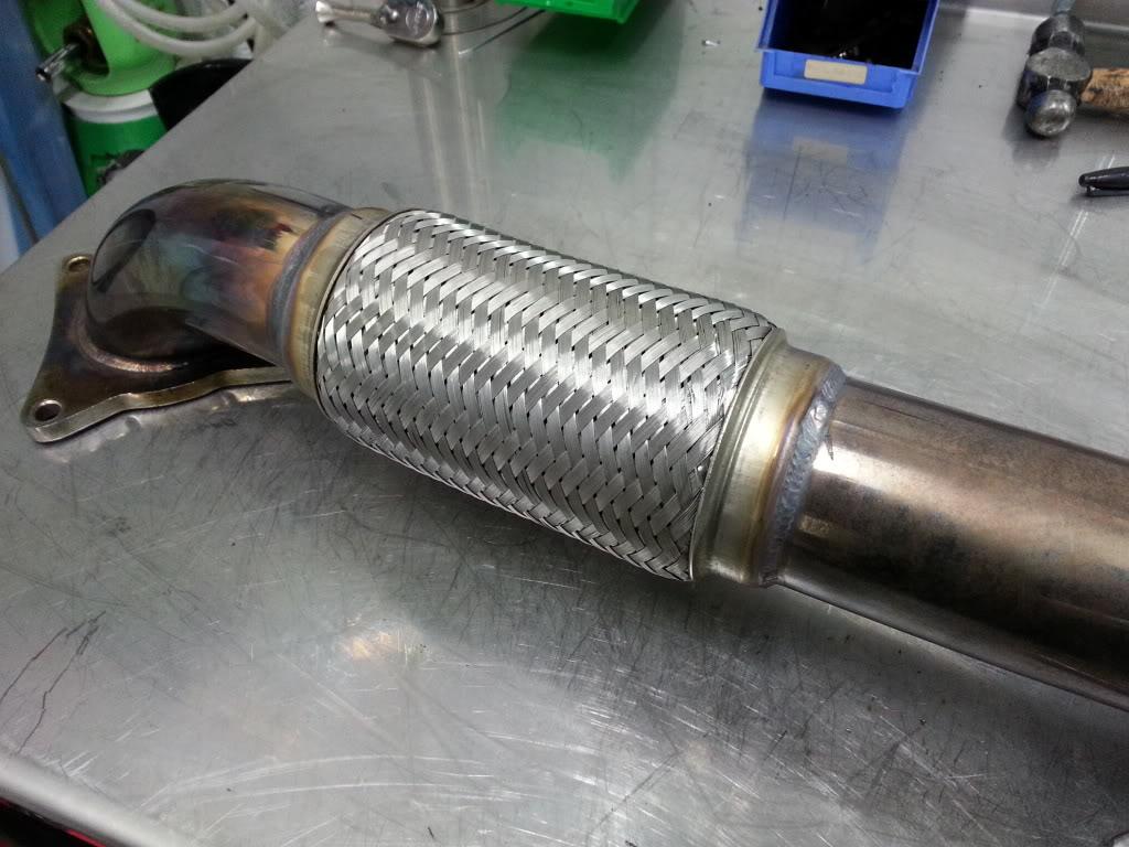

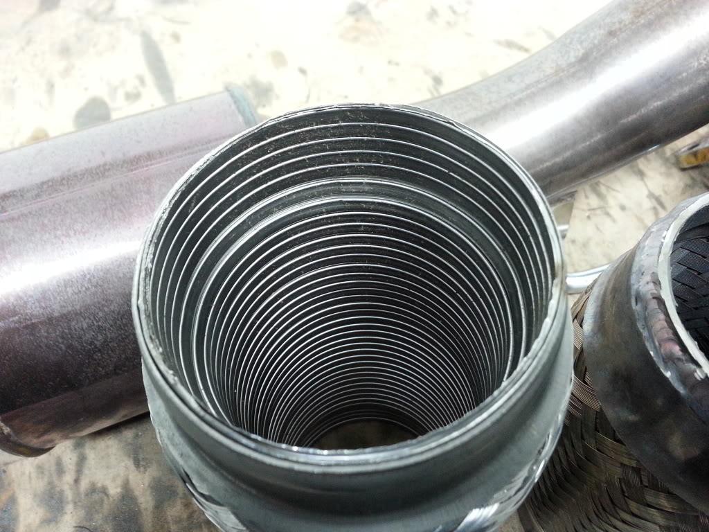

In short I wouldn't spend £1000 on a Miltek... Anways you may find this interesting.
They just need a decent flexi welding into them then they will be good.
Customer supplied one to me and I welded this into it:
Original flexi is braided internally and can shrink with heat
New ilok longer flexi.  These can take silly heat before having issues
