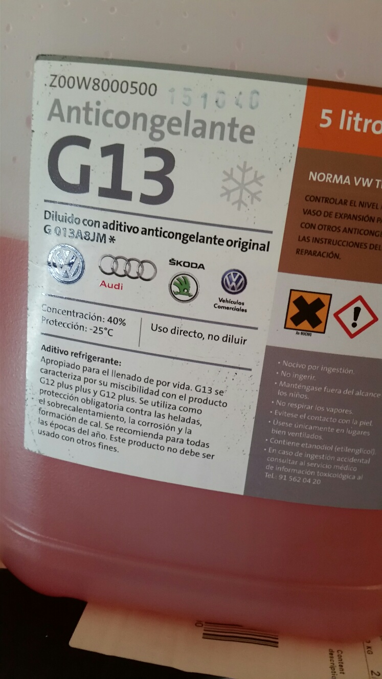

I bought G13 from the stealers and it said do not dilute.
Thanks, il just put it all in then if it needs a top up il add a little water. Surely having to much anti freeze won't hurt?

This was a 5L bottle. Don't know if that makes any difference.

Don't want to give bad info. Surely there will be dilution ration on the bottle.

The one i bought is already diluted concentration 40%

Stick with dealer blend...run it straight as it is pre-diluted and made for this engines alloys.

Looked on the bottle and I'm 99% sure it's neat. Anyways in the end I put 3L of g13 in and a little bit of distilled water. Bled it, when for a run got back topped it up a tiny way and now it's done, heaters working etc. engine temp stayed at 90 the whole way even when coasting  :happy2: unlike before.
My anti freeze tester reads -50c , think I should drop a little coolant out and top with water or just leave it, can too much anti freeze cause any damage?
Mine must be neat coolant, your says protection up to -25c I've got double that according to this tester.
Cheers for the help

Mine took nearly the full 5L to fill it. 3 litres and 2 litres water should be fine. I think its supposed to be 1:1. Hopefully someone who knows better will chime in if i'm wrong.

Been in touch with the seller and it's 100% neat as I thought, apparently the diluted version is discontinued.
After looking around on the net it says to use a ratio of 1:1. Il just drop a little out and add water then check with the anti freeze tester, maybes aim for -30c. Just don't want to have too much anti freeze in incase that can cause problems in itself.
