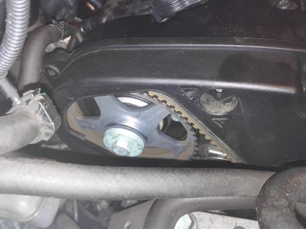

I didnt have long tonight but I couldnt find either the camshaft or the crankshaft TDC. I cant get in to see rhe cambelt pulley properly.
And I cant see the top of the crankshaft pulley properley as the chassis is in the way. I filmed it on my phone and the only thing I can see is this tiny little triangular indent on the pulley, nothing on the back plate. In the video I start at the top of the pulley and.go anti clockwise looking for the TDC mark
« Last Edit: March 10, 2016, 10:42:56 pm by Peskyjones »

You can see the indent in the back plate in seconds 5/6 & 36.
I used my phone to line up the cam shaft when i was doing the cam chain the viewing window is useless.

Quicker way was to put a long driver in plug closest to cam and get it to tdc rocking neither up nor down so that's central and TDC marked up.
The driver has to be at the highest point when tdc is marked up.

Cheers guys, so il try using my phone ha. Is the camshaft tdc mark where the one shown dazza posted on page 10.
And is the triangular indent on the crankshaft pulley the tdc mark?
