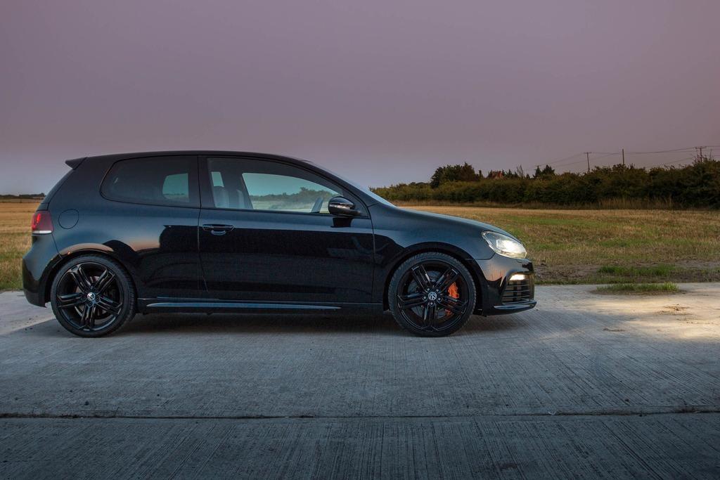

I’ll start with the background – Last January I brought my first VW, a Mk6 Golf R. Over the following months I quickly decided the standard 270hp wasn’t enough and before long it was running an R-Tech stage 2+ map with 360hp/380ft-lbs. To compliment this newfound power, I upgraded the brakes to Lamborghini 8 pots and a few other bits.

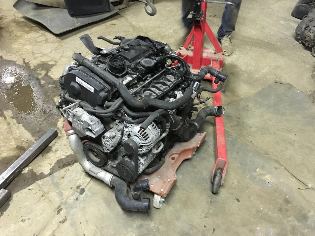

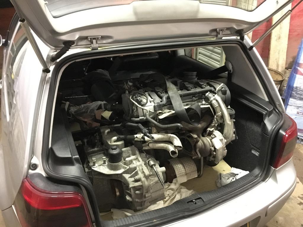

Fast forward a couple of months and the first piece of the project was purchased. Not the car like most people would start with but the engine. I wanted a CDL due to the improved cams and better flowing head. The unit I picked up came as a complete unit with a turbo, gearbox and all the ancillaries.
Picked by my mate in his trusty Mk4 GTI:

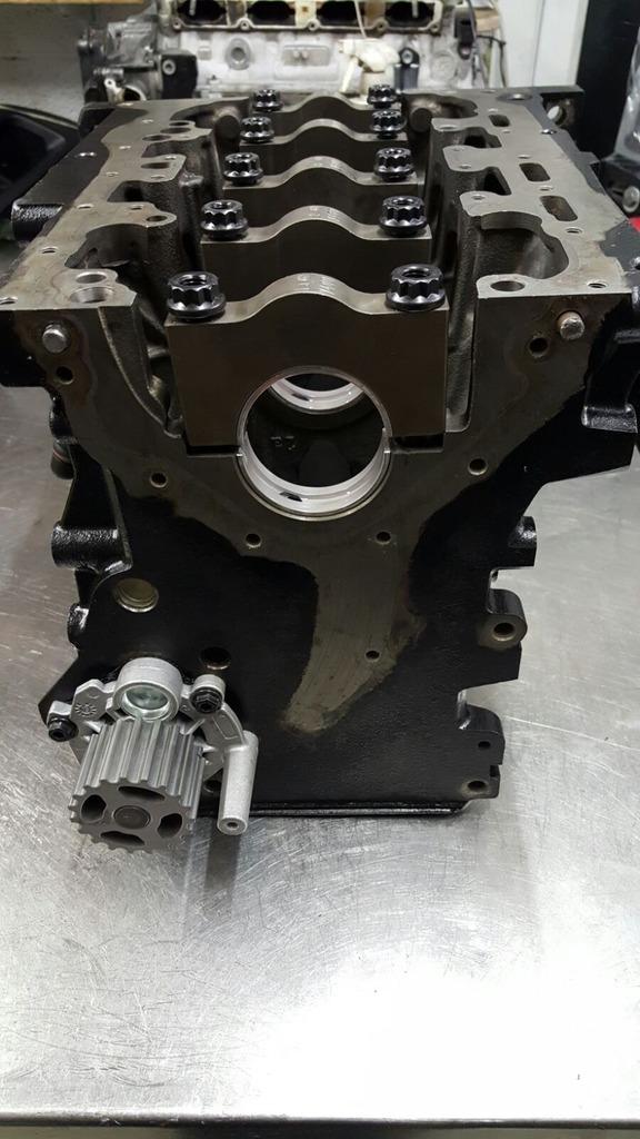

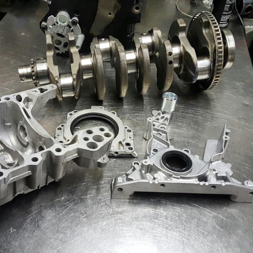

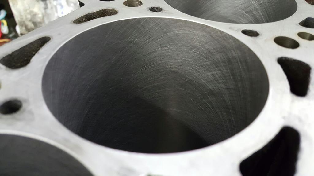

Most of the bits that it came with will not be needed as the engine was soon sent off to JP at JNL Racing. I considered leaving the engine alone as they have been ran at 450hp+ without many issues and would save me a decent chunk of cash. However with the type of use I want to put it through as well as the potential of going for an even higher power figure further down the line, I decided it was best to get it done before it went in so it is as bulletproof as it can be.
Few pics courtesy of JNL Racing:

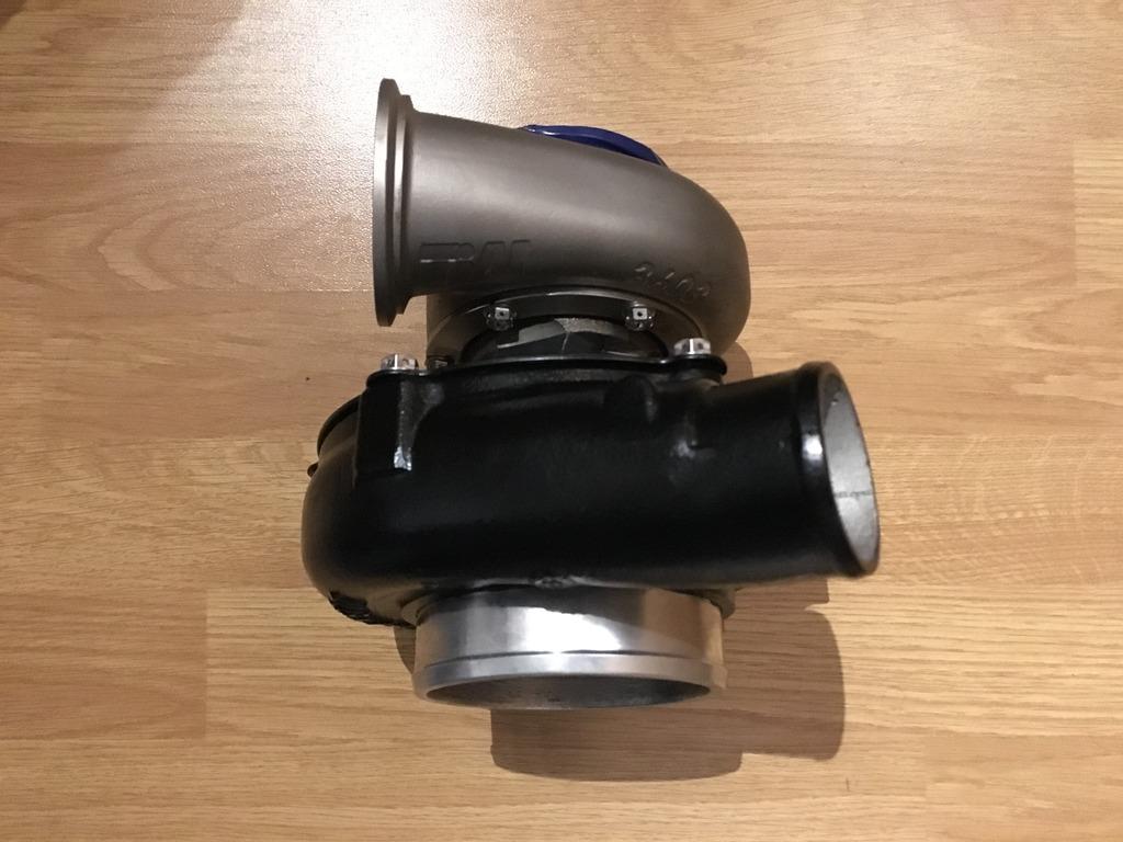

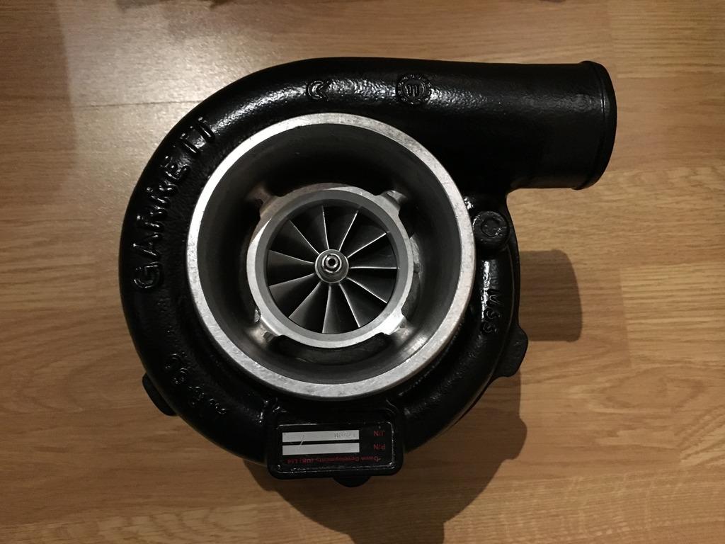

Soon after the engine as dropped off one of my best mates Sean (also on the forum) decided he was selling his turbo that he originally brought for his 20V turbo Mk2 GTI dragcar build as it was “just not big enough” in his words.
His old build thread: http://www.mk5golfgti.co.uk/forum/index.php/topic,95563.0.html
His new one: http://www.mk5golfgti.co.uk/forum/index.php/topic,105139.0.html

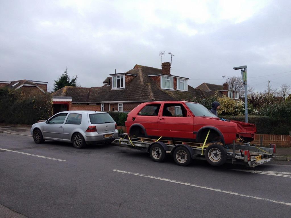

Pic of his current project:
So although my wallet had taken a battering with the engine that month, I agreed to buy his GTX3071r.

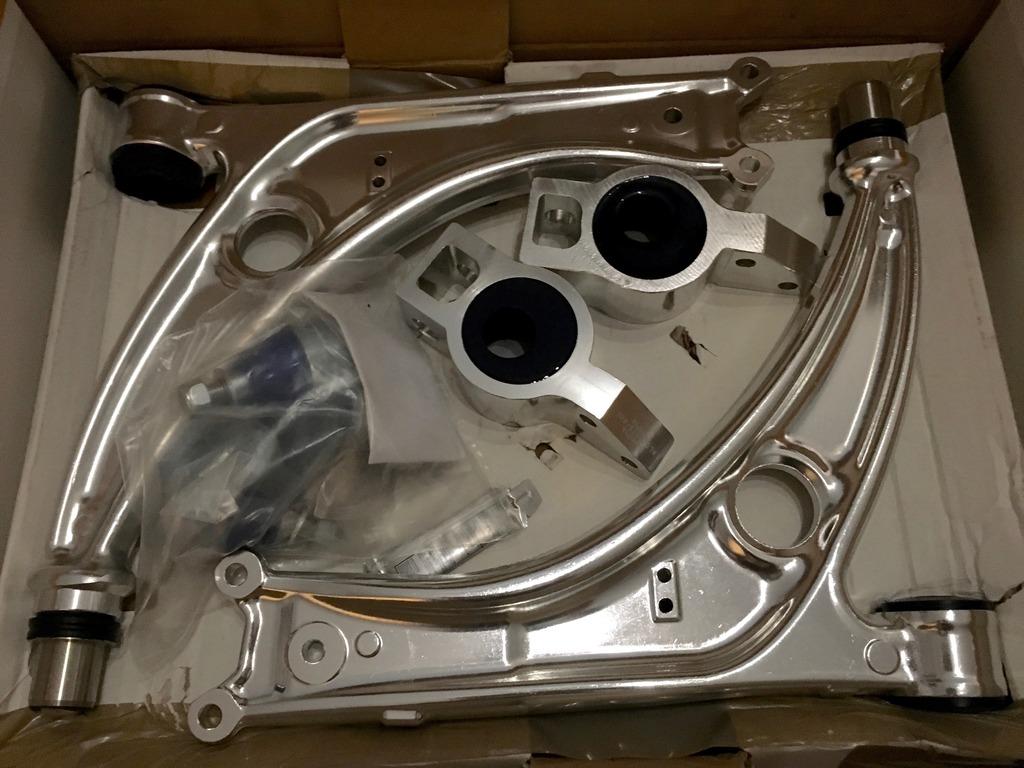

Had to take advantage of Black Friday sales, so picked up some SuperPro aluminium lower arms from AKS.

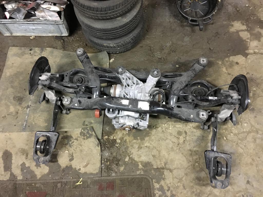

Before I purchased a shell, I wanted to get most of the big bits ready so they could be bolted straight in. After popping up AKS and mentioning I was looking for some bits, Alex sent me a link to a low mileage S3 rear subframe with Haldex included. This was duly picked up a few days later:

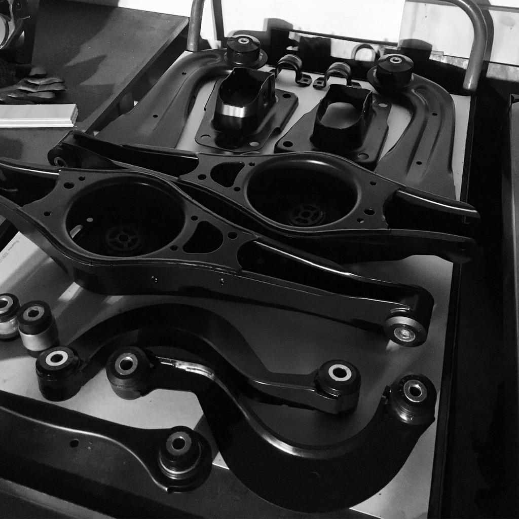

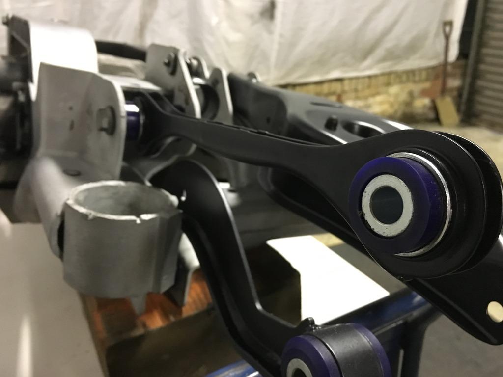

I want the whole car to be polybushed so the rear end needed to be stripped down for that anyway. Managed to get a complete rear SuperPro polybush kit at the Autosport show at trade cost which saved a few pounds. While I was at it I got the majority of the arms and brackets blasted and powdercoated.

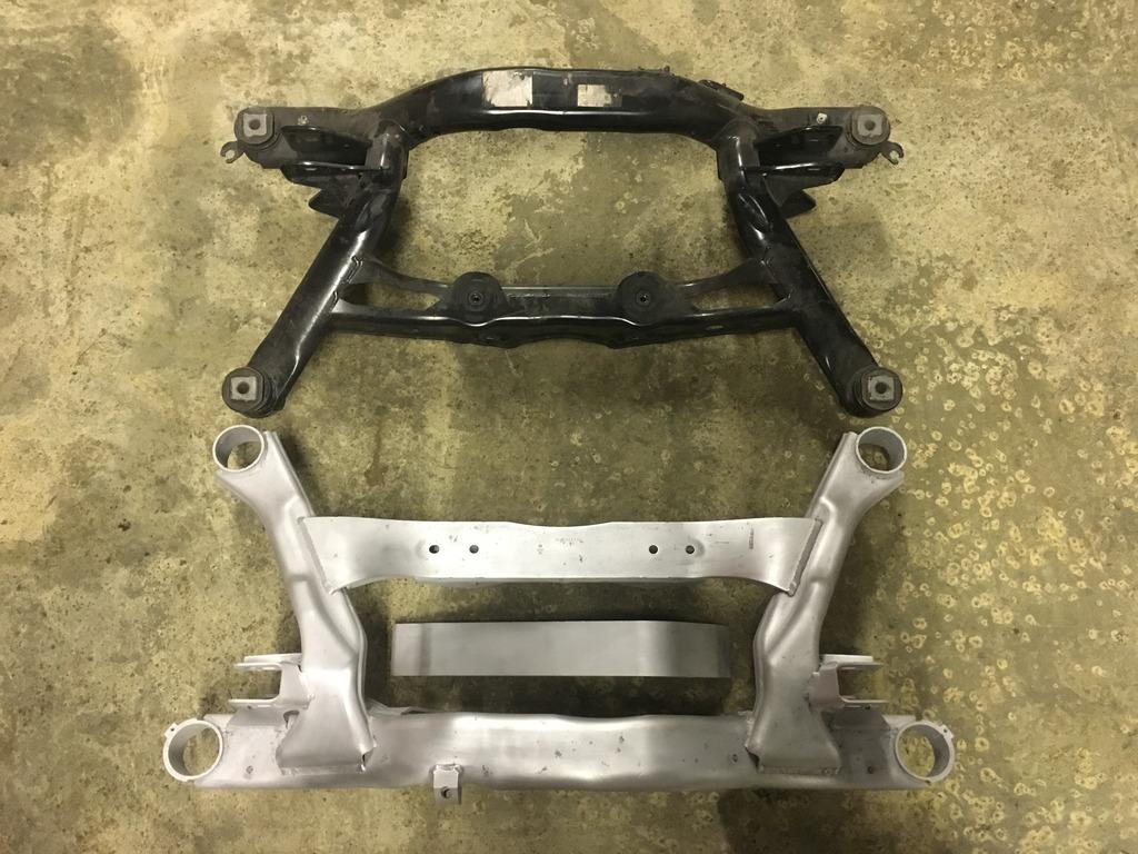

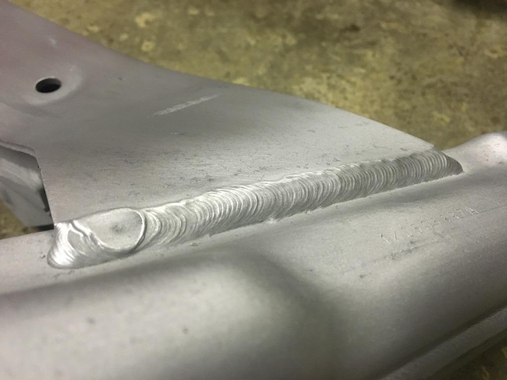

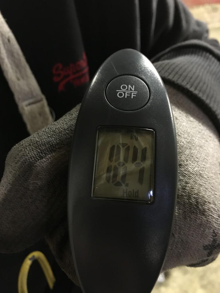

Whilst the rear subframe was apart I thought I’d have a quick look on ebay to see how much an aluminium diff cradle would set me back. I managed to find a fairly cheap one but couldn’t seem to find a definitive difference between the weight compared to the steel one I already had. But I brought it anyway as I want the car to be as light as possible. Here are the differences below:
Steel:
Aluminium:
Aluminium diff cradle cleaned up and sealed:
All going back together with the SuperPro bushes:

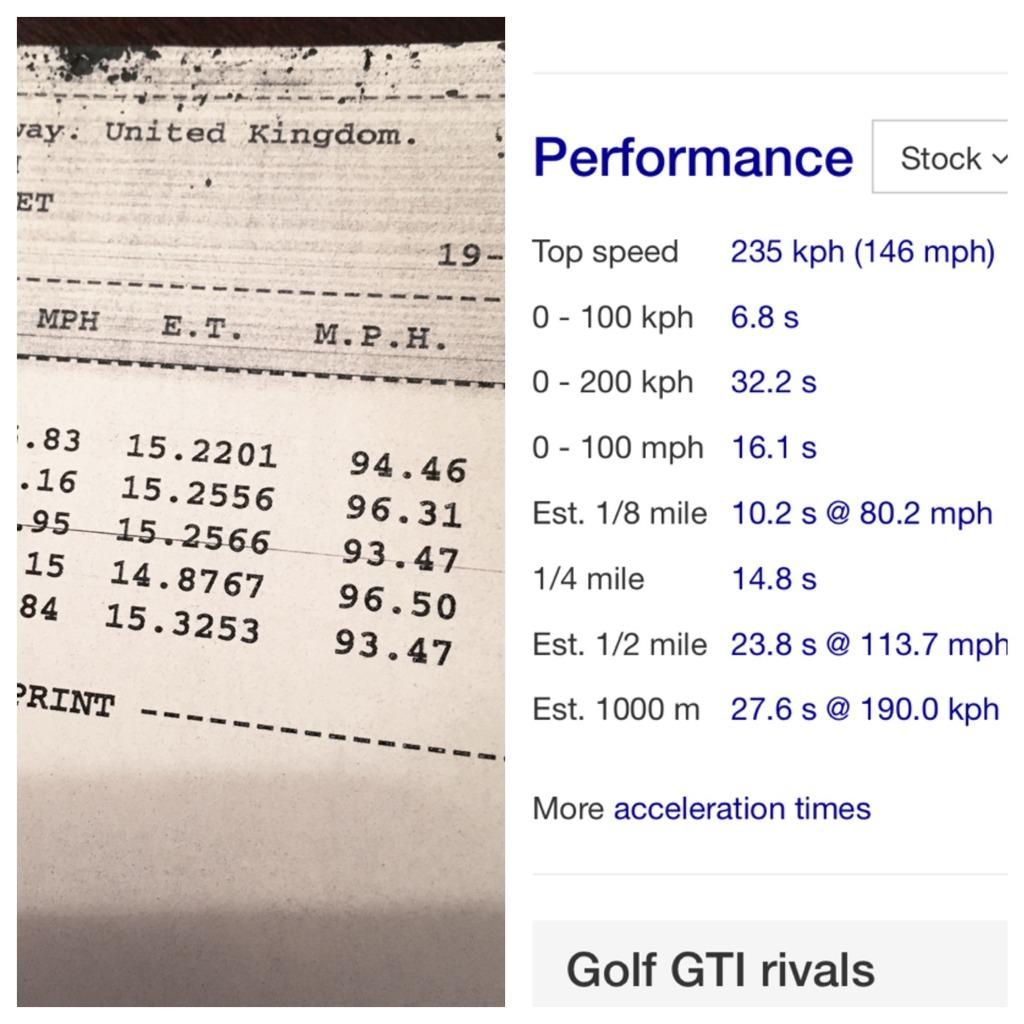

Before I did anything to the car I decided I wanted to get a benchmark of what it could do in standard trim. First thing I decided to weigh it, so took the car down to a friendly local scrapyard and it came back at 1370kg with ¼ tank of petrol in it.

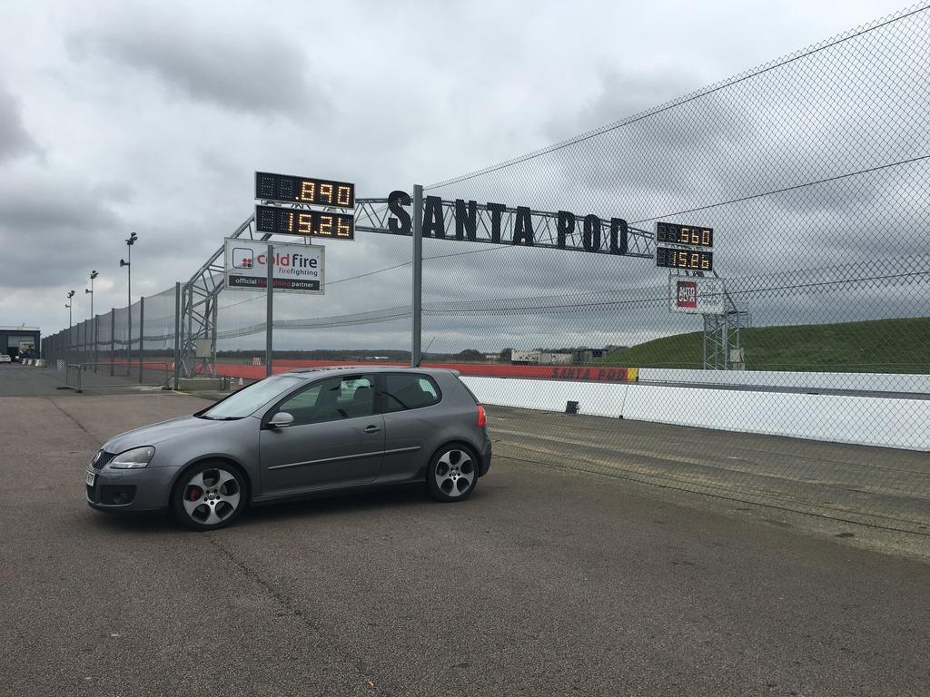

Luckily there was a RWYB at Santa Pod the following day so I managed to get a few runs in. My best quarter mile time was 14.8, which matched the quoted time for a standard Mk5 GTI on www.fastestlaps.com website:

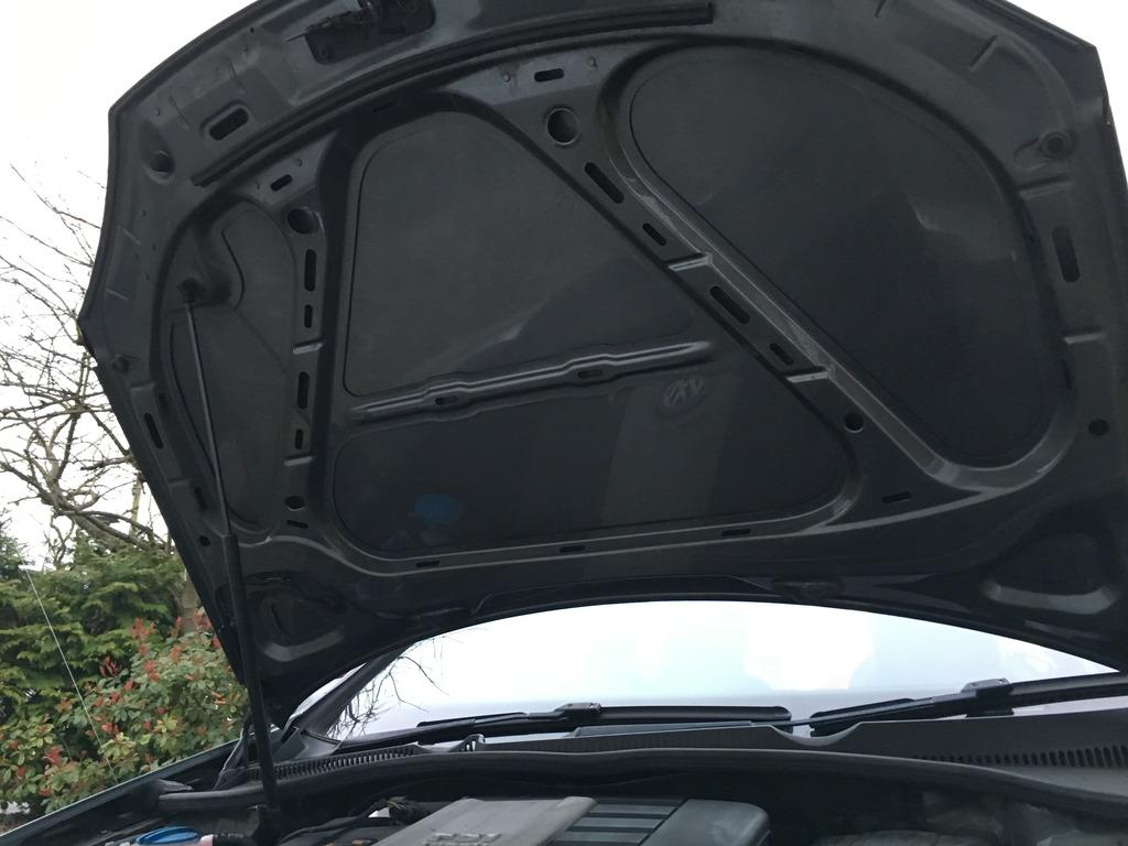

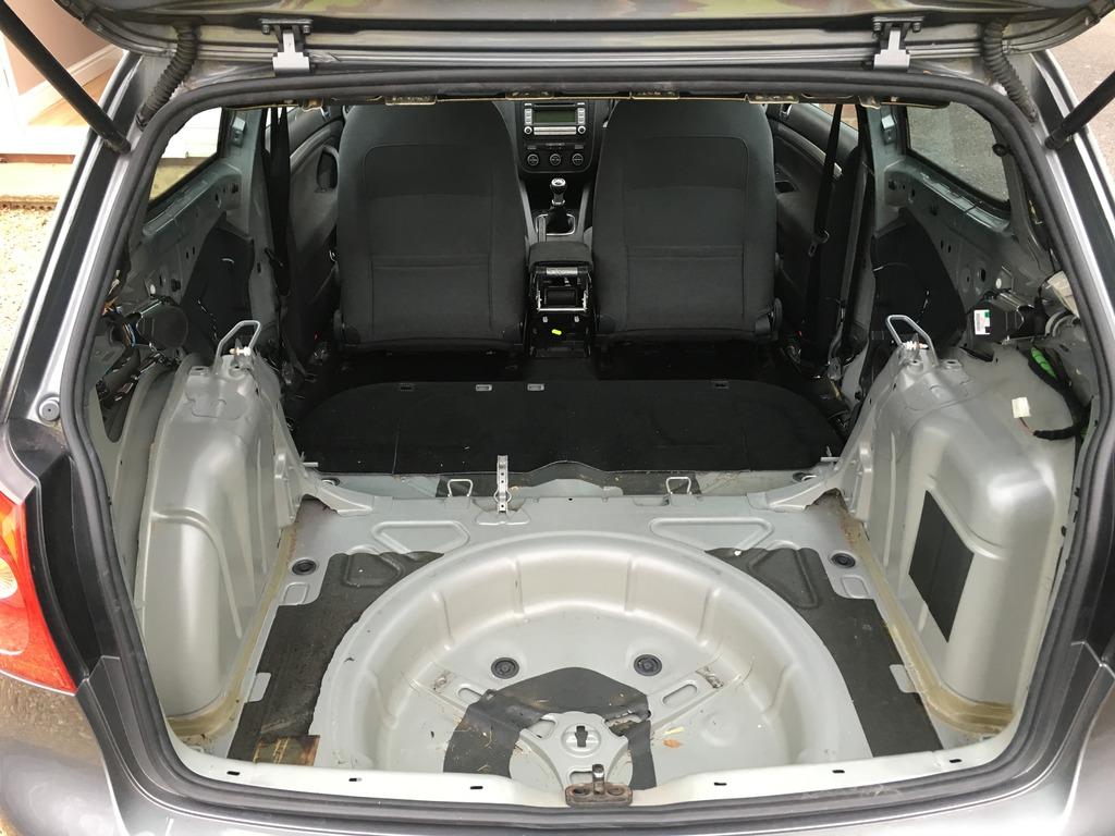

Bit more weight saving last night:
Soundproofing under the bonnet removed and most of the rear seats and trim gone:
