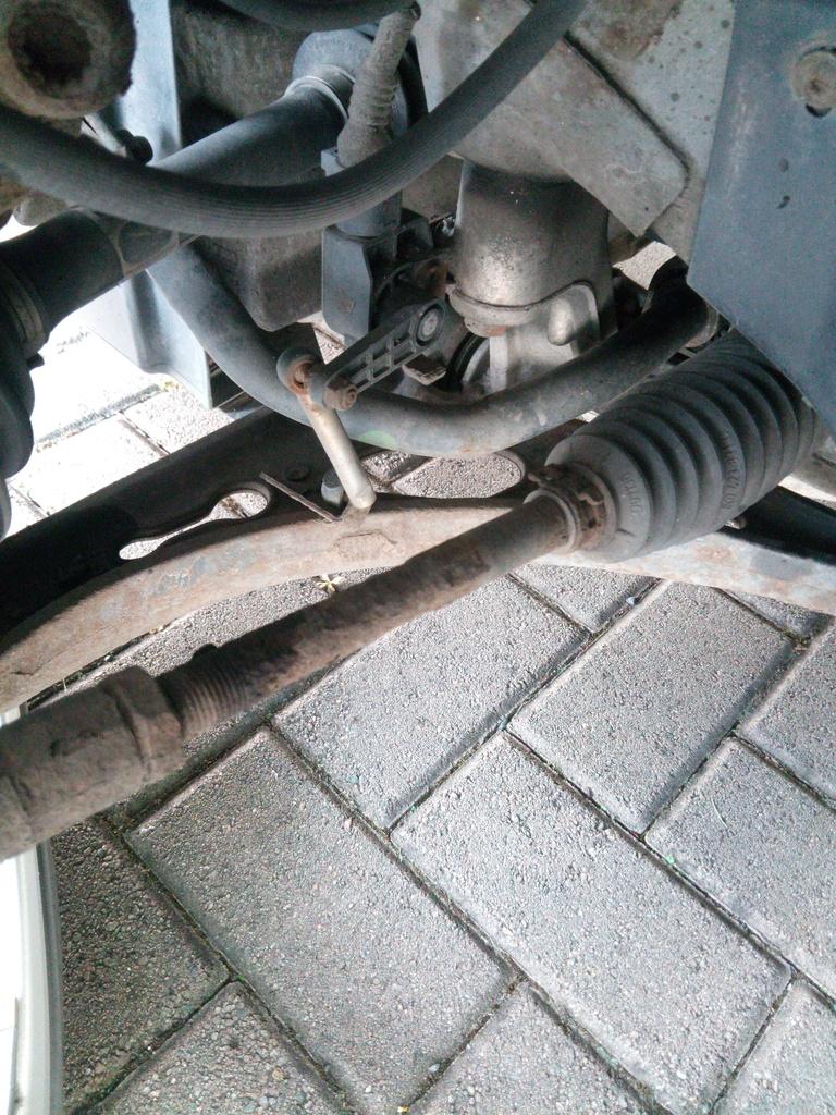

Happened to see this today while having a nosey round.
Re: What is this broken. NSF
« Reply #1 on: June 22, 2016, 02:40:21 pm »
Xenon level sensor
« Reply #2 on: June 22, 2016, 02:55:25 pm »
As above!
You can't replace the plastic, you need an entire new sensor unit. Very pricey piece of kit too.
Chances are your lights have been blinding people or pointing at the ground since it happened.
Cheapest fix is to cable tie it at the halfway point.

« Reply #3 on: June 22, 2016, 03:07:00 pm »
Silly question. But how should it look??
« Reply #4 on: June 22, 2016, 03:13:39 pm »
http://www.golfmkv.com/forums/showthread.php?t=154324
Scroll down a bit.
It's connected to the wishbone. As you hit a bump, the wishbone naturally moves up/down with the pressure. This is reflected with the sensor and the headlight level changes accordingly.
« Reply #6 on: June 22, 2016, 11:06:36 pm »
Its more to adjust the level if you have a heavy weight in the back or are towing which changes the pitch of the car

« Reply #7 on: June 22, 2016, 11:16:33 pm »
Pn should be  1K0941274B and the RRP is £114.47
