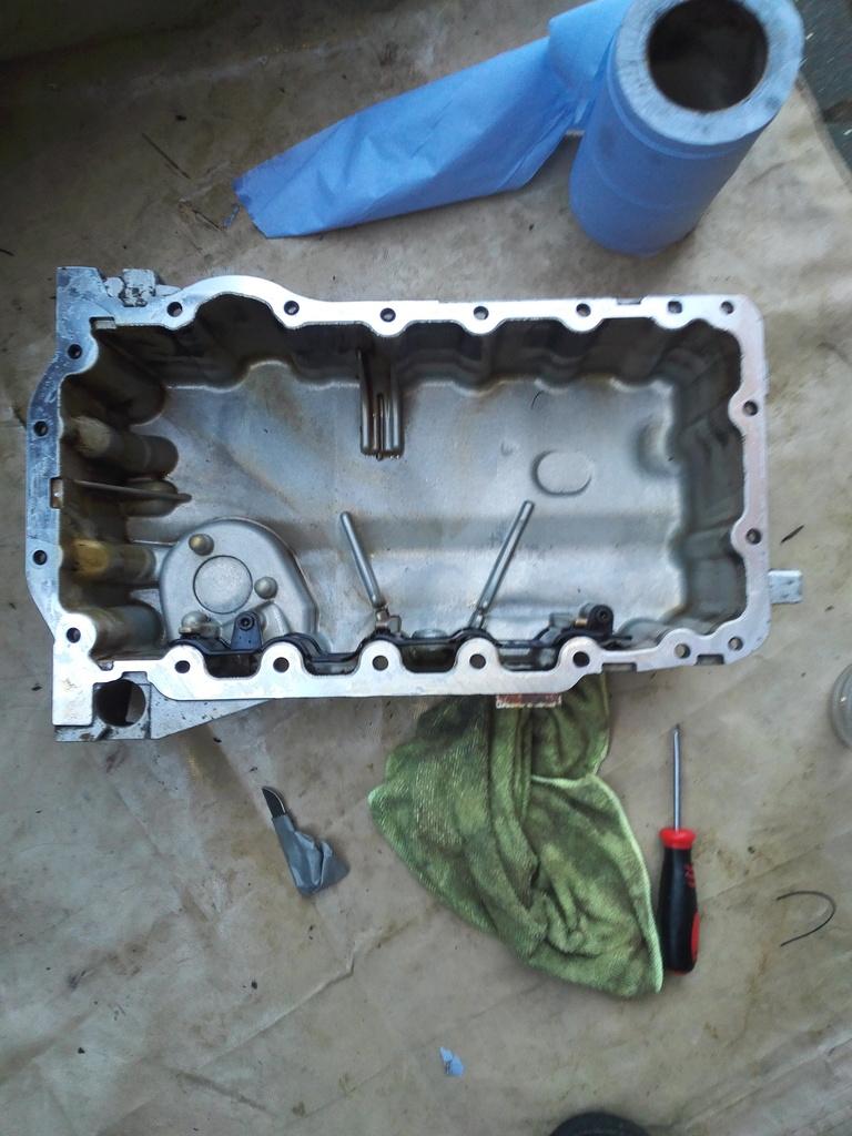

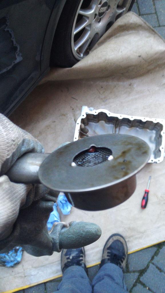

Did it today, all good in the sump and pick up pipe virtually clean, apart from the old little orange ball off the old dipstick stuck in the pick up pipe.

« Reply #34 on: December 01, 2016, 03:02:45 pm »
Yup, exactly what mine looked like.
Your sump looks clean too.

« Reply #35 on: December 01, 2016, 07:12:38 pm »
Yeah cleaned the sump out.
