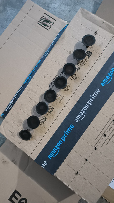

The valves from the intake side are out. Is there a way to test if they are bent? Or should I just replace them all as they hit the pistons?

Roll the valves along a flat table, that'll easily show any that are bent. Elring are a good make I believe.
Tried rolling on the table could not see any bent ones. Even the one that was really leaking.

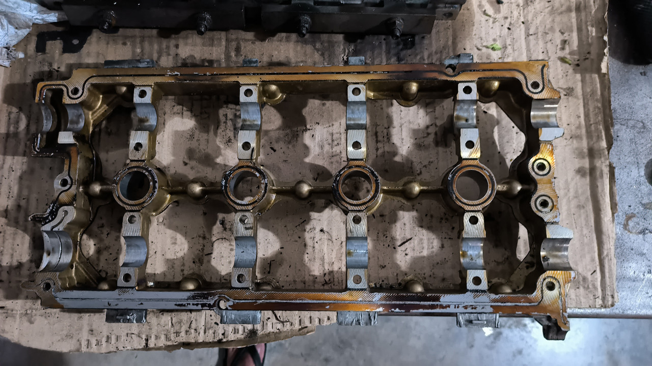

The liquid gasket has gone hard and there a lots of bits in the top of the head. Could I give it a blast down with hot pressure washer?
Everything is out apart from the injectors.
« Last Edit: September 15, 2023, 09:42:19 pm by dazza »

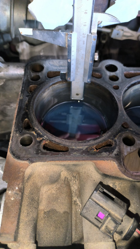

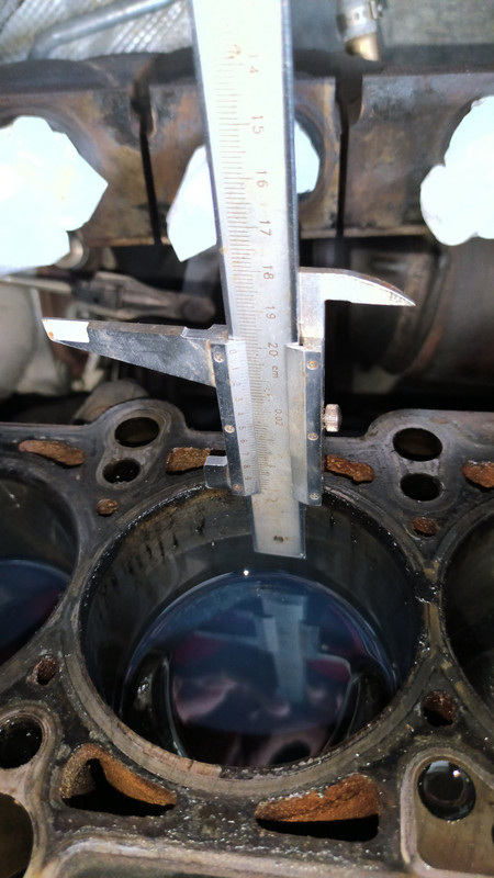

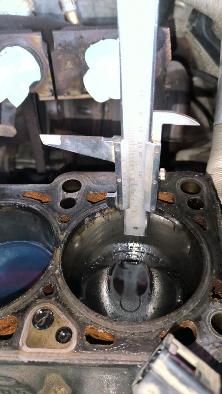

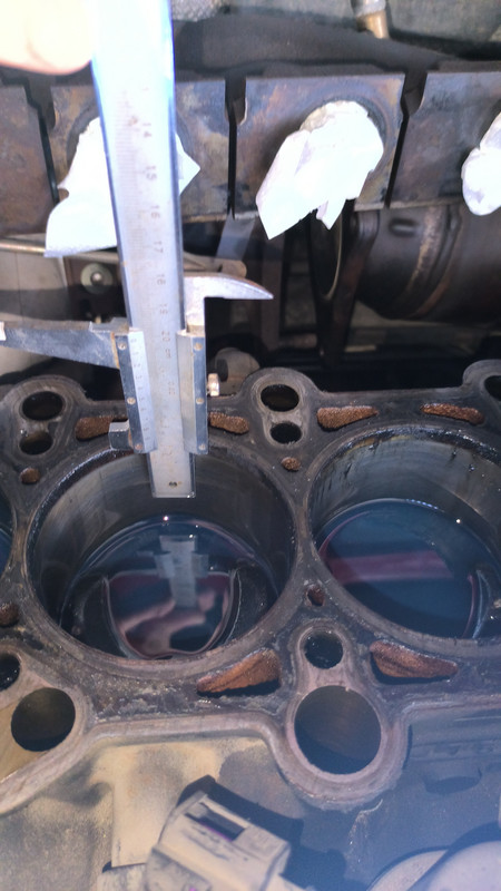

I tested the piston seals with some diesel. Filled to the bottom of the caliper in the pics.
Within 1 hour 45 mins all had dropped 3 were nearly empty.
Maybe this is why I needed to top up the oil often.

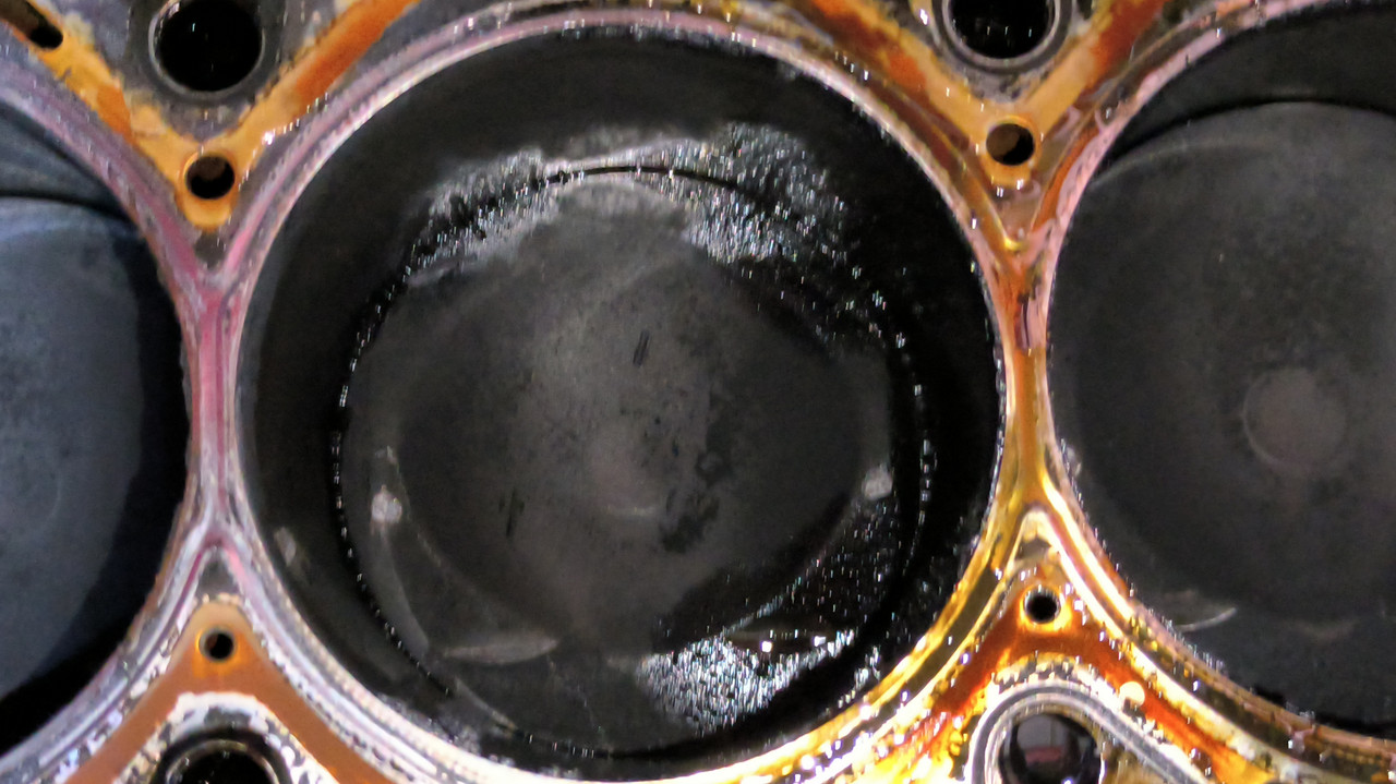

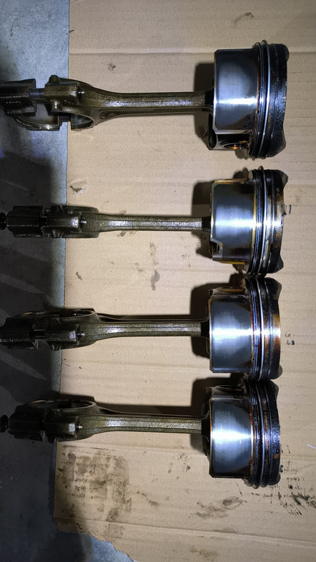

Pistons are out what should I be looking for here?
« Last Edit: September 22, 2023, 09:41:26 pm by dazza »

Do the rings spin freely by hand? If no they could have been squashed when the valve/piston contact occured.
Any damage to the ring lands (the gaps and part of the piston around the rings)
Now is the time to fit new rings and hone the cylinders.Especially if had high oil consumption.
