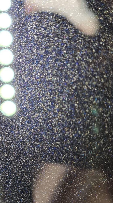

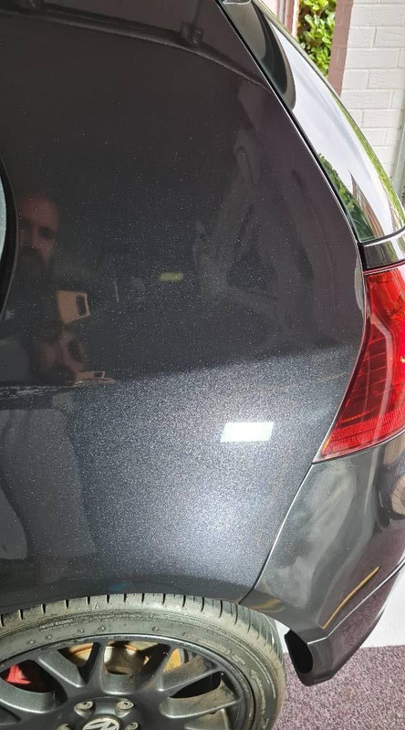

I picked up my eddie last night.
She had a full paint correction, two coats wax, headlamp restoration, calipers re-painted to VW red (pics were taken before they were painted).  New Edition 30 badge on the rear.  Engine Bay cleaned
The idea had been to get it into nice condition for the next owner as I was going to sell her, but she's looking so good right now I'm actually not sure I can do it !
