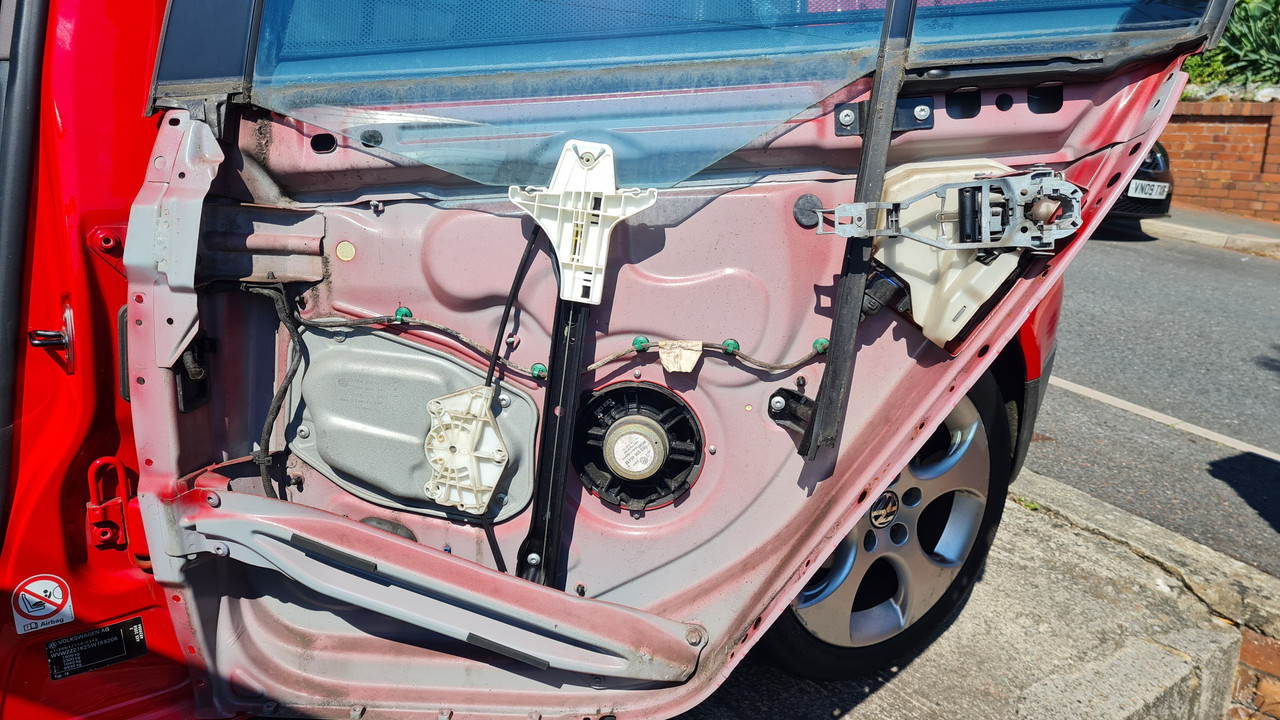

My indicators stopped flashing when locking the car. Checked every door activated the interior light and all OK.
Ran vcds and turns out my passenger rear Dock lock has packed in. Can hear it clicking but it's not locking the door. Had to pull off the door handle black end that connects to the silver wire in order to stop someone opening that door and breaking in.
Ordered new door lock to fit next week.

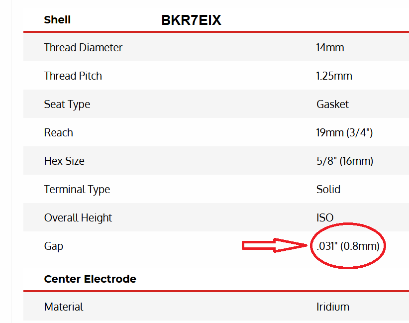

Received my new NGK BKR7EIX plugs....NGK site has them shown to come with a 0.8mm gap, mine came 0.7mm gap. With new APR coils on the way, a 0.8mm is my preference so I opened them. I first double checked the gap gauge with the caliper and my 0.7mm gauge is 0.69mm. The 7.5mm gauge is 7.3mm. My gauge set comes; 0.6mm__0.7mm__0.75mm__0.9mm__1.0mm...and doesn't have a 0.8mm for whatever reason. So I filed down the 1.0mm gauge wire on one side to 0.8mm. Man, I need something else to do with my life!

Got as far as removing the door skin to replace the door mechanism. Only to find there was 3 suction cups in the door well and someone has butchered the m6 screws holding the lock on!. Luckly a pair of locking mole grips got them undone so now waiting until the weekend for the replacement m6 spline screws to arrive before I carry on.

Yes they're tripple squares or something aren't they, I'd never heard of them before having to change the door module so that shows how much I know about spannering lol.

Yeah there WHT000439 splines. Might call the stealers tmr to see how much they are from them so I can do the job sooner than waiting for the replacement ones to turn up monday

A correctly sized Hex/Allen key also works in most cases, but not now they’ve been rounded off.

Joys of a car having previous owners I guess. Once the replacements arrive I can crack on and get it done. Easy job when you've done one side. Just looks scary bit it's not  :happy2:

Fitted new rear door locking mechanism. All working as it should now. Indicators flash when I hit lock button.
Vw charged me £267 labour. Was a 45min job so not sure what they was doing that too 2.5hrs.. also they charged me £121 for a part that cost me £23.
Total cos from them was £443..  total cost for me to do including new bolts, door lock and a socket was £40
