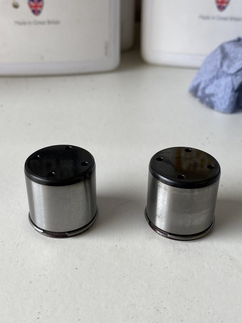

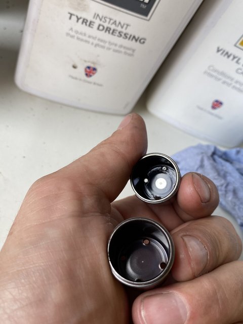

Changed the cam follower on my ed30 today.Done 6k miles on stage 2+ from R-tech and follower was put in at the same time.
Still great, right?
It can obviously go longer between changes if your driving remains as it were through the first 6k miles. Driving style has an effect on it as well as does the HPFP spring used. Obviously the tuning specifications for rail pressure will also affect the CF wear. The more you go to or near full throttle, the more wear on the follower occurs because of increased rail pressure requirements. I would suggest going 10k miles next time, then 12k or 15k afterwards...depending on when you see the black DLC (diamond like coating) beginning to wear from the contact-to-cam surface.
