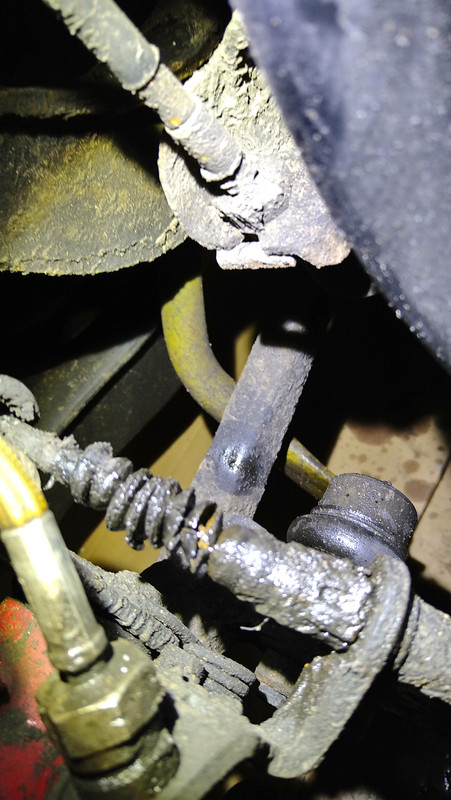

frozen rusty 2 yr old PAGID h/b cable.  The rubber gaiter is split  Next stop TPS for a genuine pair of cables
 disc was glowing a beautiful reddy orange Another mile and it would have been white :smiley:

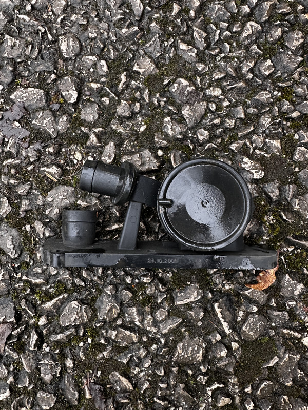

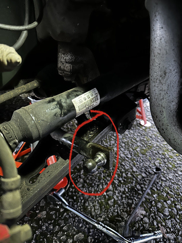

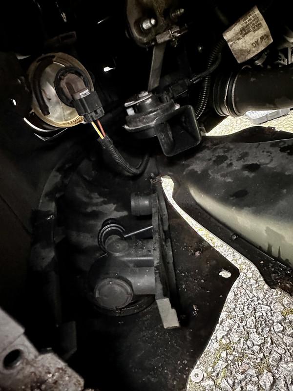

So when changing drop links for the MOT I found an old PCV valve in the front bumper, owned the car two years and even had a cambelt change at VW and never been picked up before or heard a thing while driving.
Anyway nearside droplink was fine. The offside lower bolt was rounded off inside at the spline head and the nut was tight, really f****** tight. Impossible for me to get off with breaker bar, two sets of mole grips and penetrating oil :thinking:. Going to have another go at it next weekend
