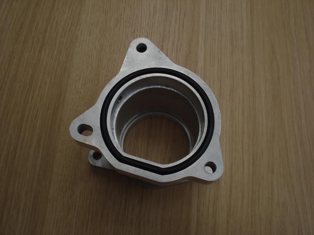

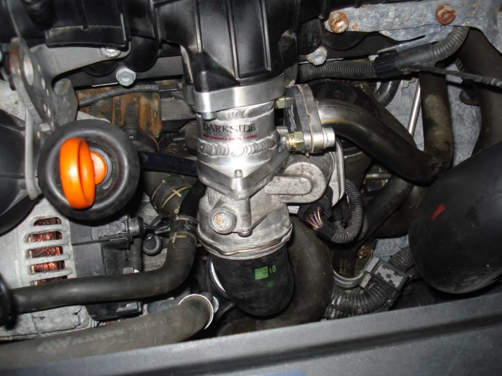

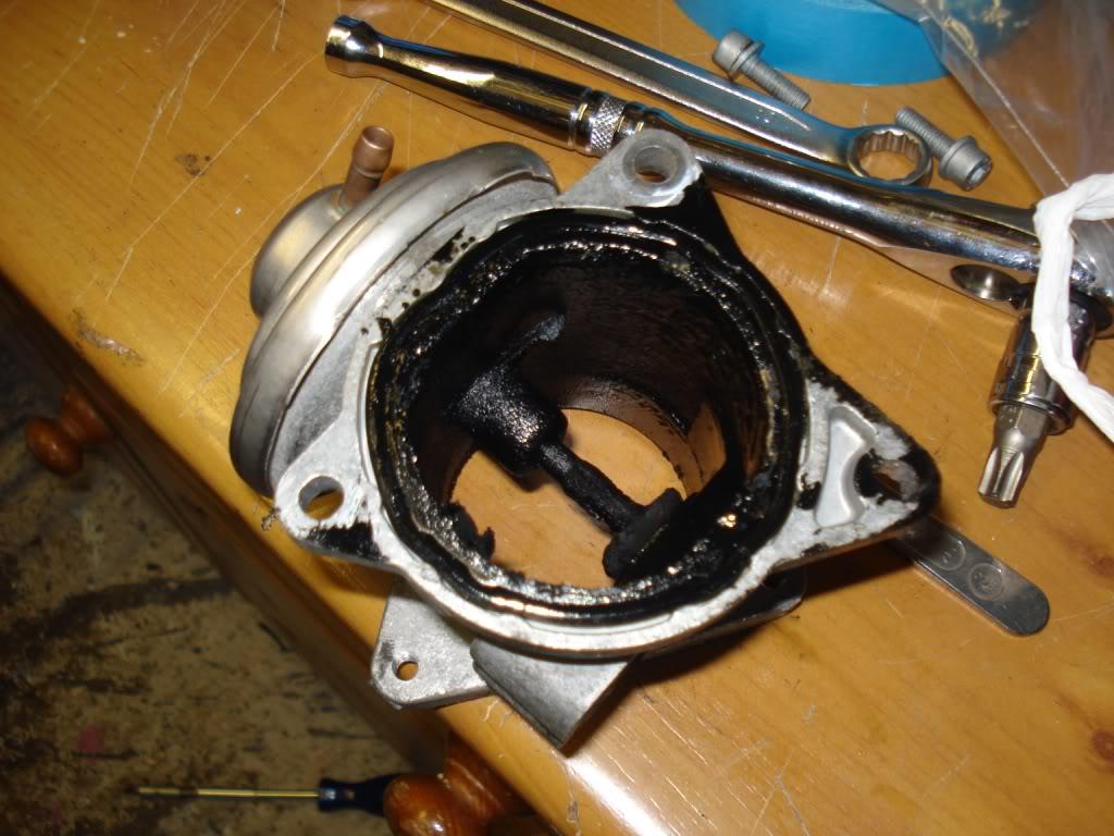

« Reply #7 on: September 07, 2011, 10:10:04 am »
Darren's explanation is spot on really, over time crud will build up in the EGR valve reducing the diameter and with it air flow.  You don't necessarily have to fit a delete pipe, if you have the time, you can remove the EGR and leave it to soak overnight in either carb cleaner or similar.  Once clean simply refit.  However the advantage to going for a bypass is the internal diameter of the delete pipe is greater and also there are no internal obstructions.
The pictures below should illusrate this.
My OE EGR valve -
Delete pipe -
Fitted -
Mine had covered a little over 45k, and tbh wasn't that bad, the last picture is from a vehicle which had covered less miles.  Poor servicing, fuelling and enviroment can all play a part in how bad they can get.  Imo, for 70 quid it's a no brainer, as I noticed increase throttle response and over a couple of runs the mpg increased slightly.
