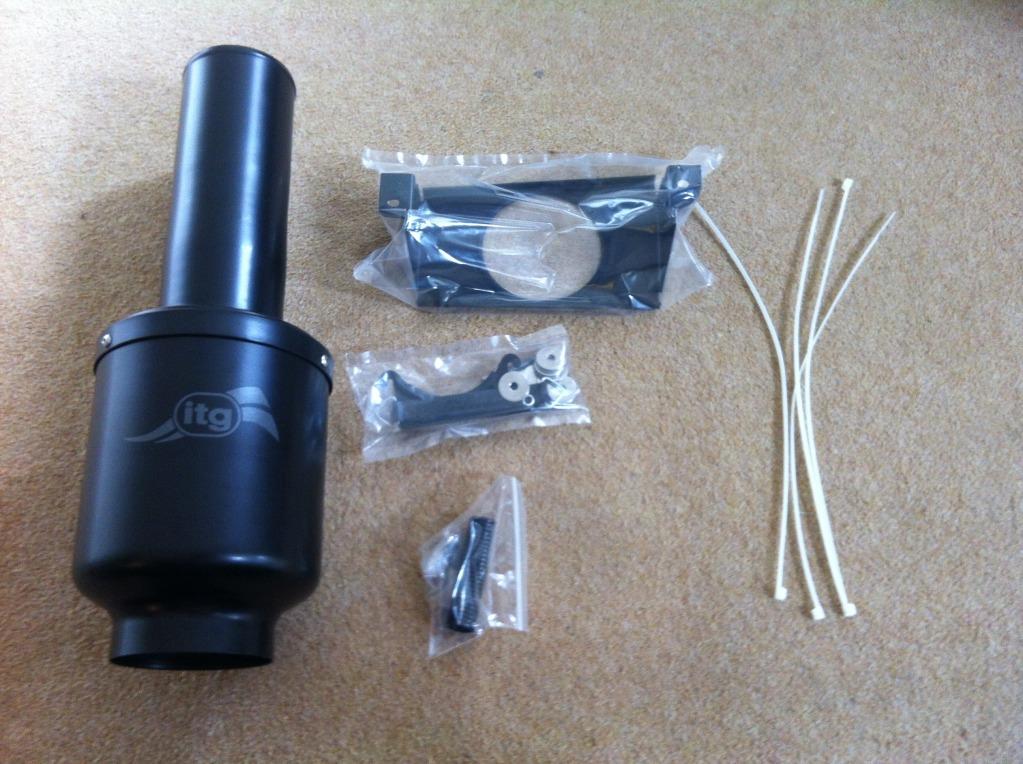

Parts supplied
The modified bracket comes with a rubber strap, pictured in the centre of the photo.
The cannister smaller diameter downstream of the filter sits in the half moon shape bracket and is fastened to the threaded insert just to the front left of the battery box.

Parts supplied
Thread insert viewed here
Bracket attached here.  Sorry for the poor photo
Hope this helps  :happy2:
What's the part in the bottom plastic bag? Not sure I've been given that part

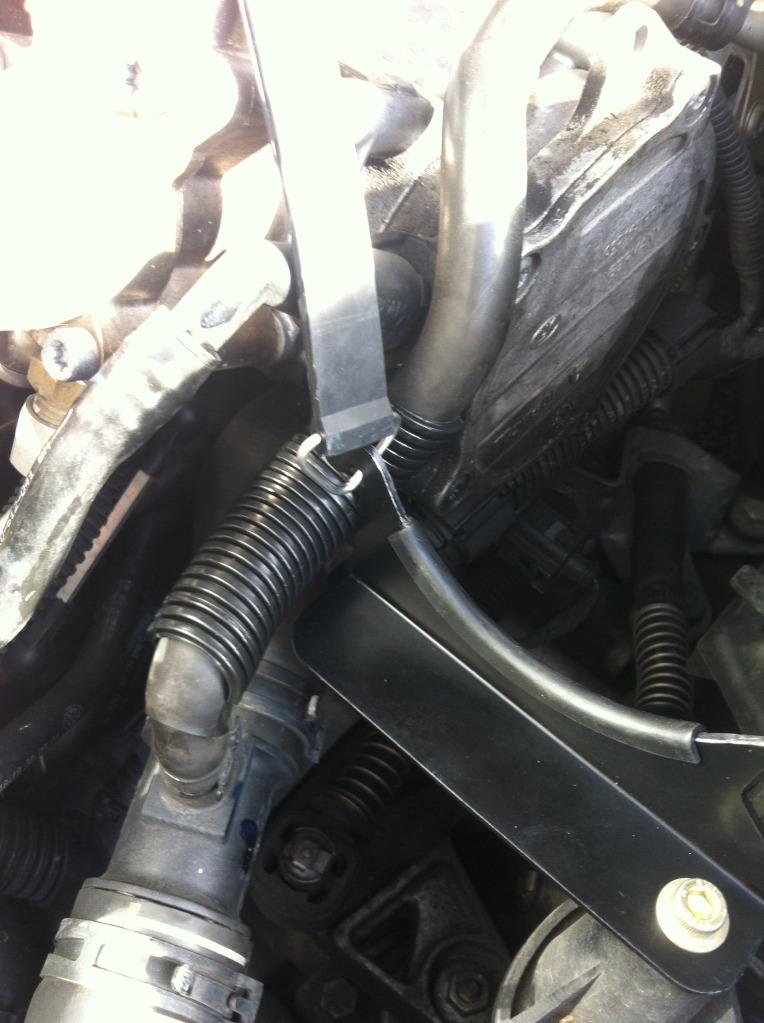

« Reply #20 on: July 08, 2012, 02:57:08 pm »
Bit of flexi conduit, goes over one of the coolant hoses, see photos.  One of the hoses nearly touches the support bracket.  This just stops it rubbing through  :happy2:
....I did the same to protect a hose from my aluminium engine cover. If not protected it's surprising how quickly it can rub through and that could be with disastrous consequences.

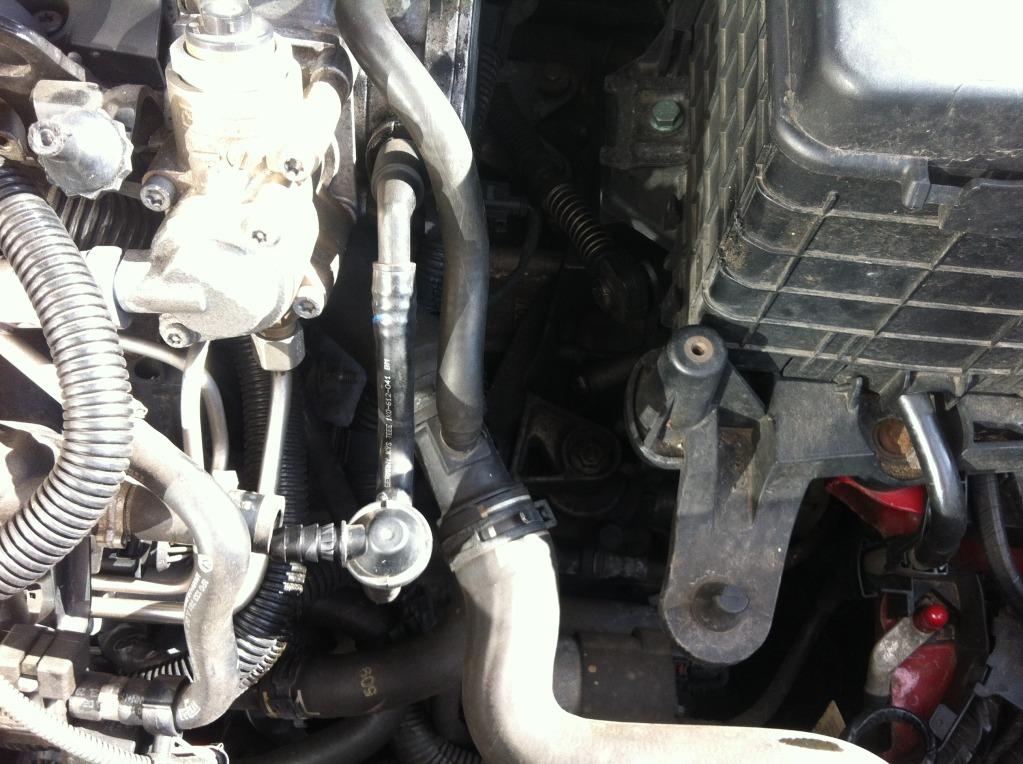

Just been and had a look again and I can see which pipe you mean now from this image..
Mine wasnt actually touching there and infact mine already seems quite short and out the way.
It seemed to be touching more on the larger pipes underneath?
