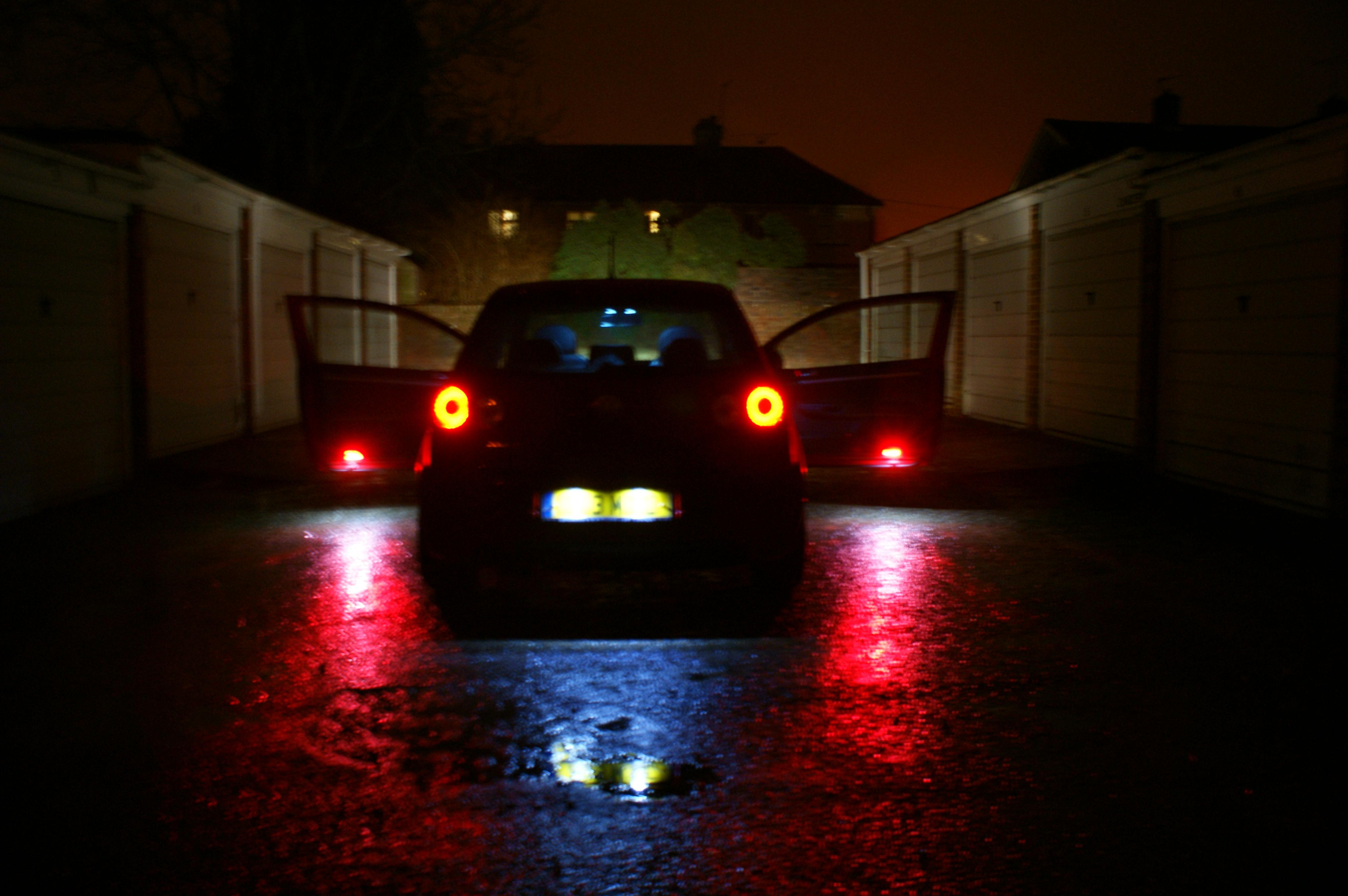

Re: LED Rear Light 'Polo' Mod
« Reply #2 on: February 25, 2013, 02:47:29 pm »
Like mine below Kalpesh?
It is only coding that's required, only the outer portion of the LED's are lit and then the whole unit lights up when the brake is applied. Does need the inner units doing now IMHO.
Sorry for the dodgy pic, the lights are red, honest.  :laugh:
Yes that's exactly what I'm looking for Martin :happy2:
How can I do that? What coding needs doing?
« Reply #6 on: February 25, 2013, 05:33:48 pm »
It should be the full ring as standard. I sorted Richwig's out the other week. If you have access to VCDS send me your long coding for address 09 and I will take a look at it.  :happy2:
Not on the Valeo LED light clusters (which i and Kalpesh have) as the whole unit is lit when the park lights are on, to get the "Polo" look, it needs coding.
@ Kalpesh
I had mine coded by a chap who mainly frequents the R32OC site. Try Eddie or have a look through this thread from the golfmkv.com site......
~~ Clicky here ~~
