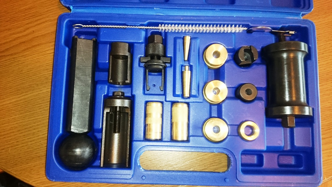

Brushes for intake valve cleaning:
Injector tools:

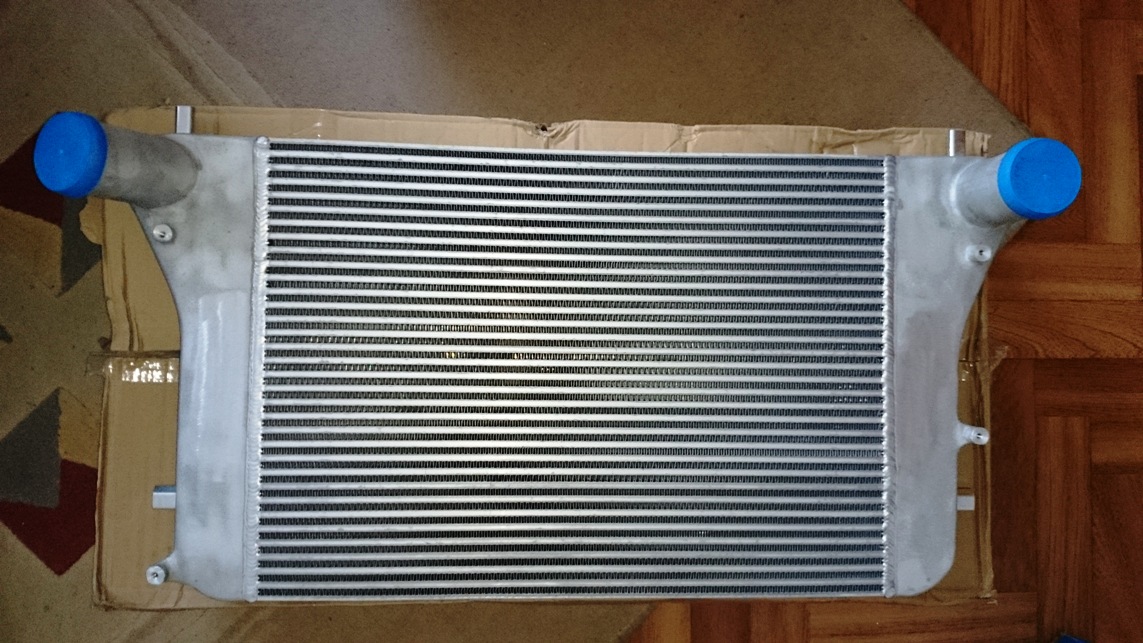

It's time for bigger intercooler :)
And hoses shipped together with intercooler:

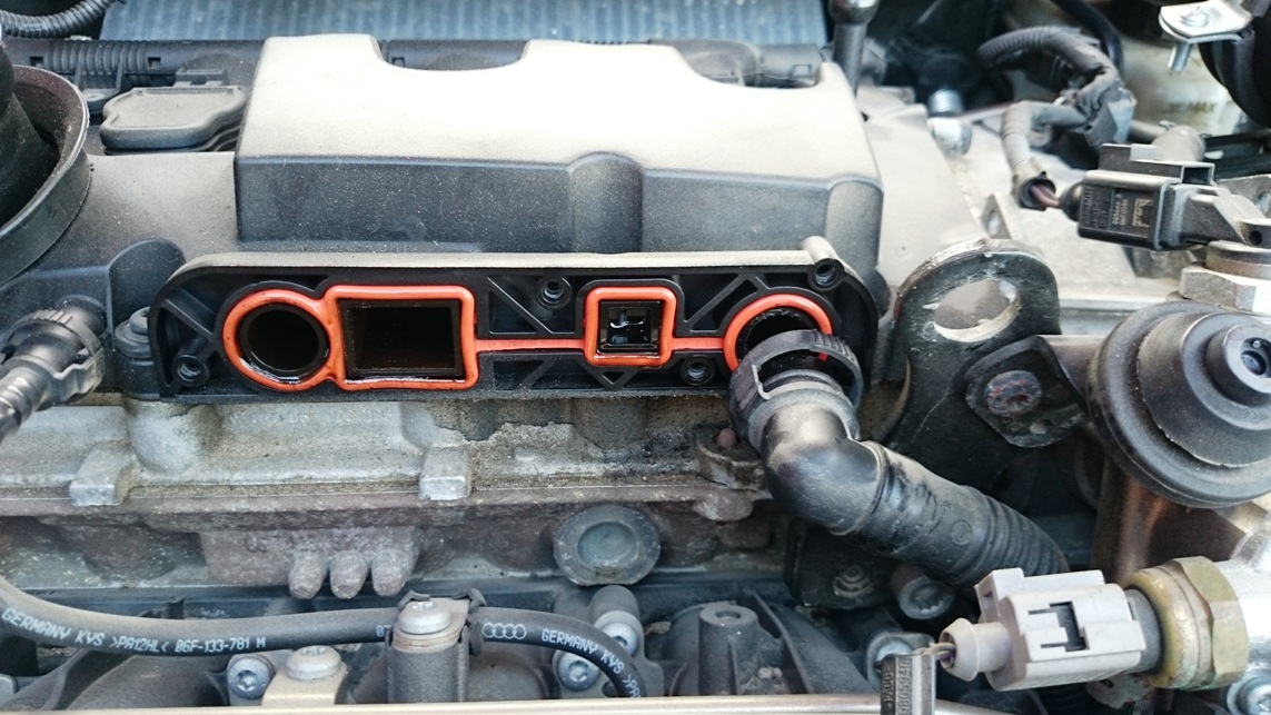

Im buy from HG-Motorsport PCV Fix valve:
Original PCV:
Removed original PCV:
Installed PCV Fix:

Then Im change intercooler and silicone hoses:

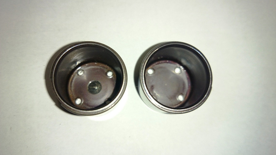

Cam follower after 30k km on Stage 2+ last time to replace them:

Did you remove the inlet manifold and other bits and cleaned the inlet valves ? What happens to the carbon ? It'll hit the turbo blades ? Then block the cat ?
Did the IC fit on ok with no modifications ? Is it like this one ?
http://www.ebay.co.uk/itm/UK-VW-GOLF-GTI-06-10-2-0T-TURBO-MK5-FMIC-INTERCOOLER-KIT-VERSION-2-/331368888539
Core length: 24"
Core height: 16"
Core thickness" 2.25"
Inlet / outlet : 2.75"
End to end length: 28-36"

hi,
Yes Im remove intake manifold, because Im instal S3 injectors... In same time Im make valve cleaning... When you cleaning valves your piston MUST be in TOP position!!! Before you go to next cilinder valves you MUST vacum all carbon so you can't have any carbon part in your combustion chamber because it will make damage to your engine!!! When you finish cleaning first cilinder you must by hand turn your engine "belt" and top next piston...
IC fit without modifications. Only part which missing are BOLT's and you can't use original ones... It looks same but I can't confirm if is real same :) My cost me 220GPB with shipping but now has seller increase price and cost 560GPB with shipping to me...
