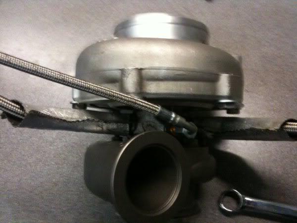

Anyways, bit of a teaser pic after todays progress..
"The purple pedestrian pleaser" (as Andy called it) lol..

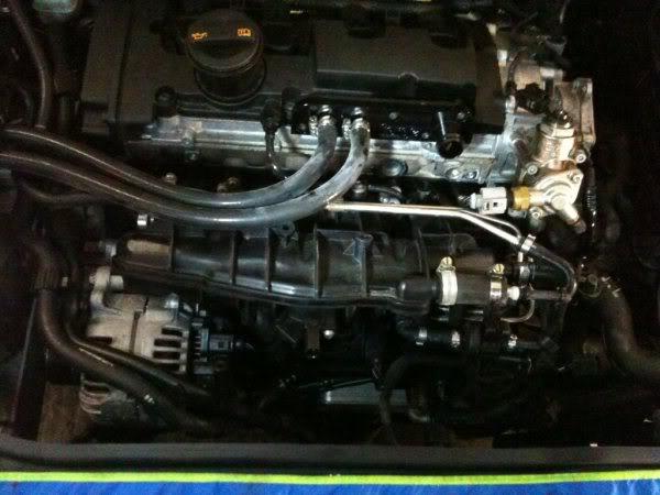

Update from todays work!!

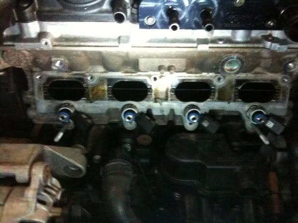

So finished up the injector install, inlet manifold is back on and bolted up!
New RS4 injectors in..
And the inlet manifold bolted back up!

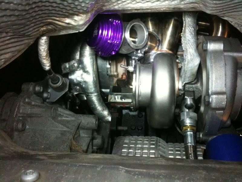

Wastegate is on the manifold, turbo is clocked into its final position, all the lines are connected and there to stay..
And the money shot!!
Tucked up!

nice one jonny , been trying to get some info on the rs4 injectors ,i don't really know why  :laugh: but very little info on there capabilities suffice to say they must be at there limits with a gt3076.
I would be very interested to know your duty cycles when you get it mapped.
Its a bit of a grey area to be honest.. There are some test results out there which came to the conclusion that the S3 injectors actually flow more than RS4's but thats just not true.. S3 headline before the AFR's get dangerous is around 400hp, the RS4's, closer to 500.. The 3076 will out flow the RS4 injectors easily..
Im sure ill be able to get some figures on duty cycles at different boost levels..
you may have posted this before but will you be going for the same map as on the S3. but without the running in period as the S3 was basically rebuilt from the bottom up?
Yup, same map.. But yeah this time I will be able to start logging and adjusting settings from the start as the engine is ready to go (upto a point of course)

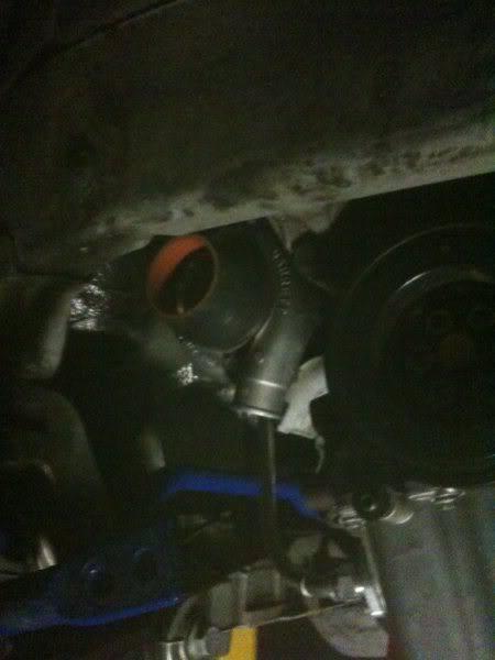

is the Tial EWG port facing downwards at the mo?
must be a bit of bit of bugger to route the dump tube back round to the bonnet side! Or am I missing something....
To start with the dump pipe will be routed down to the floor, to have the dump pipe out the bonnet is going to require quite a few changes, new intake, fabricate a new dump tube, modify the bonnet, re route some hoses for the heater etc.. Should only take a day but ill just get it up and running first, then do it..
