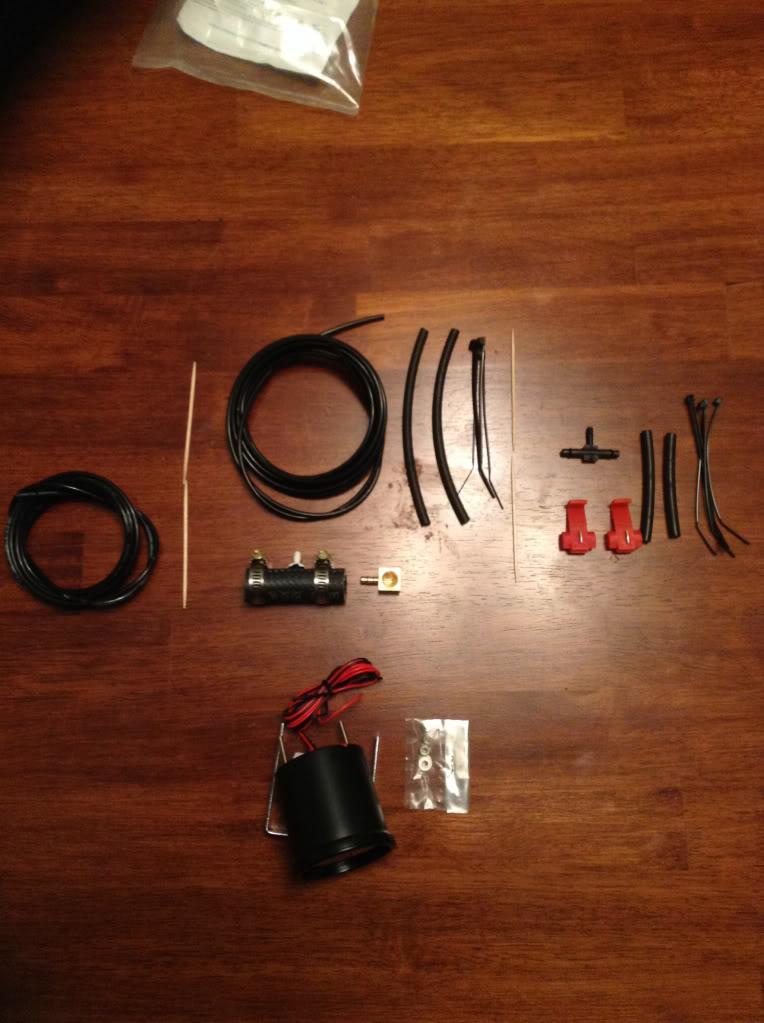

« Reply #13 on: November 27, 2013, 10:43:57 pm »
Here's all of the consumables that come with awesomegti's newsouth/column bundle  :happy2:
Hope you can rule out what is needed and what is not
Re: Boost gauge
« Reply #14 on: November 27, 2013, 11:22:24 pm »
^^^^ Brass bit attaches to the rear of the gauge. One of the 2 short silicone hoses attaches to that. Inside that fits the long/thin/main hose. Cable ties are to keep those bits together. Don't attract anything up until the long hose has been fed from the engine bay or the cabin though. The other short silicone hose attaches to the other end. I'd use the breather hose section, it has the tap in it to attach the silicone hose to.
