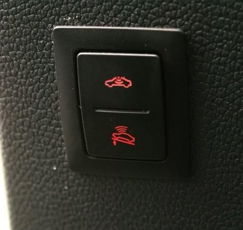

The red light will flash anyway on the door
You can verify you have an alarm by checking on the drivers side door pillar on the inside there will be 2 buttons for the alarm controls and on the passenger side between the front and rear doors on the roof there will be a sensor unit.

Image of switch
http://www.ebay.co.uk/itm/VW-Skoda-SEAT-alarm-deactivation-button-6Q0962109-New-genuine-VW-part-/110876181427
Imports some come with alarms and some come with electric seats - anyone else got them on their MKV?

That switch in the link I have that on my driver side b pillar, can't see anything on the passenger side tho

I've just been outside to take some pics of what I have
This is on the driver side B pillar near the bottom
This is the passenger side one on the roof lining
They look different from what you posted Xjay
