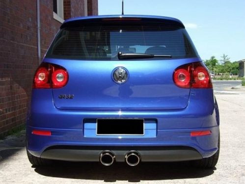

One of my first plans with my 2007 silver edition 30 is to get a de-cat turbo back Milltek put on, but am considering also attending to a little pet hate of mine.  As much as I love the aggressive front end of the Edition 30 versus the R32, I despise the rear of the ED30 and prefer the R32 rear.
Noticed on eBay there are some rear valances you can buy to effectively have an R32 look or quad exit look.  Is this is a common modification or is it considered sacrilege on a limited edition car such as the ED30?  Any members had this done and can offer any tips or advice?

Now about that rear bumper... It's your car so only you can decide. However if you decide to get an R32 rear, personally I would go for a genuine one as the replicas are not a great fit or quality.
Lastly I would look into BCS exhausts as there a 76mm system and aren't prone to cracking like the Millteks :happy2:

Get a geniune R32 rear end, usually around £200-£300 inc diffuser, reflectors etc. plus those cheap copies are prone to being a sh*t fit too. If you do get a OEM rear then I'd also get the supporting brackets (only a couple of quid from the stealers).......
LH Support 1K6-807-739
RH Support 1K6-807-740
As mentioned if your getting a full exhaust system then look at BCS. I have an Eddy with a BCS Powervalve 200 cell Sport cat TBE with normal GTI/Ediroin30 exit tips. I also have a OEM R32 rear end for my Eddy with a BCS R32 rear assembly. Whichever style of rear you go for you can easliy replace/change the exhaust as its only the last 24"s or so that gets changed unlike a Milly which will be a whole Cat Back required.

For genuine R32 bumper part numbers, look at my project thread. I've done the swap on a standard GTI and the only thing I'd do different is use a BCS system instead of Miltek.
Your ED30 bumper will sell easily enough to recover cost.
