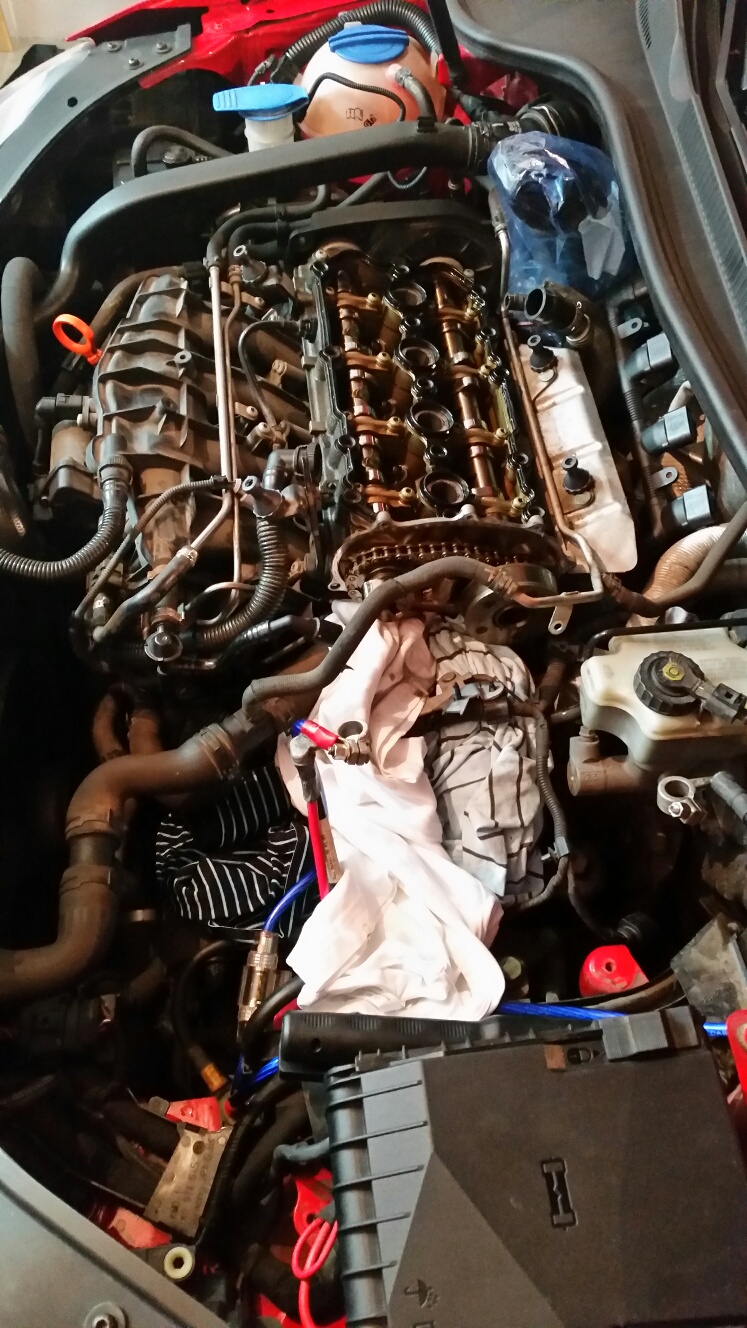

So 25 mins of hammering and nothing. Took the pry bar to the right hand side and it popped off. :jumpmove:
This is where i am at now.
The wobble bar extensions i bought are a must have. Especially the 1/4 inch ones.
Hope the wife does not see the t-shirts her parents bought me.

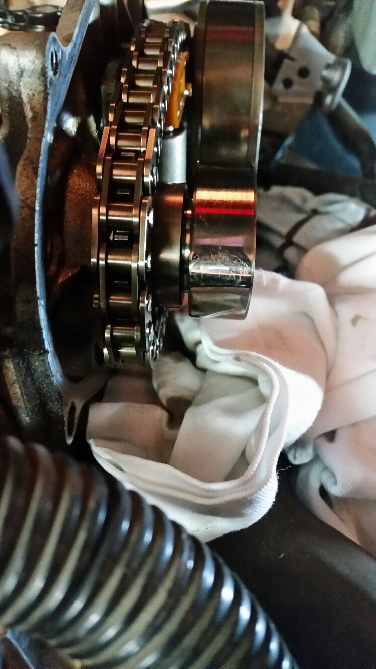

The chain seems under tension so i'm probably wasting my time. Any way to tell if its fuc*ed?
A couple of things slight marks on inlet cam?
Is the adjuster supposed to be all scratched up?
When i break it or can't put it back together anyone fancy a trip to Barcelona? :party:

I don't really know what to do now. Been reading a lot of posts regarding the 05 AXX engine and a lot of people have said changing the chain and tensioner did not solve the noise. And the adjuster was to blame.
I will be gutted if after all this work there is no change.
Options.
Install new chain and tensioner see what happens?
Purchase adjuster and cover?
Thanks guys don't think i would have got this far without your help.
