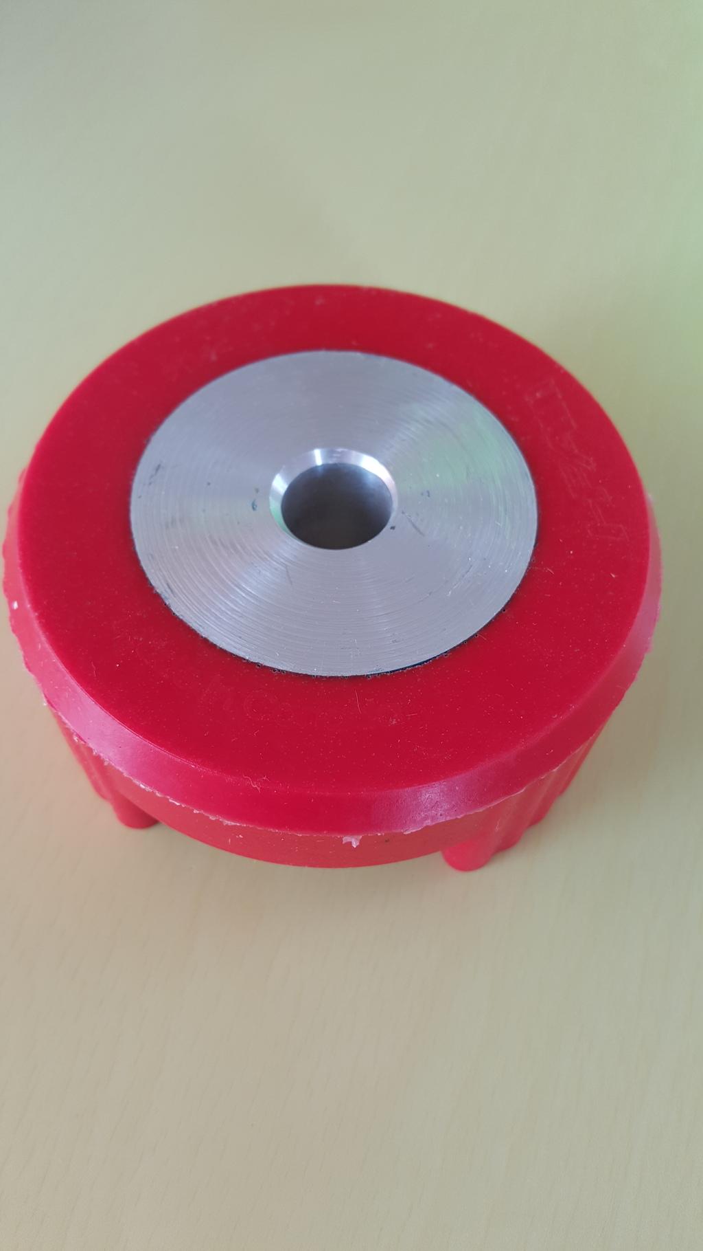

Weighed my old wishbone and control arm 4.7 kg,ill try and get hold of the superpro version ive got on to weigh the differences ;)

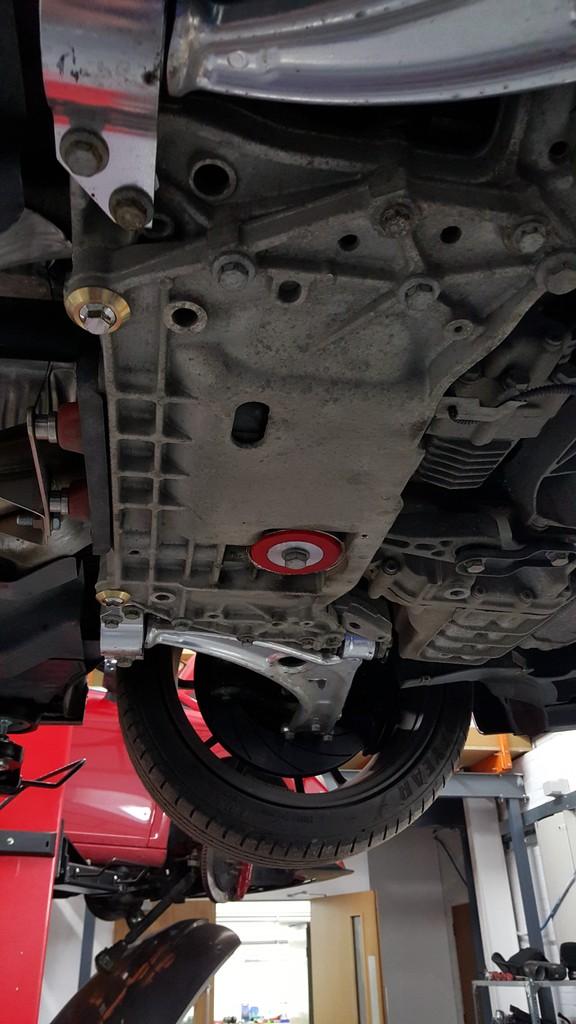

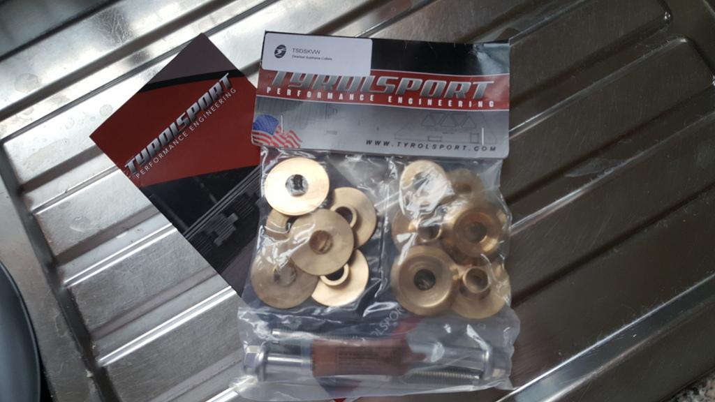

Received my Hpa dogbone mount today and thinking of going for the tyrolsport subframe kit,just waiting of a few reviews from other members etc

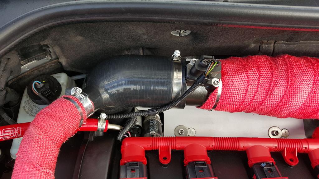

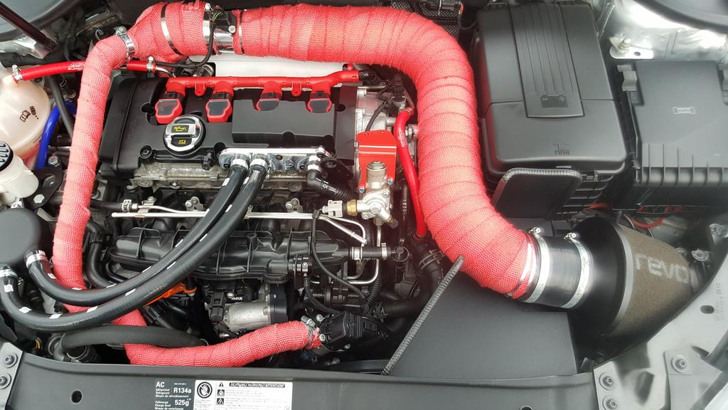

Hpa mount and tyrol deadset kit ready to go on

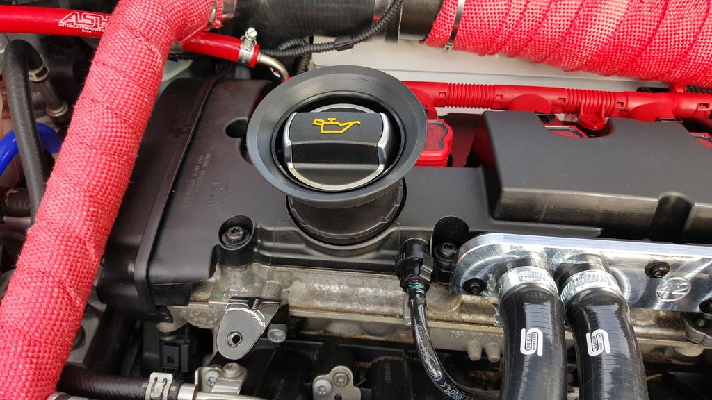

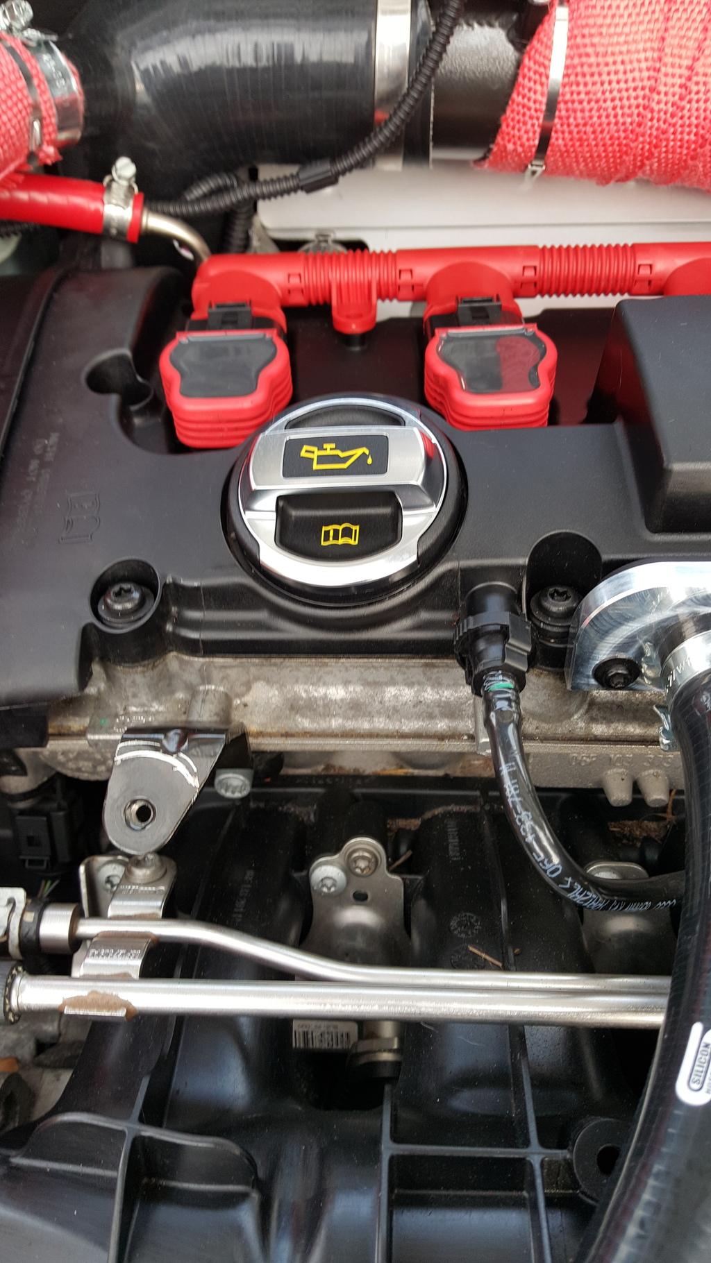

finally got myself an audi R8 oil cap to get rid of the filler neck

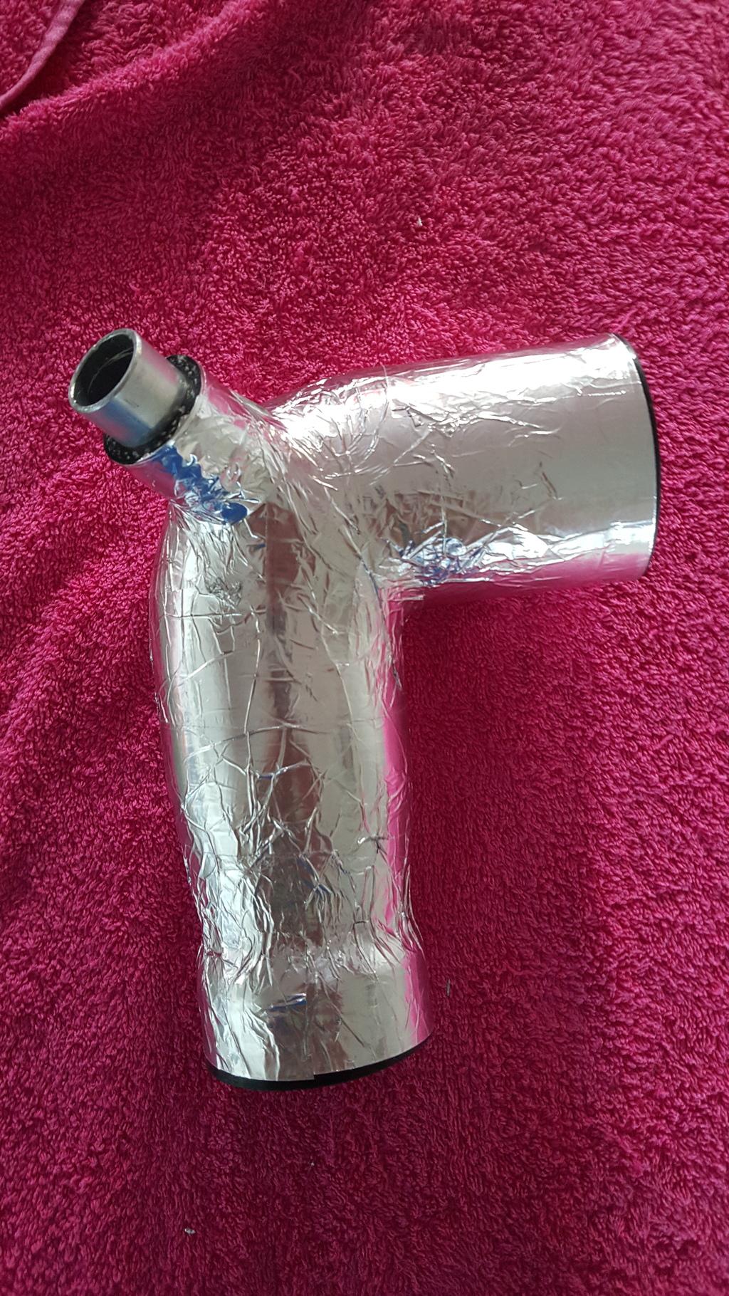

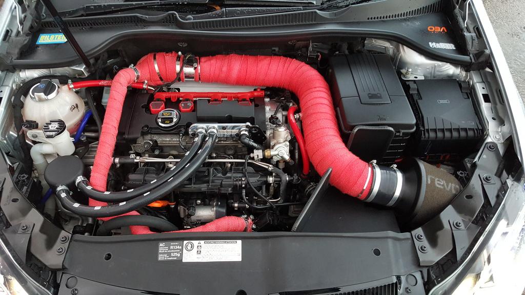

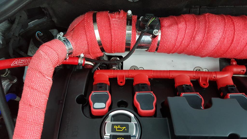

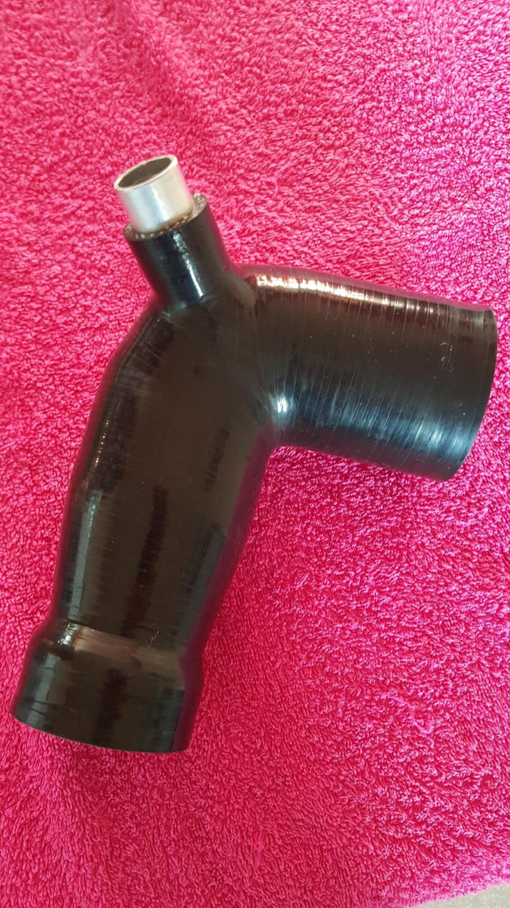

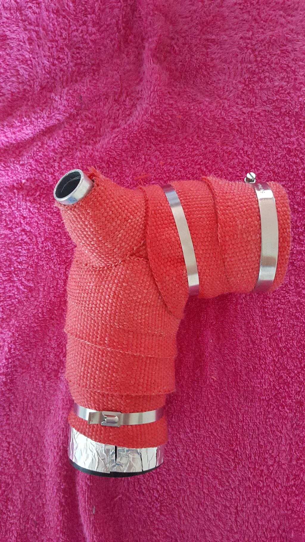

lastly finished of wrapping the last of the induction pipe with the bits of exhaust wrap i had left over(doesnt look pretty but its more for performance based)
taped around the Maf housing aswell
Golf R mk6 R-tech tuned GTX3071r

Was working in my bay today and seeing your engine has made me realise my engine needs a bloody good clean.
Your intake looks like its in a plaster cast now  :smiley:

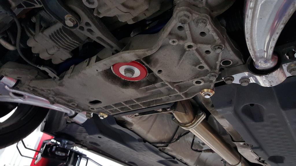

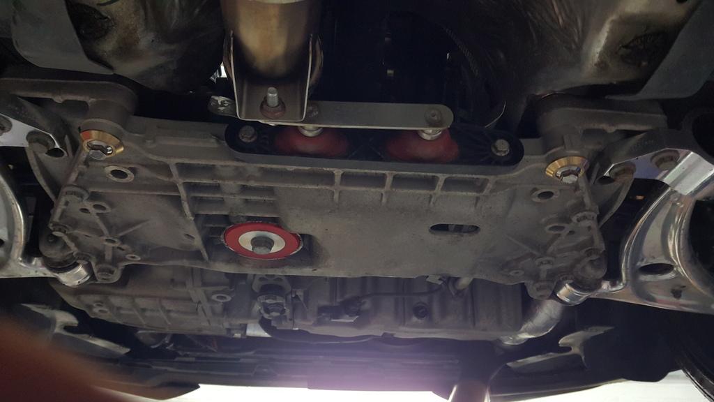

Firstly a big thank you to Alex for his time and effort getting all this work done in 1 go :)

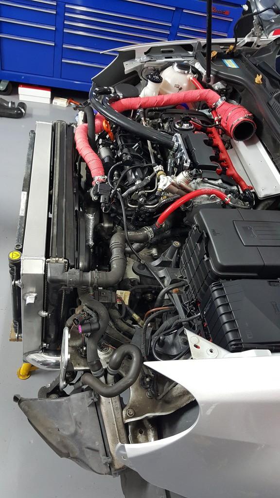

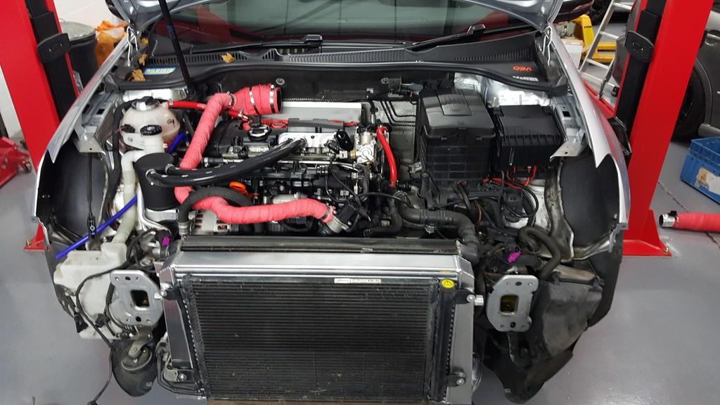

after a long day at Aks Tuning in bedford on friday the work was finished about 10 pm lol

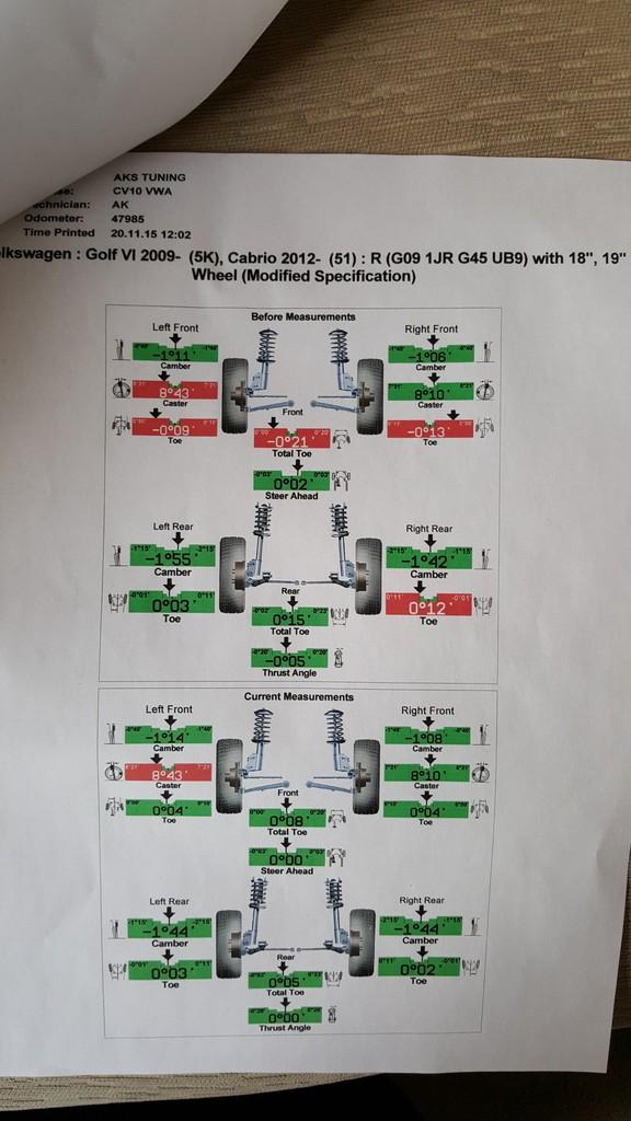

we had a plan to do the work with me taking down my tyrol deadset kit and Hpa mount to fit if we have time,Alex spoke to me first thing and thought he'd be better off to fit the kit and mount first as it'll need a new alignment doing so he cracked on with that,back from the alignment back to normal after my other hub changes etc
now point and power with the steering again,nice and light,shifts seem and bit 'tighter' also after,the Hpa mount id admit a bit more cabin vibration but hopefully it'll settle in time

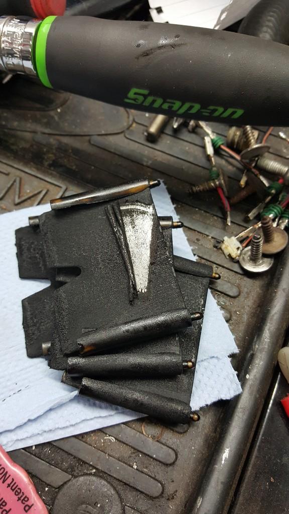

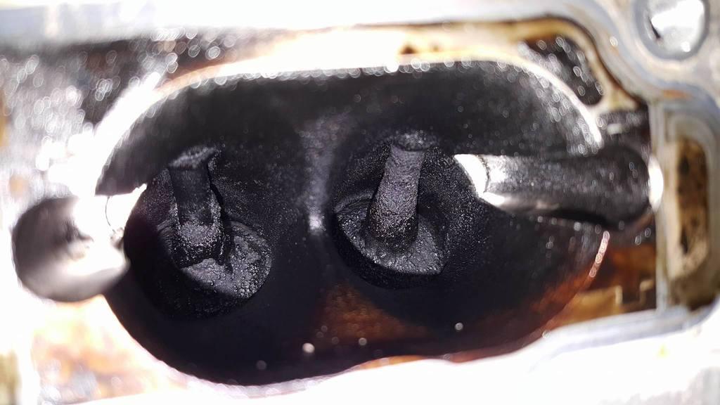

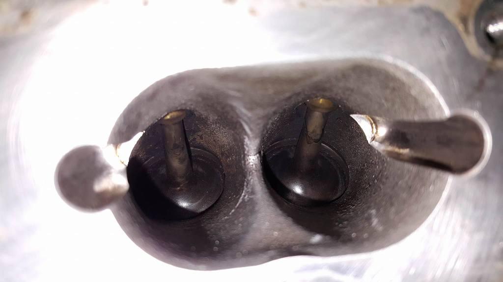

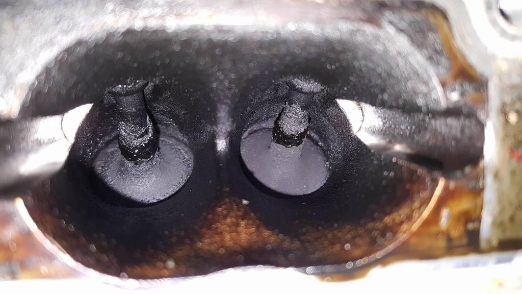

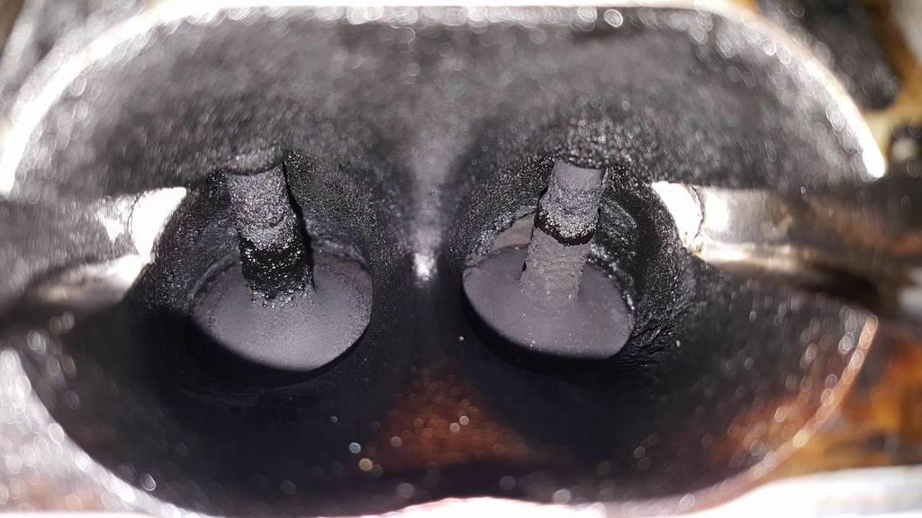

Onto the strip down for the Peron fmic change,everything went to plan to be fair,maybe a bit easier for Alex as he was removing the inlet for cleaning anyway

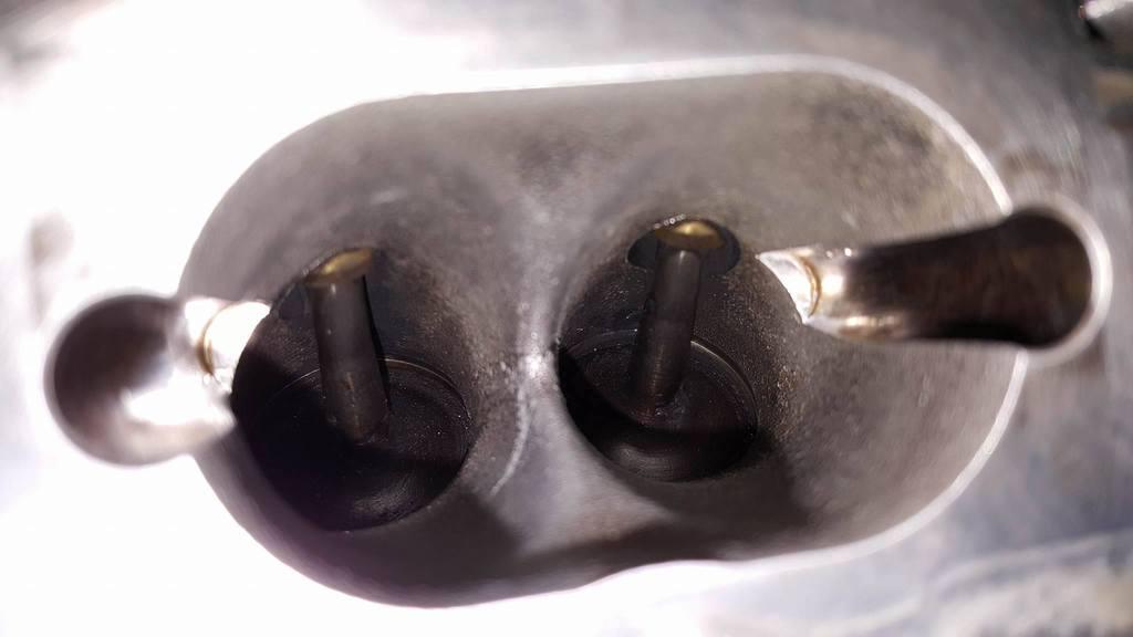

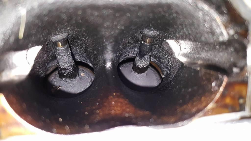

Now onto the Rfd delete and stems cleaned,these are at 47k miles,added new injectors seals also
finished
Methanol plate fitted
lastly the Ttrs lpfp fitted and vcds checked and all is well again ;)

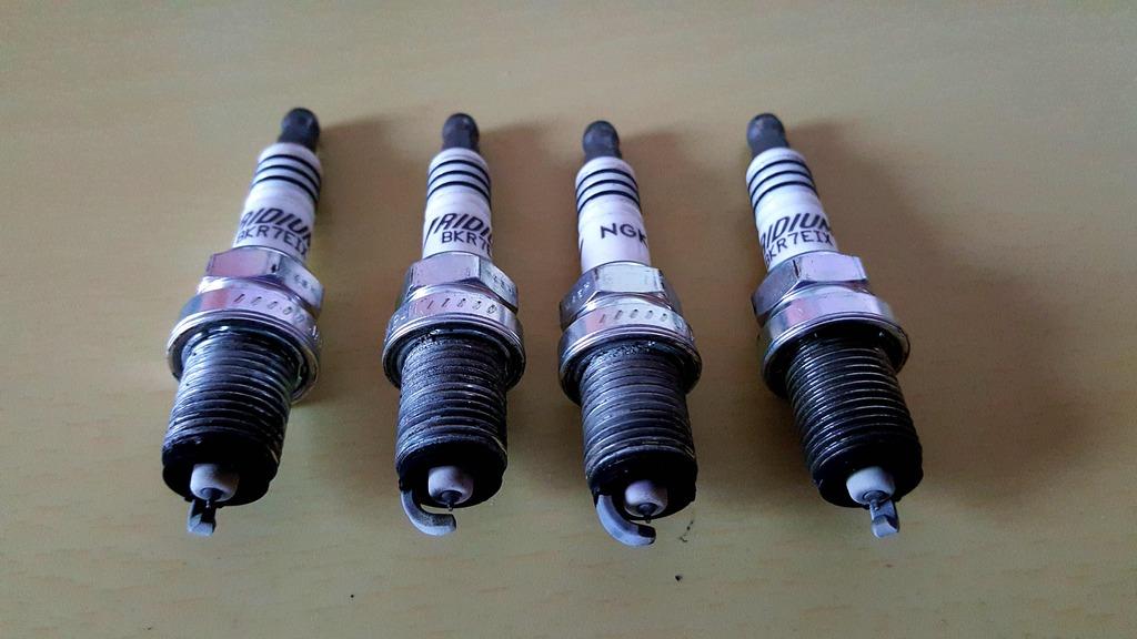

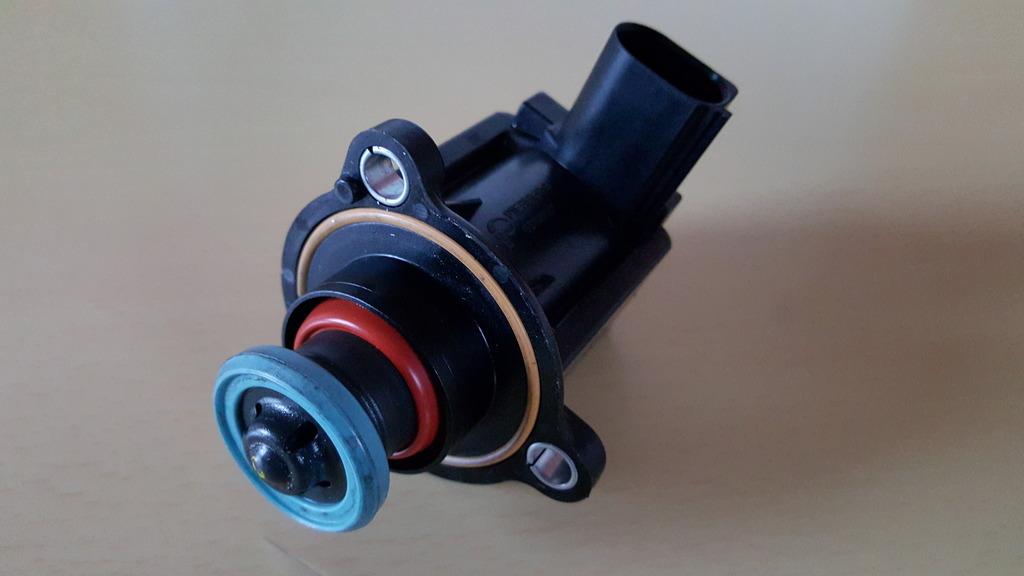

quick service parts done
catch can half full of what looked like urine lol
plugs,only done 2k this year on them
Rev G dv
ill keep them as spares incase any go down

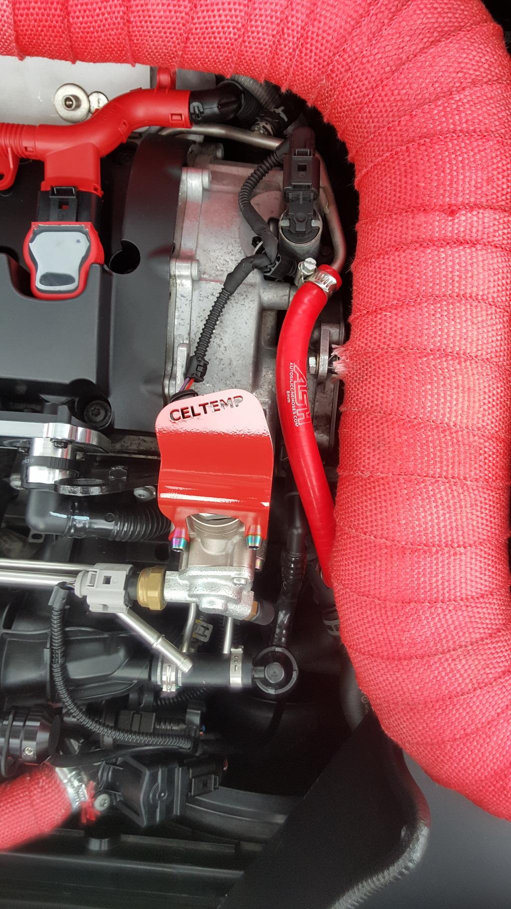

also fitted a Hpfp cover from celtemp that covers it from damage with titanium bolts

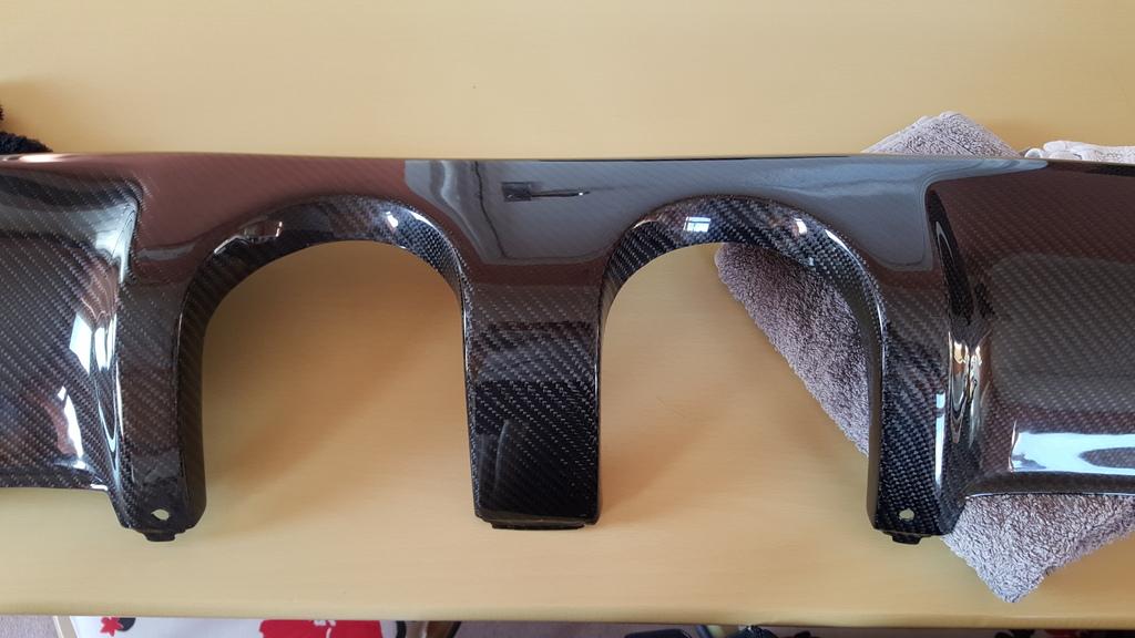

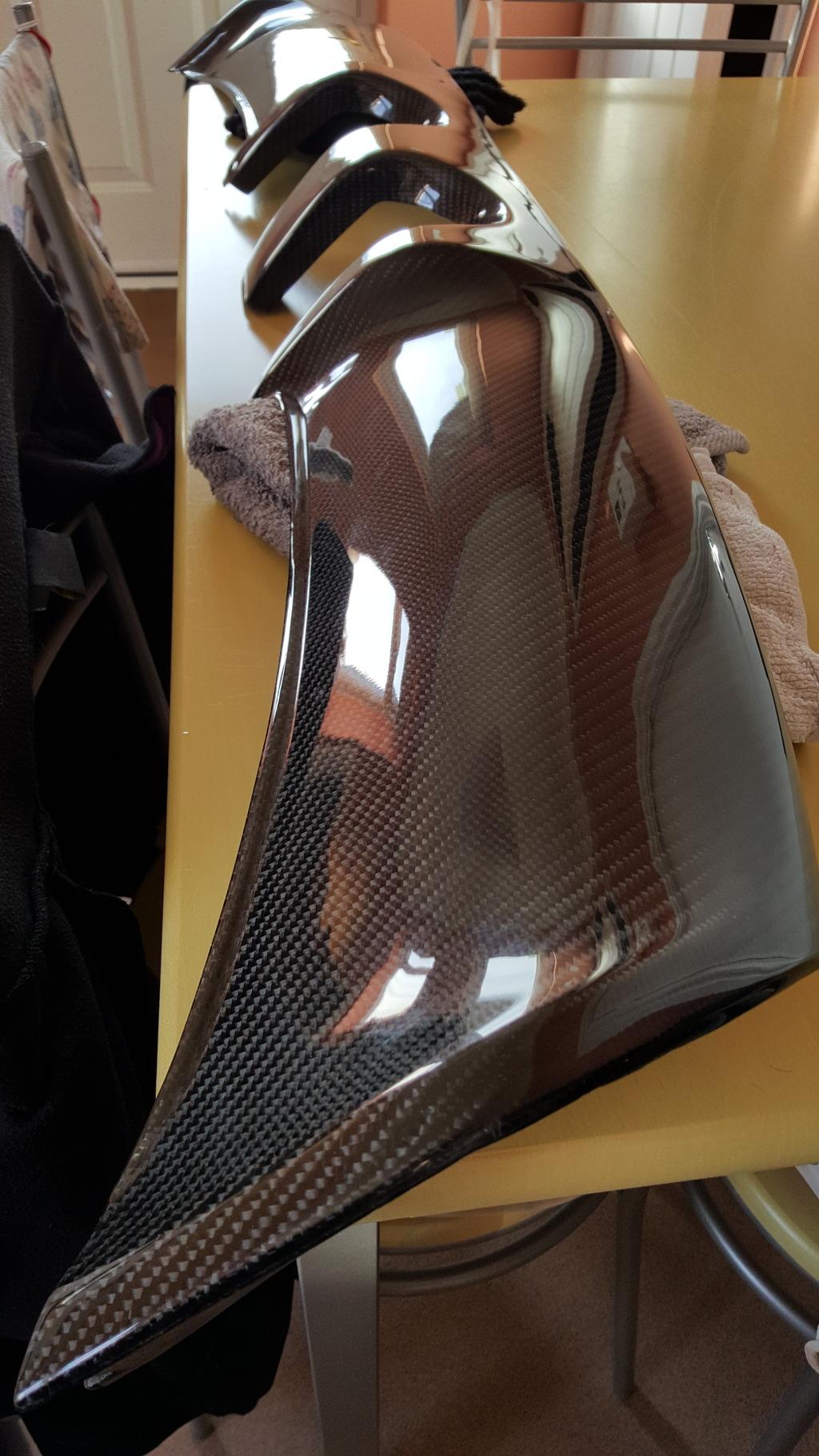

need to get my finger out and fit my carbon diffuser also ready for some shows,needs a bit of tweaking to fit propeer though

Lovely engine bay! What else can be said about the care this Golf has? :notworthy:

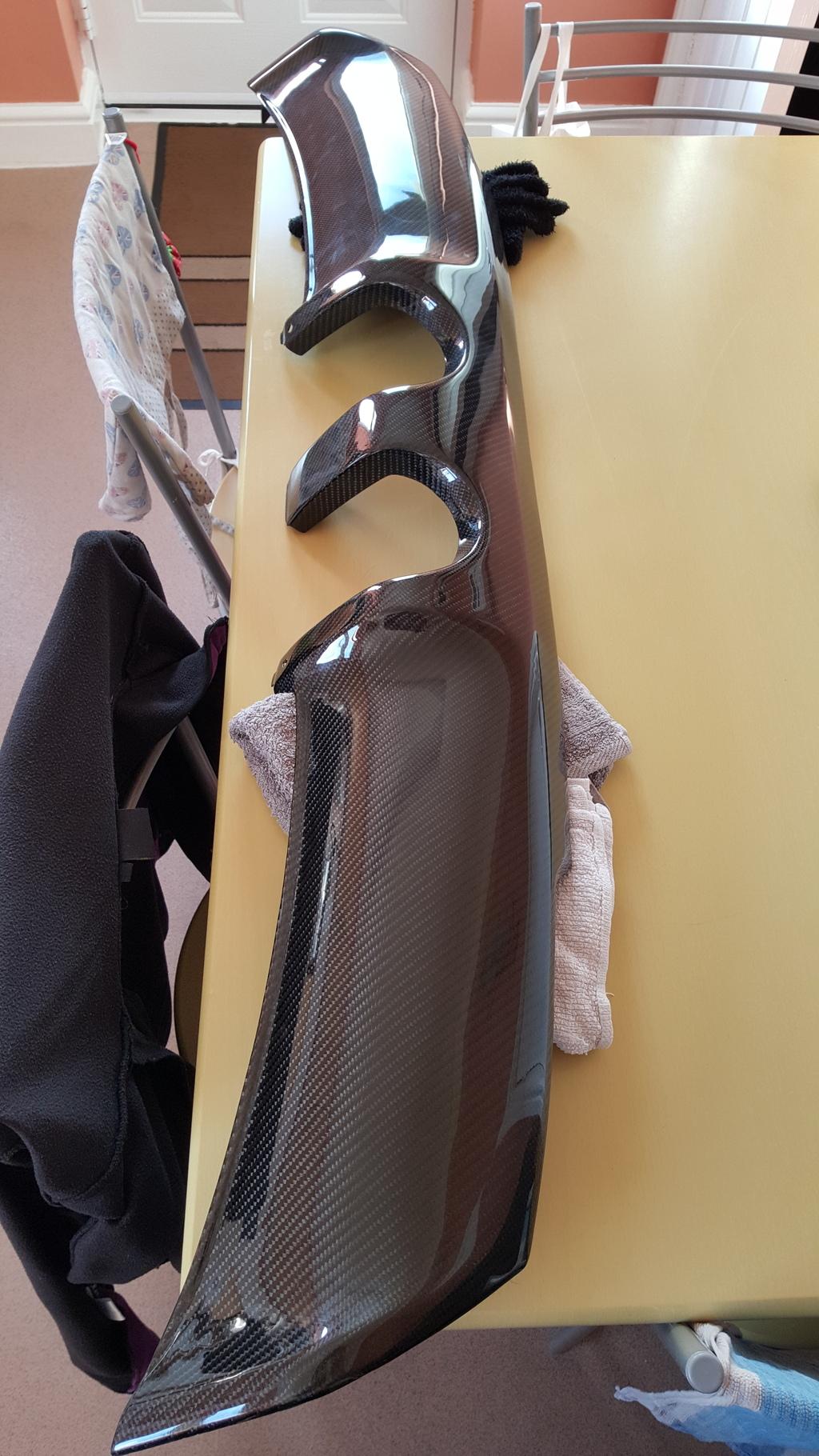

Where did you get that rear diffuser from?
Offline toosmiles
  • -Given: 22
  • Posts: 635
  • My Ride: http://www.mk5golfgti.co.uk/forum/index.php/topic,92286.0.html
Re: My Cupra K1 replacement-Golf R mk6
« Reply #175 on: February 07, 2016, 11:49:33 am »
Looking good!
Was the intercoolcer a direct fit or was there some customisation needed?
direct fit/replacement m8  :happy2:
cheers m8 :wink:

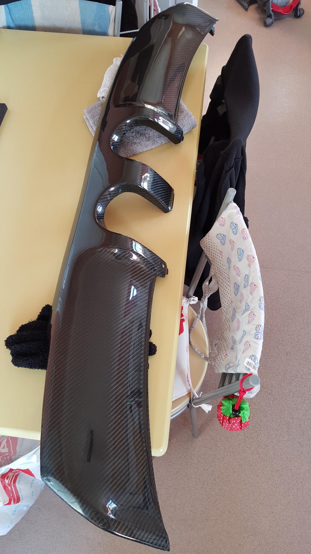

link of the Golf R forum mike  :happy2:

Diffuser looks great mate.  :pomppomp:
cheers Jay,may need a bit of modding slightly to fit though but shouldnt be a problem

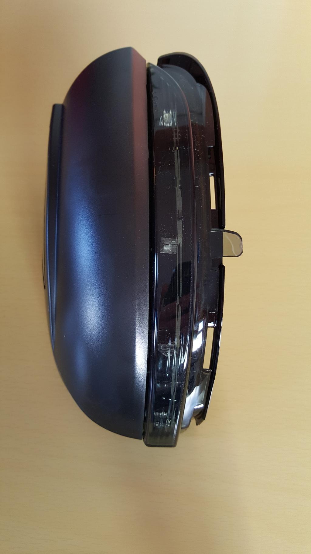

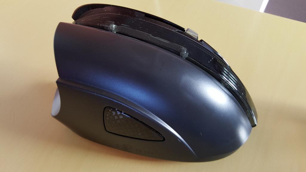

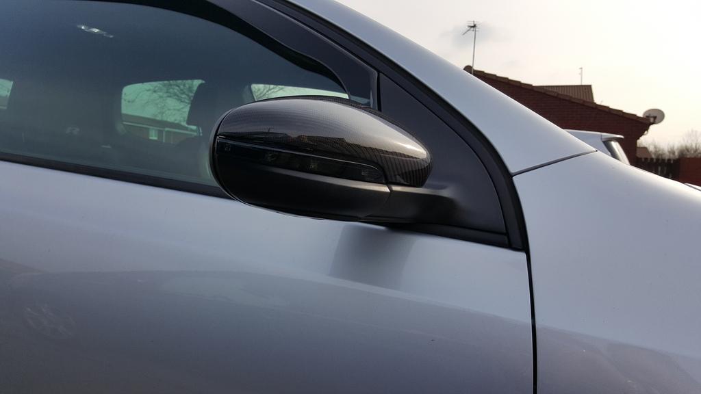

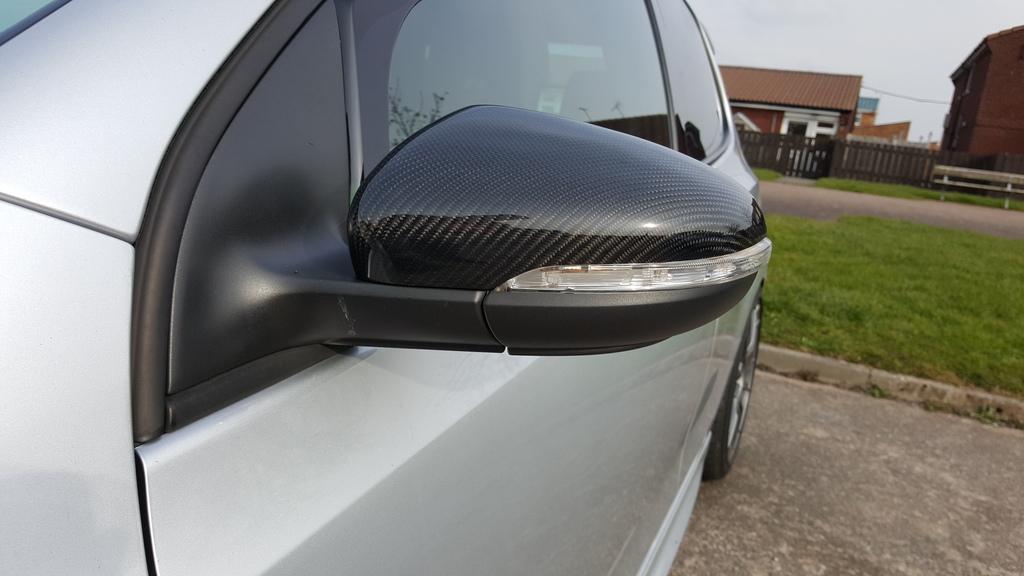

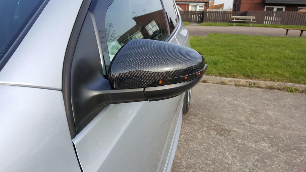

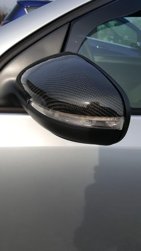

Finally got round to doing some off the little jobs today

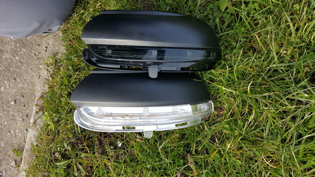

Had these smoked lens mirror in my watch list for months and seeing that mike bought some made my mind up to get some
old mirrors
new installed :smiley:

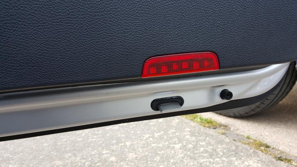

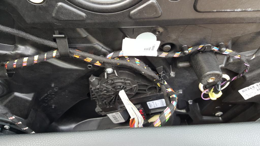

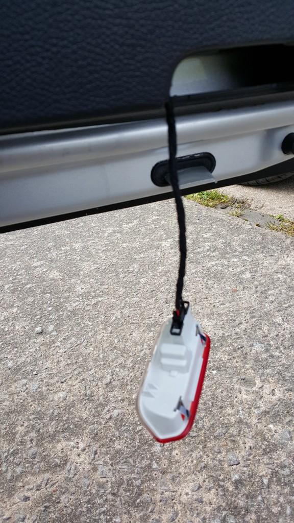

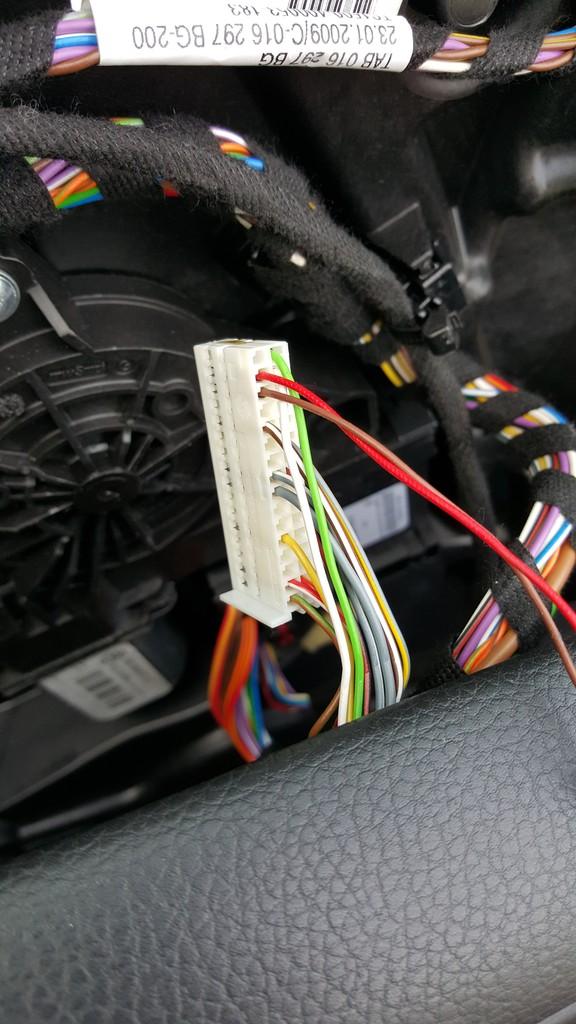

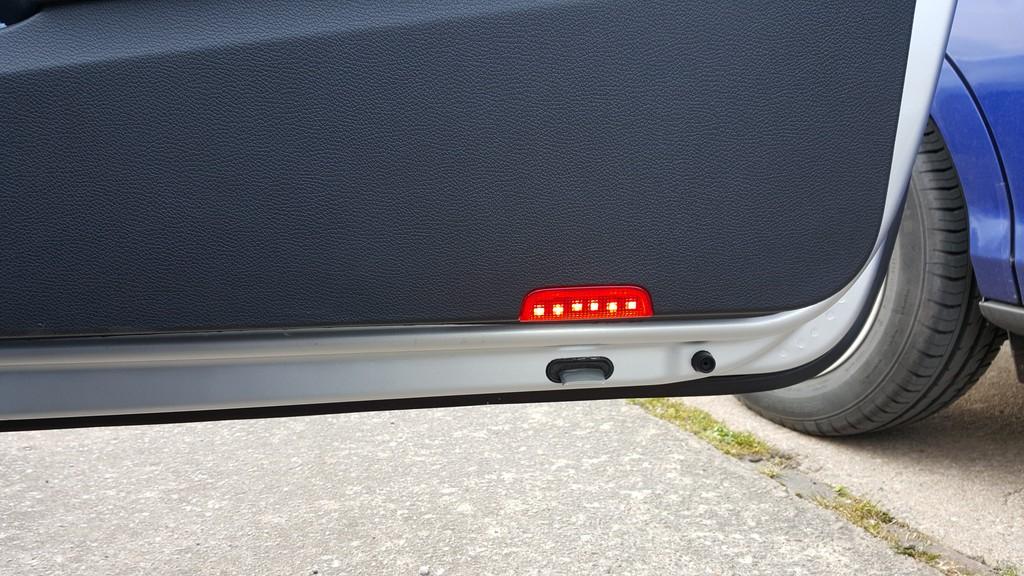

next job fitting the Bold Sport 3d door warning lights of a member on the mk5gti forum,luckily i enabled these with vcds when i had my battery problems
there just 3 bolts holding this on and some bloody strong clips lol i didnt remove the door card completely,just left the door lock installed,removed the window switch plug and left it sit on my mat as i could get at the door controller module easy enough,popped off the controller cap and added the live to number 18 and ground to number 19,this kit had pins on ready to push straight into the block
popped the cap back on and plugged in the controller module and nowt(damn)anyways i thought id whip the drivers door off and install this to check on the wiring etc,plugged it in and it came on straight away :innocent:
put everything back together as they were identical wiring etc and left it till i got home and checked with the vcds,looked into the drivers door coding and akll was fine so checked the passenger door and it wasnt coded in ready lol,enabled and voila:tongue: ,must admit these are bloody bright at night:cool:

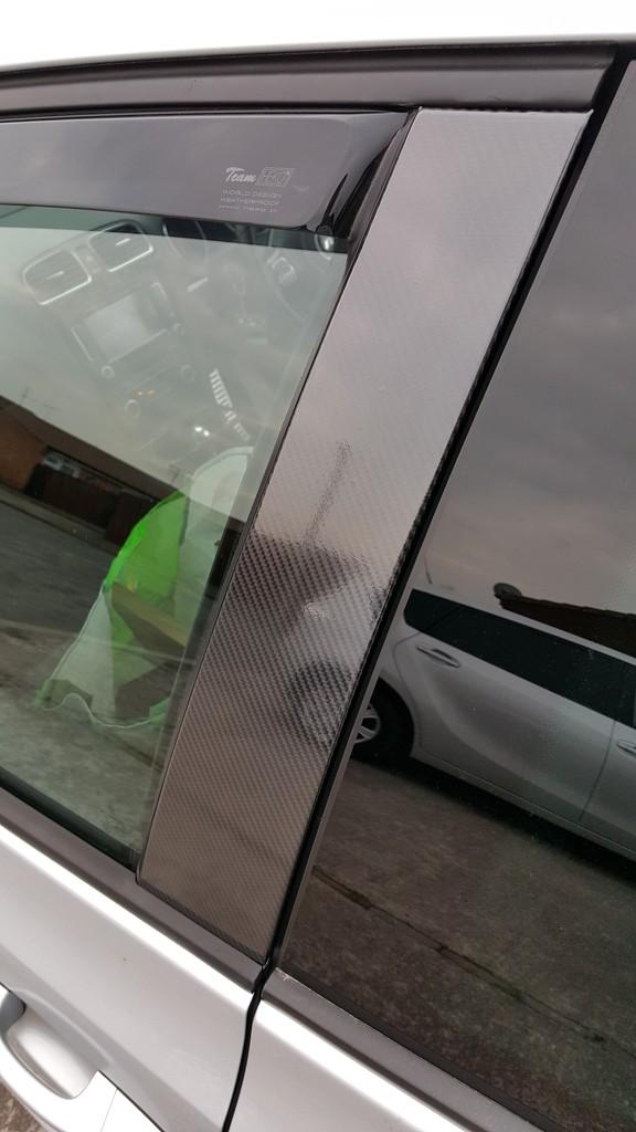

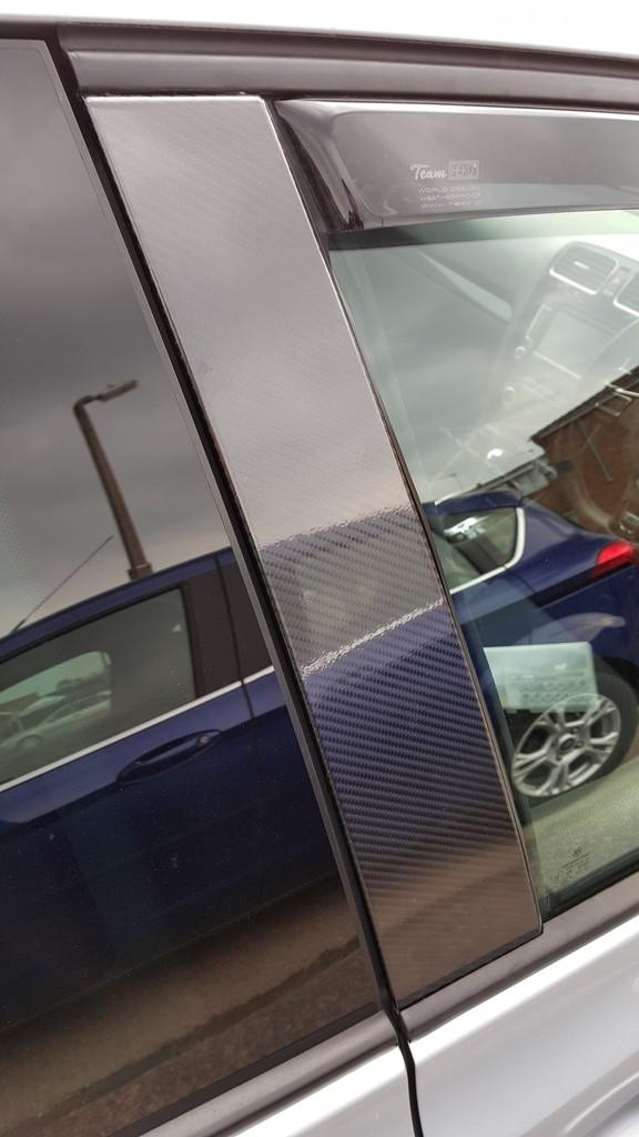

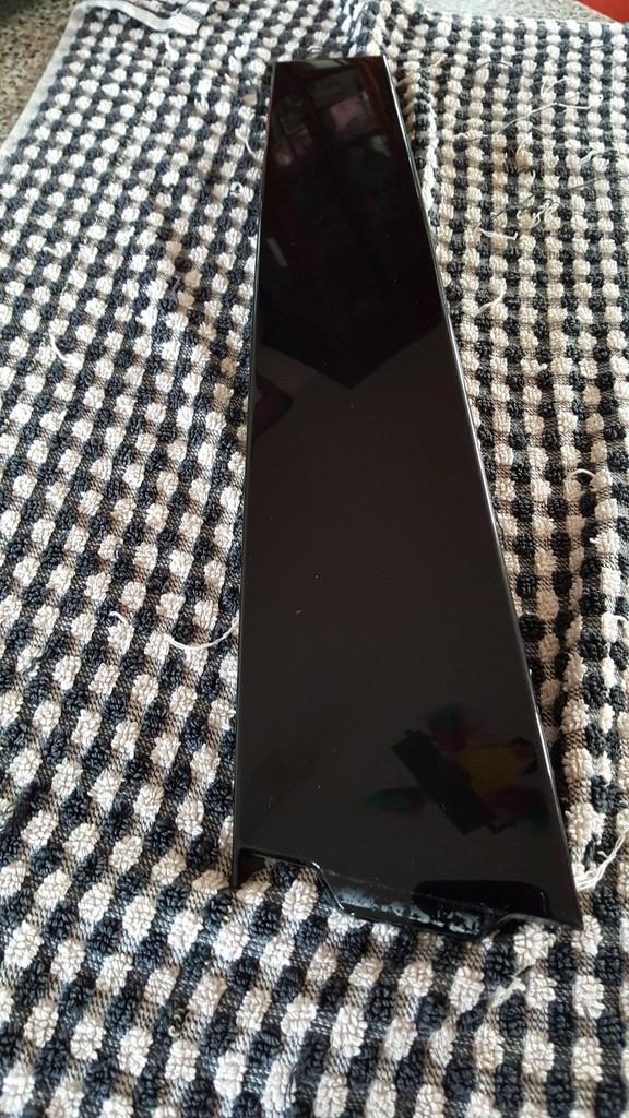

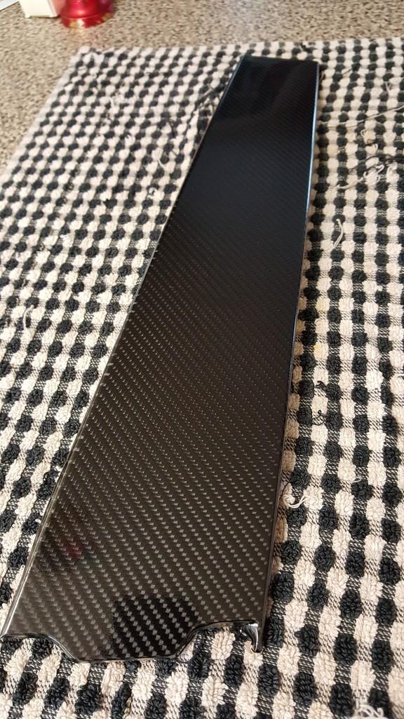

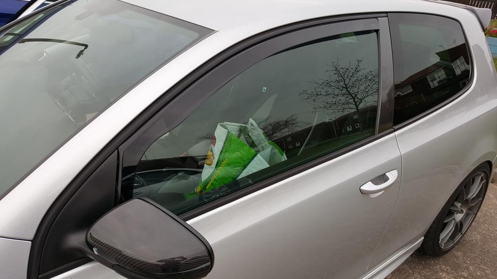

last job as i had some 6d carbon wrap left over from doing my dash trim i thought id whip my door trims off,window down and pull the rubber back and theres 3 hex screws
original is quite scratched but could of been buffed out,if i get bored ill just rip it back off
tbf it blends in well with the carbon mirrors
only a few more jobs to do now,installing my polar fis+,city lights and rear carbon diffuser
