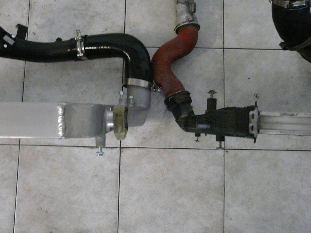

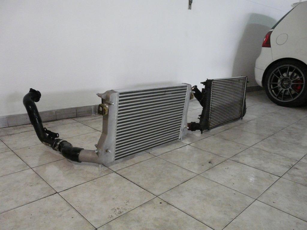

Here's another weekly update. :smiley:
My mechanic is still waiting for the last injector seal kit to finish fitting the intake manifold. He told me if he receives it next Monday he'll be able to deliver the car next week. Well, I can wait another week if needed, although it has been a long time since I drove it. :sad1:
Pictures to make this topic more interesting. :smiley:

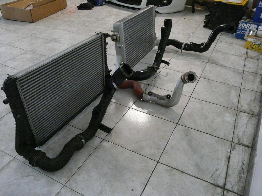

Darkside Developments S3 uprated IC with alloy end tanks, silicone boost hoses and CTS Turbo pipes vs OEM IC and pipes:

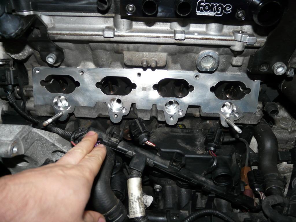

CTS Turbo RFD kit fitted to the intake manifold:

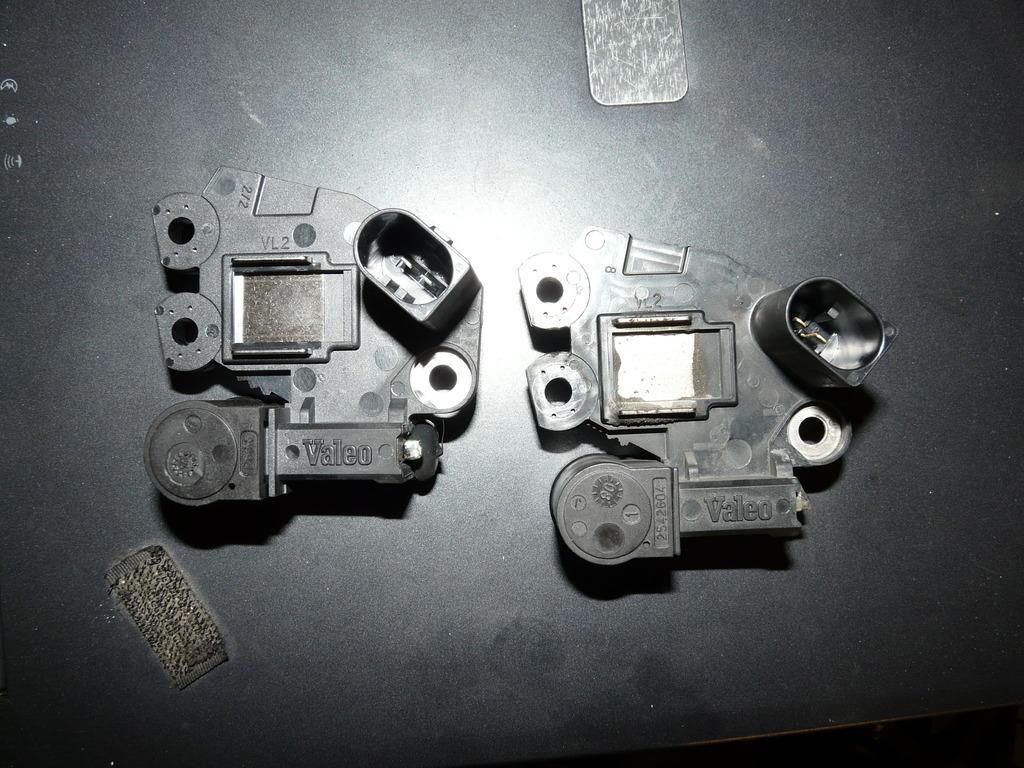

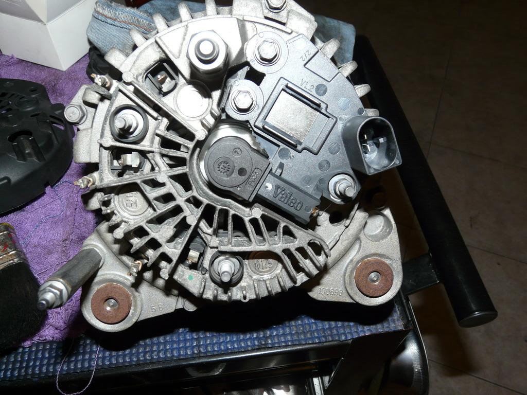

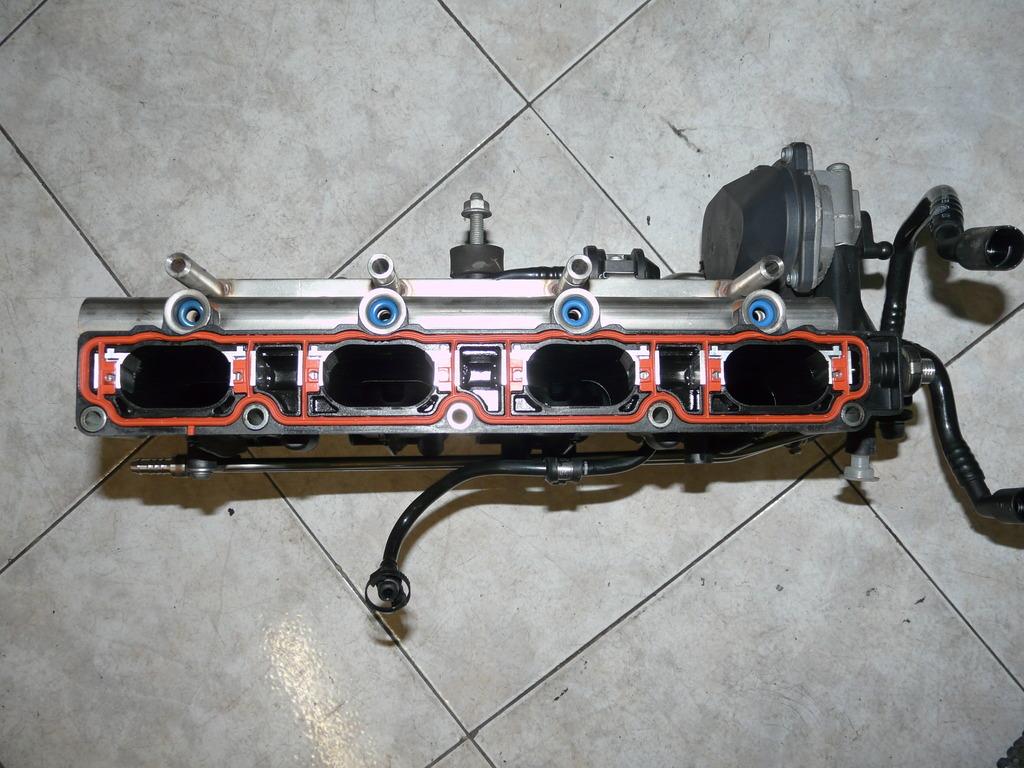

More pictures of the work done. :smiley:
Stem valves and injectors cleaned:
Alternator fixed:
My mechanic told me that these alternators are much worse quality than the mk4 diesel Golfs (specifically the PD150). Not sure how often people have problems with their alternators... :confused:
