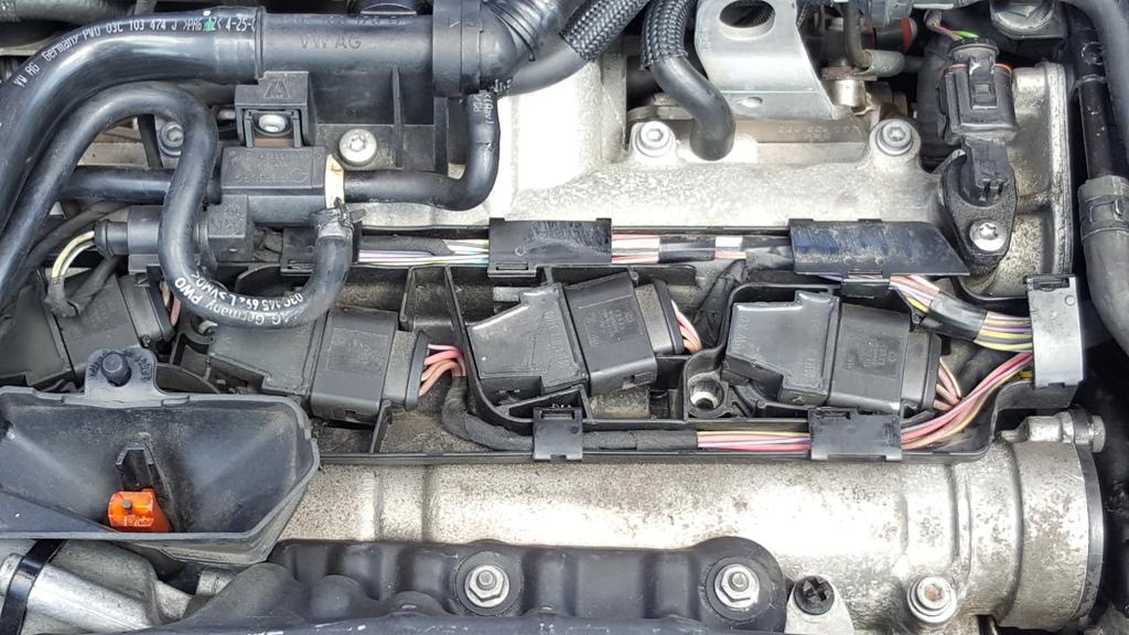

Driving home from work today and decided to boot it a bit after it was warmed up and my eml flashed and car juddered in second and lost power. So tested it out a bit and it's doing it most times under heavy load. I don't have a juddering idle just under load. Any ideas?

Update plugged into vcds and have misfire in cylinder 1 and 3

A misfire under load usually is coilpacks, or knackered plugs.   Misfires from injectors tends to be most noticeable at idle.

Going to fit tomorrow am I right in thinking it's left to right for cylinder number?

Can you not swap the plugs from one cylinder to another and see if the problem follows?
And same with the coil packs

Fitted my coil packs and plugs this morning took it for a spin and all seems good so fingers crossed it's sorted  :smiley:
