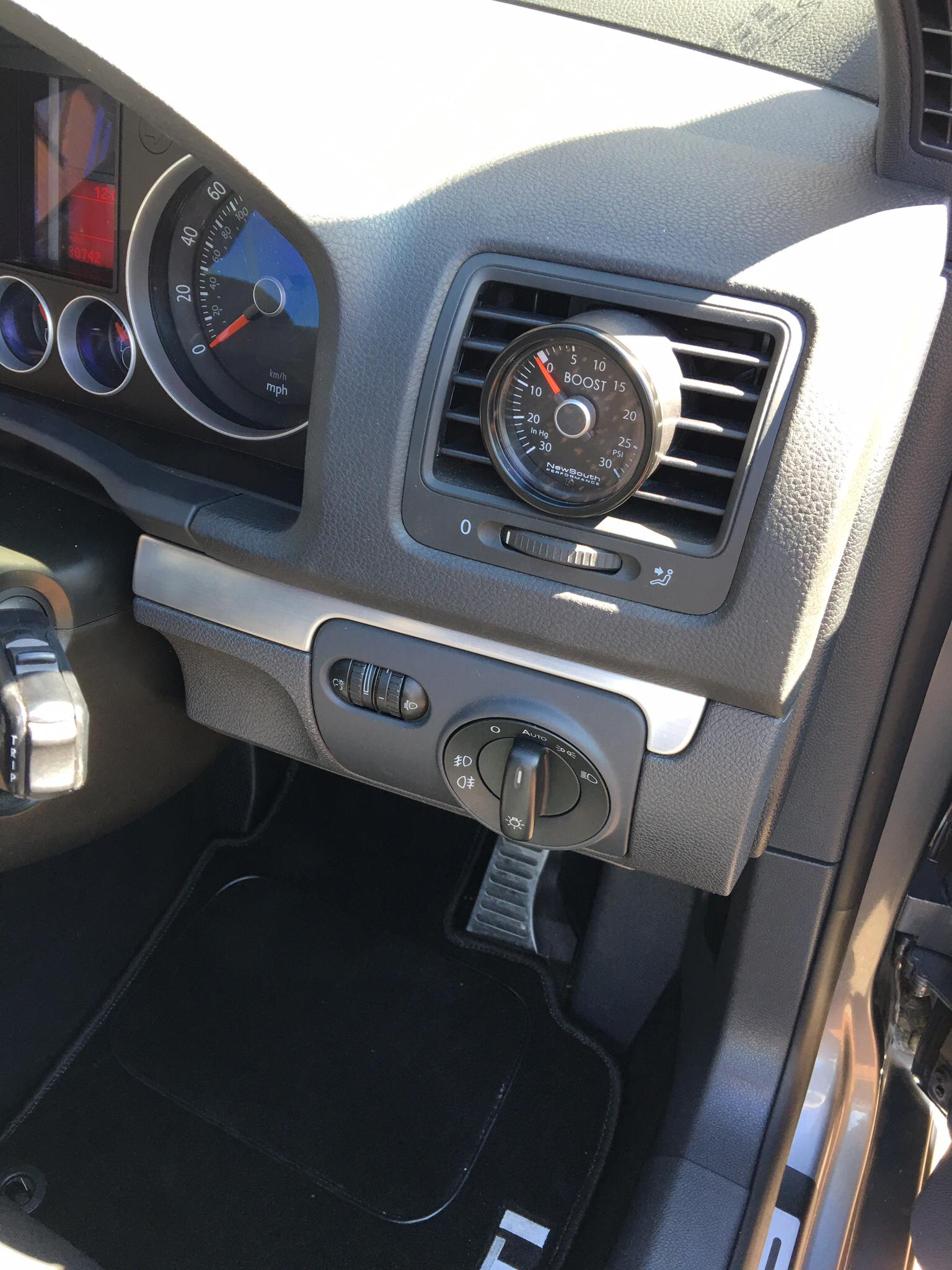

Not sure on the petrol ECU's but there is one limitation with Polar FIS, well it actually lies within the ECU when it comes to boost. It does with the Siemens ECU anyway. It is able to read figures higher than 1.6 Bar but cannot display them. If you log boost in VCDS, it will go off the chart at 2.6 bar (1 Bar atmosphere + 1.6 Bar boost). This also happens on the Polar. Mine maxes out at 1.66 Bar. My map is set to peak at 1.75 which I cannot see without a mechanical gauge.
Here is my gauge. Also Newsouth Indigo.
Will be getting a new south vent gauge shortly.
Looks like a proper little cockpick that pic! :driver:
