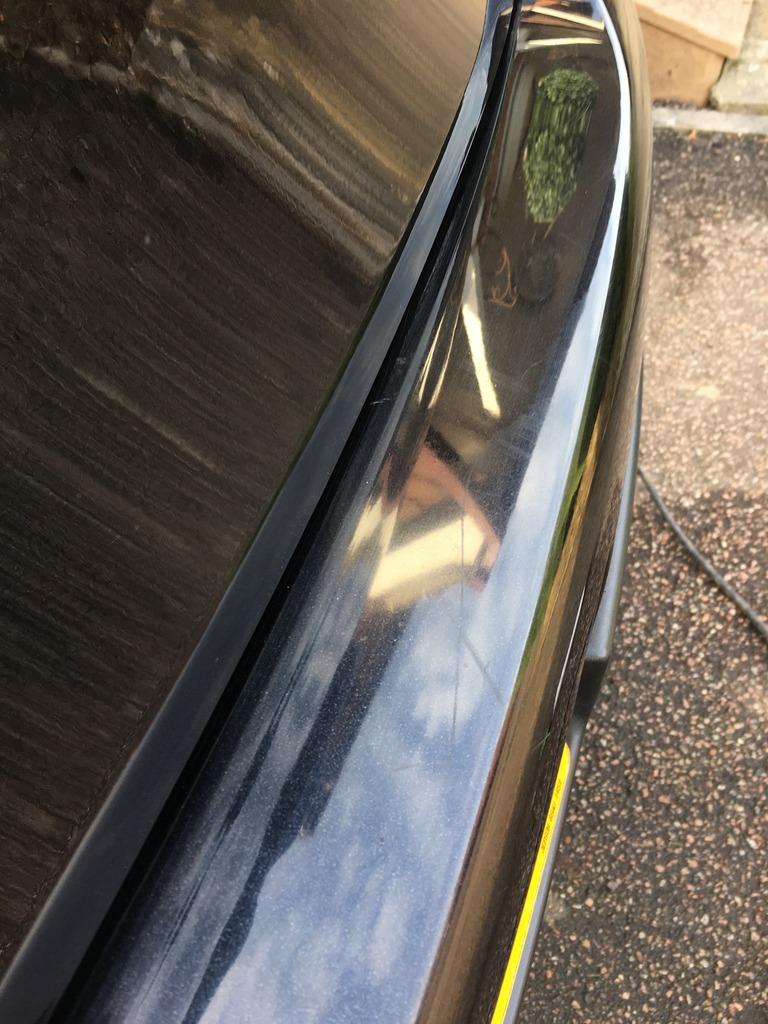

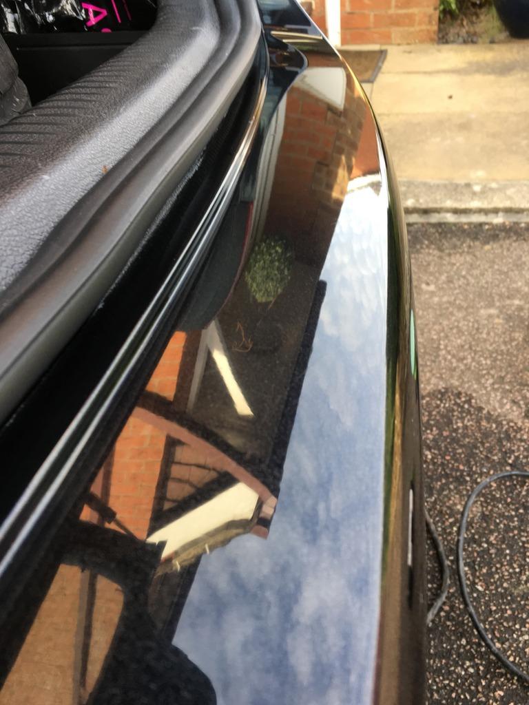

The usual marks ontop of the rear bumper:
Much better:

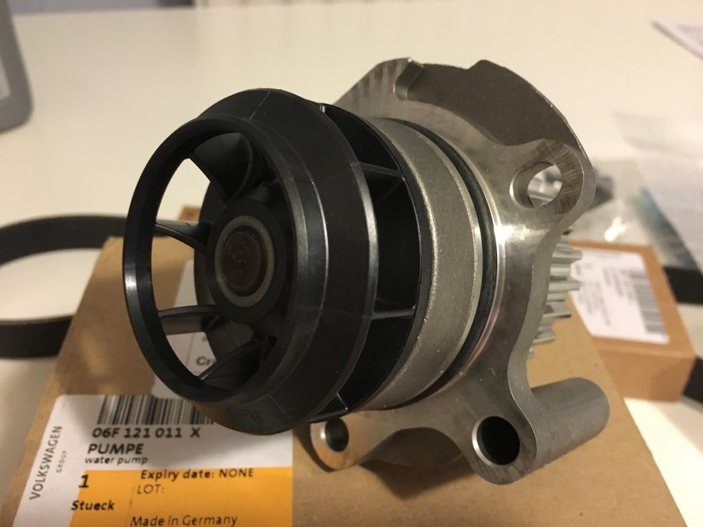

So picked a few bits up from TPS this week, and booked car in with James at VDS Performance in Redhill to get them fitted.
Camber kit, water pump, aux belt, coolant, cam chain, cam chain tensioner, rocker cover and chain cover gaskets:
(At time had collect the oil pump tensioner instead of chain, when back next day to sort).
Looking forward to getting these all fitted, happy knowing all be 100% then.
