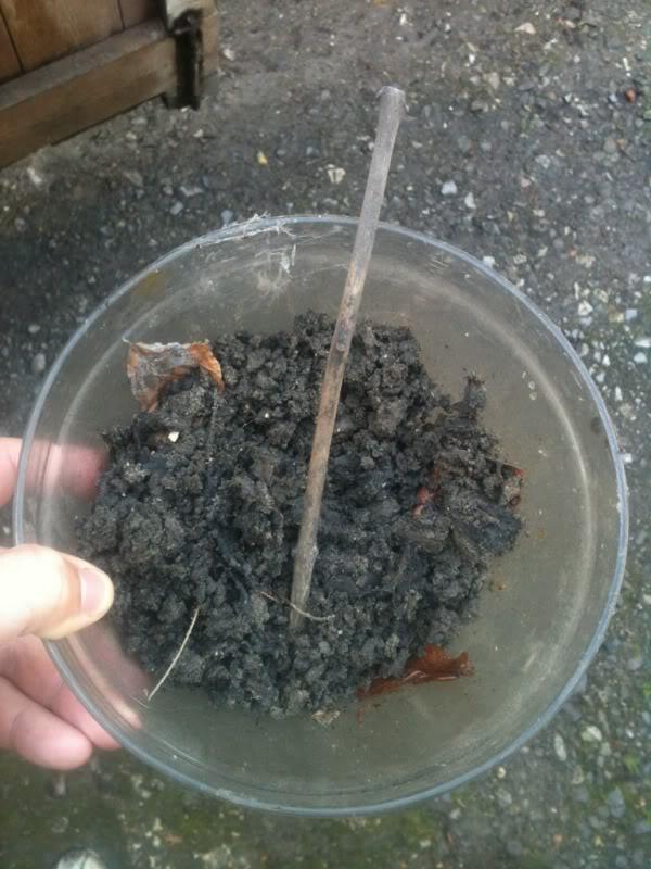

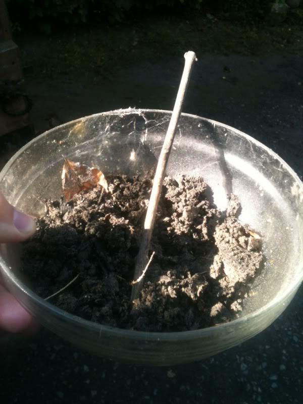

Pics of the c*ap that came behind just the passengers front liner...
Diesel Daily Hack.

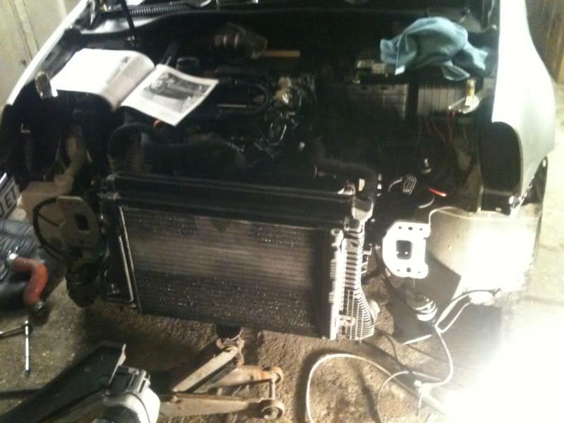

All apart... what have I done!?

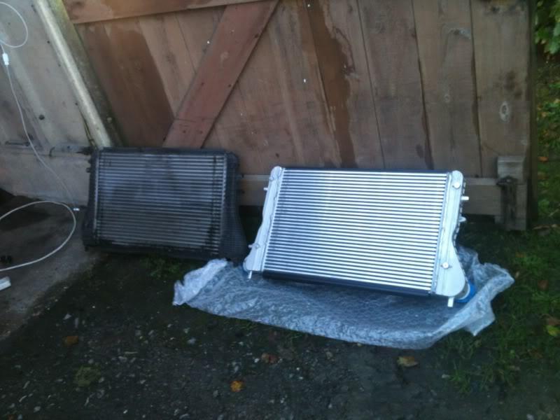

Difference in coolers...
